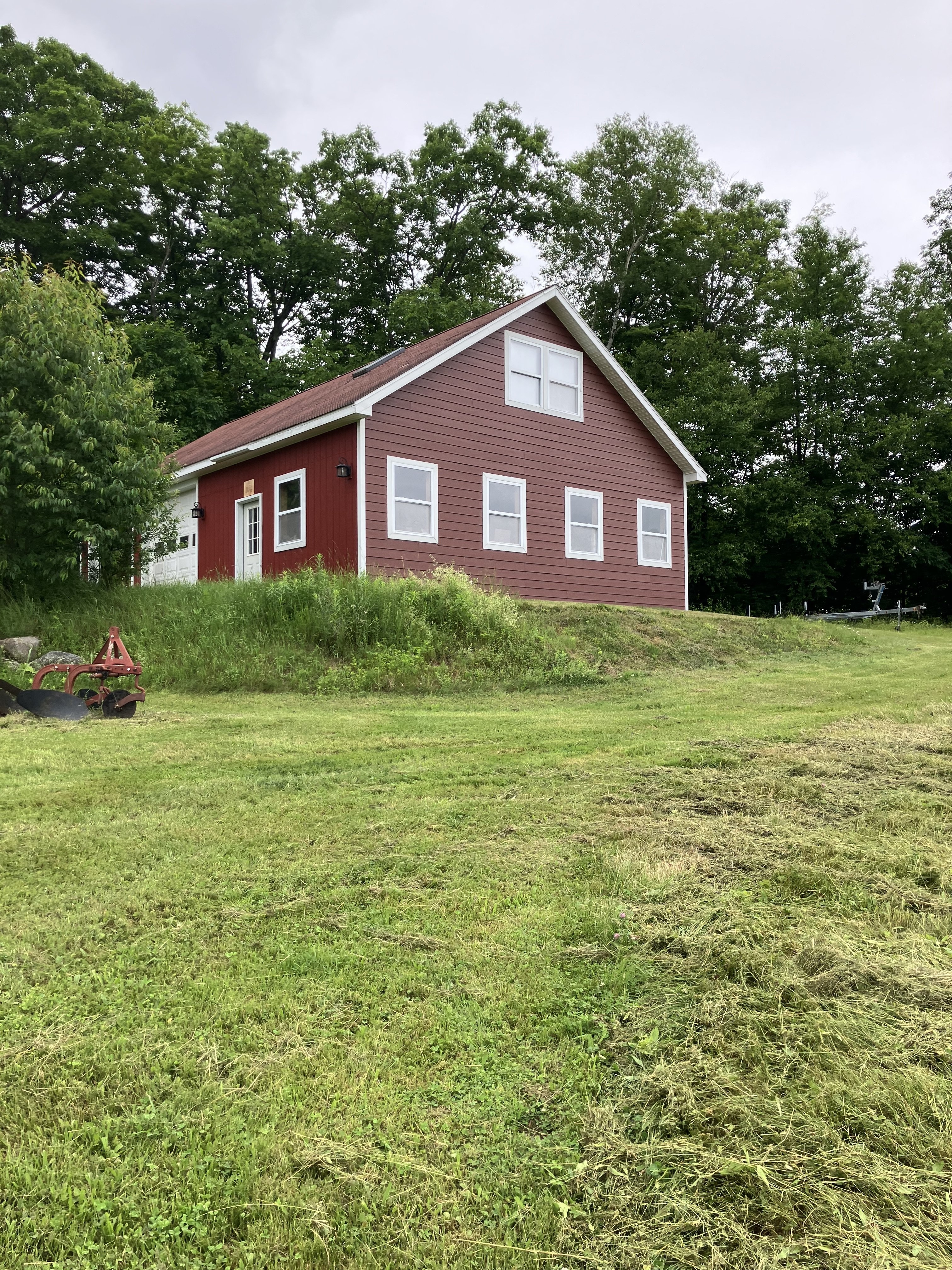

/ Hardie Board Siding? #25
I did a large house with both hardiboard lap siding and the 4x10 panels. All were pre-painted, which I think is the better way to go. The surface needs to be flat. Regular building wrap is ok to use for the lap siding, but for the sheets, self draining building wrap must be used. And that is expensive stuff.
I installed it with a siding nailer. The nails are skinnier than roofing nails, and they don’t damage the siding as much. I used strips of aluminum behind any butt joints. Cut edges need to be painted before installation, and hardi has a kit with applicator that makes it quick and easy. I used 5/4” pvc trim for all trim. It’s much easier to use and nail than the hardi trim. I used the hardi trim boards only for the board and batten sections over the 4x10 panels My trim nailer did not like driving nails through the batten strips.
I used the leftover material I had to do one wall of this cabin:
Unfortunately, I don’t have any pics of the house we did.
Well I found the house pics on my old android phone , but can’t share them with my new I phone.
