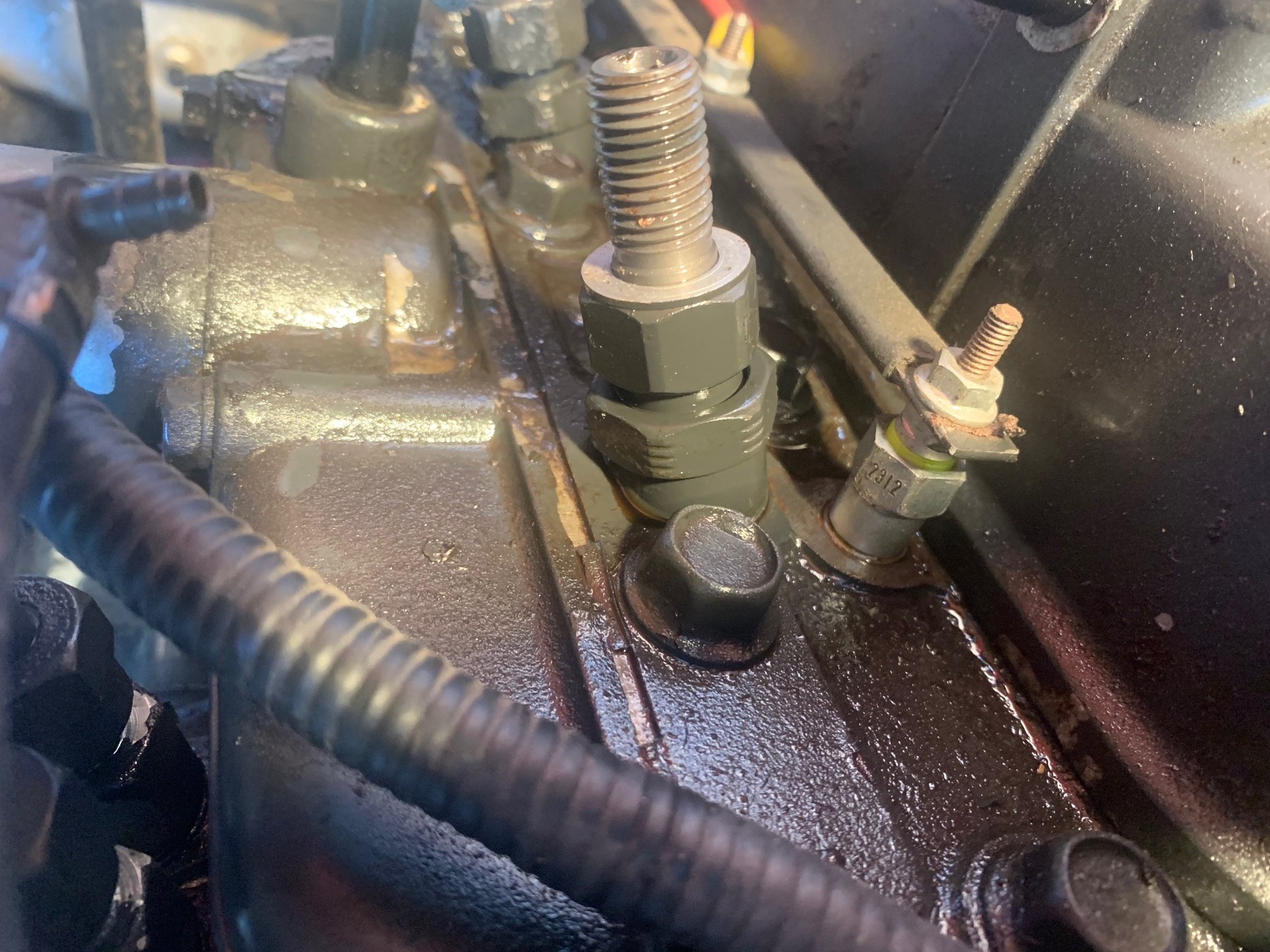

trying to remove injectors today and cannot get them out. Instructions say hold injector body while turning jam nut. I have tried this and the nut will not turn. I have applied penetration oil and still no luck. Have applied what I believe is borderline excessive force and just don't want to damage something by getting to strong armed.
any suggestions?
/ Hard starting 2400H - lift pump failing? #48
I am not sure but it looks as if the whole thing will unscrew as a unit. I don’t see that nut jamming anything.
#49
K5
You are correct the whole assembly unscrews. Either I misread instructions or Korean to English translation was misleading.
