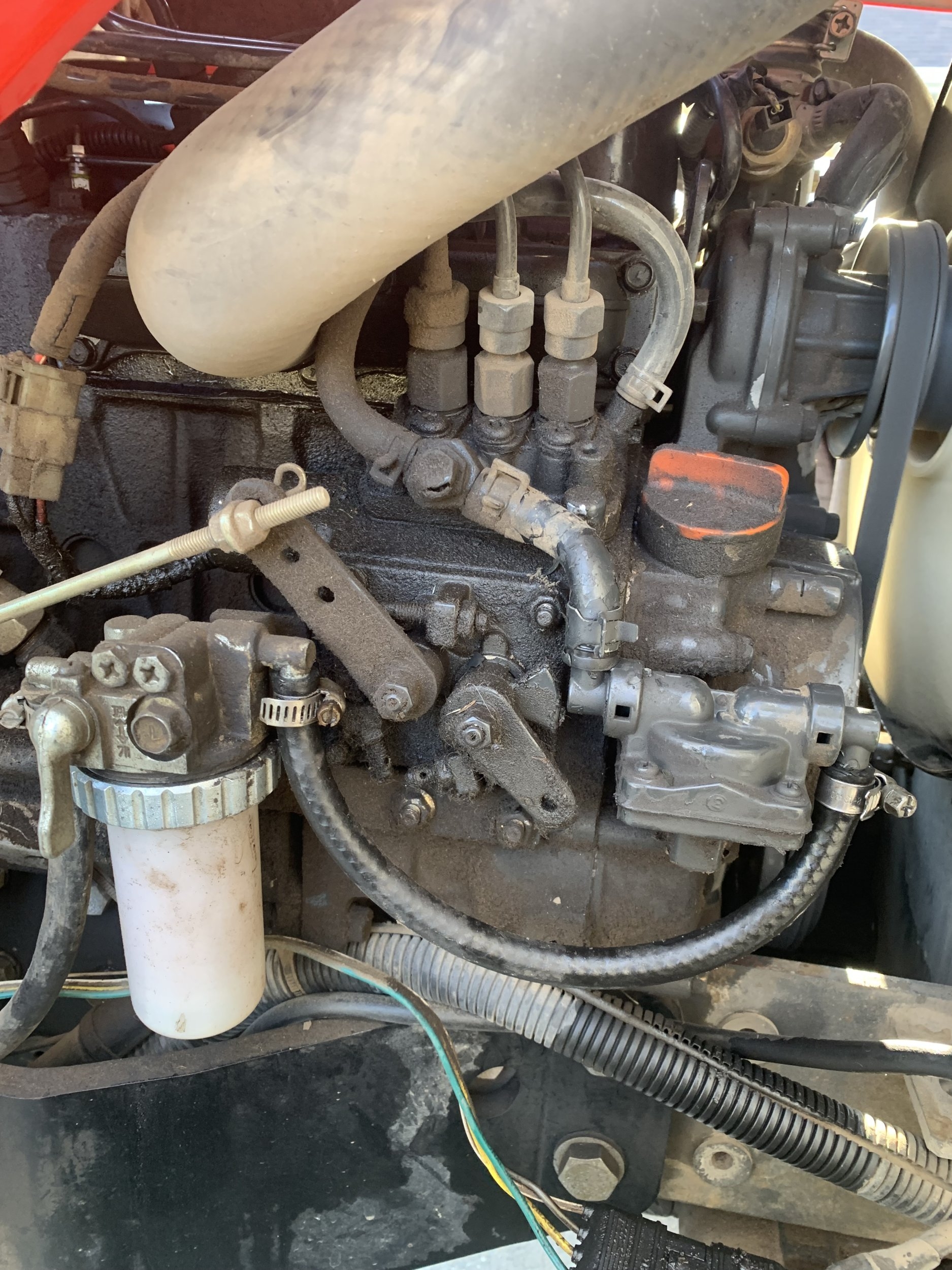

My next step would be to remove the stop solenoid and see if that makes a difference. I doubt it will but I would try just to eliminate it. I see three wires going to it in your picture. So it has the pull and hold circuit. Maybe it is not pulling all the way back at first?
I suspect the friction nut needs adjusting as well.

I removed the stop solenoid assembly from the injector pump and it is pull to start spring out to stop. Since the hole in the IP is approx 1 1/8” diameter I made a cover to replace the solenoid. Made no difference in how it starts so another item eliminated.
I did tighten friction assembly on throttle linkage so it now stays where you set it.

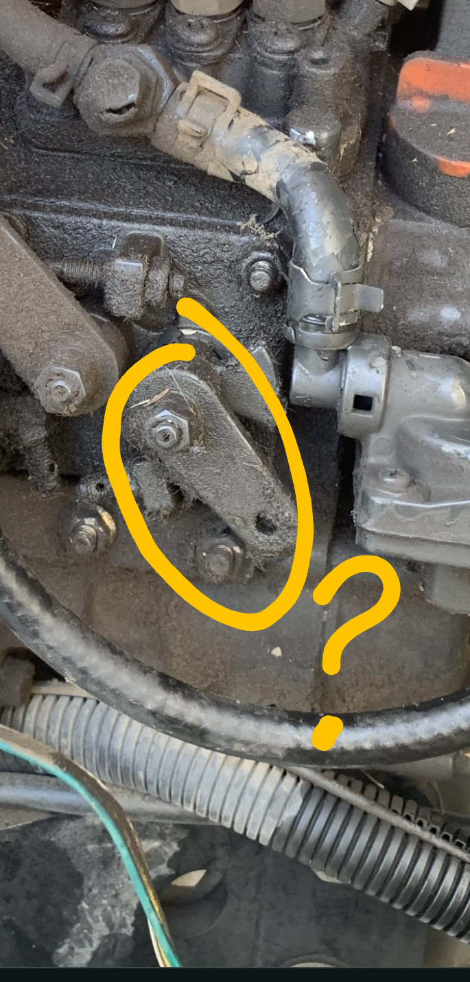

Is the rod on the upper left fuel cut off or throttle? What is the lever circled in yellow? Where is your throttle connected?

Lever circled is manual fuel shut off. When I removed the stop solenoid I used a mirror to look through the mounting hole to observe the fuel shut off mechanism movement while operating that manual lever. Everything looked clean and moved freely from what I could see.
Upper left with linkage attached is throttle.

The circled lever is where the solenoid connects?

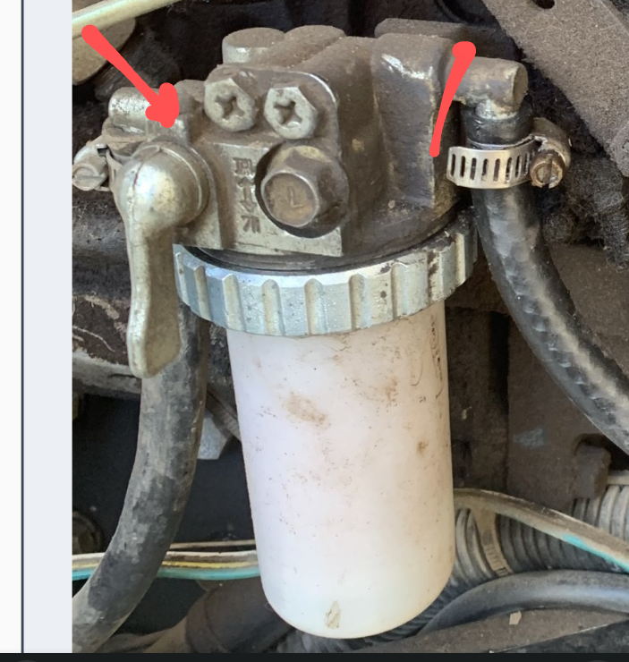

Have you checked to see if the banjo bolt/bleeder has a fine mesh screen or a screen below the bolt? And the vertical fitting to the right if it originates from the same line?
I would highly recommend bypassing/replacing your filter with a clear automotive filter

The stop solenoid bolts directly to the end of the IP it is hidden behind the filter in the pictures. You can see the electrical connector above the filter next to intake hose.
No I did not remove the banjo bolt to check for screen.

Yeah, IMO that filter assembly is suspect at best. I replaced mine early on for a clear horizontal auto fuel filter. Doesn't look snazzy but offers a clear visual indicator for water or lack of fuel.

Wondering if the o-ring in the shutoff valve on the filter housing could be letting air in and cause of weird issues.
