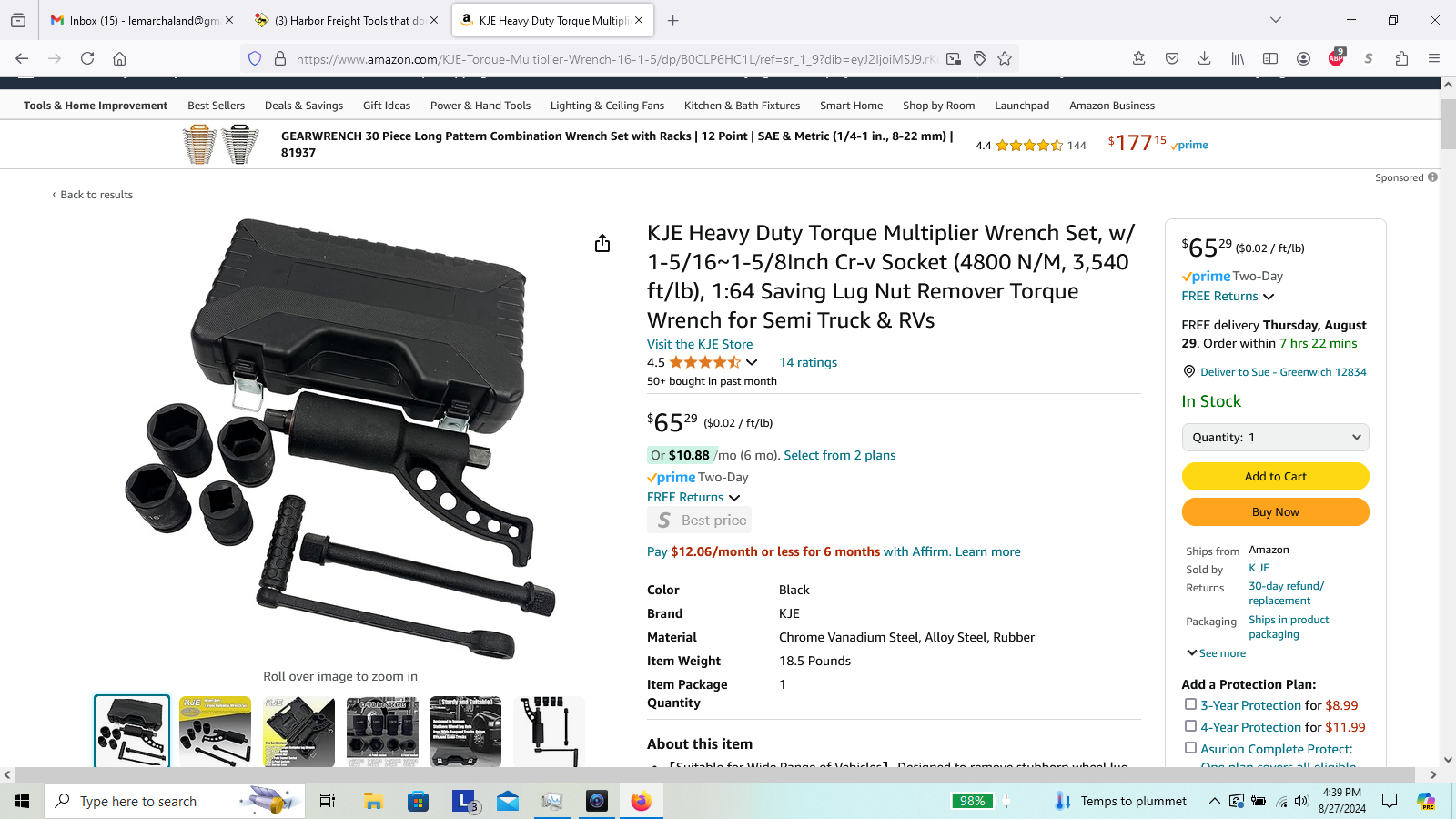

/ Harbor Freight Tools that don't suck #15,853
The new Bauer corded shows to have 1050 pounds of breaking force,
the high torque Bauer 20Volt only shows 1000 pounds,
the Hercules Hi Torque 20 Volt list 1200 pounds,
but this one 1/2 in. Ultra Torque Impact Wrench delivers up to 1500 pounds,
and this 3/4 in. Ultra Torque Impact Wrench delivers up to 1650 ft.
The torque multiplier tools also work very well, I have broken several bolts with one like this;

/ Harbor Freight Tools that don't suck #15,856
May have to try that Torque multiplier.
