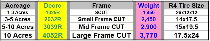

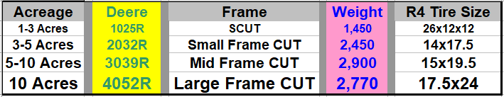

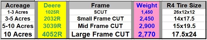

I hope you won't mind if another newbie who has been researching a long time and learned a lot from TBN, throws in her 2 cents. (Since the guide is directed at newbies, perhaps newbie input has some value.)
I think the "acreage" tables aren't much help. If you have 10 flatish acres that you only want to mow the yard, tend a garden, and move some mulch and soil around for landscaping, you probably don't need a 3777 pound large-frame cut! I believe that's right. Surely a lot depends on *how much* of your acreage you need to maintain and what you want to do. Plus what the terrain is like. The terrain kind of throws a monkey wrench into any neat categories IMO.
Perhaps it would be useful to create some general categories of typical newbie residential/rural property owner use (industrial/ag users know what they need, right?) I put in some Mahindra tractors because it's the only line I'm familiar with:
1. Light use: yard mowing, gardening, minimal driveway maintenance, occasional very light snow removal on smaller tracts. IOW, "replace my wheelbarrow with this tractor." (emax 20 - max 24, depending on how much weight you want to lift, push and whether you can get the job done with 48" wide attachments.)
2. Medium use: yard mowing but also mowing taller grass or larger tracts of grass, maintaining larger gardens and some wooded areas, regular driveway maintenance, light snow removal. (emax 22 - max 26, depending on how much weight you want to lift or push and how much driveway/property you need to maintain, plus whether you want wider than 48" attachments)
3. Heavy use: have another mower for the yard but need to maintain pastures, brushy areas, wooded areas, large gardens, longer driveways, medium snow removal, and generally tackle larger, heavier projects (max 26 - 1526, again depending....)
4. Super-duty use: Like #3 but more of everything (1500 - 3500 series)
Pretend your property is flat and level and pick a tractor based on the tasks you want to do. If you have hills you need to work on that your riding mower can handle, go up one size. If you have hills your riding mower is a little sketchy on, go up two sizes. If you have steep hills that give you major pucker factor on a riding mower, you probably need a 1500 series minimum. If you have rough or rocky terrain, go up one size even if your terrain is mostly flat.
General rule: If you're undecided between two sizes, choose the larger one.
Oh well, that was fun! :)
You are recommending Mahindra models, because you are familiar with them. Bare tractor weight fits your categories.
Bare tractor weight is a tractor specification easily found in sales brochures and web sites, readily comparable across tractor brands and tractor models.
