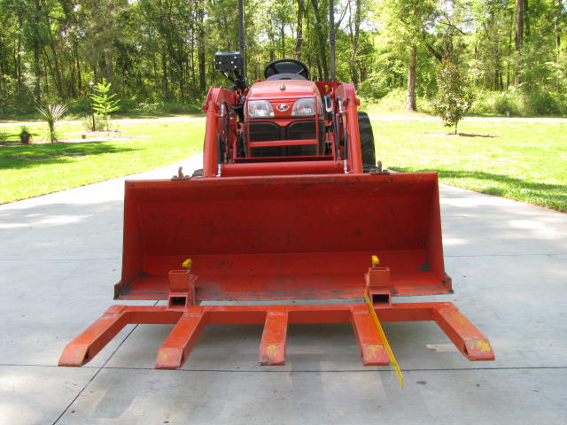

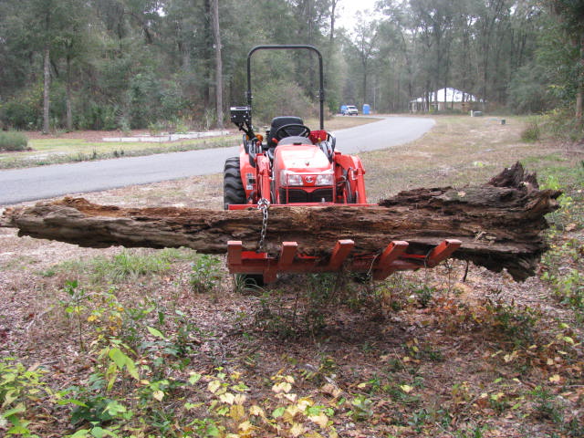

What I have been let down on with my Kubota is the FEL capability. I have always wanted more lift.
Problem is you take away the big cab and look at the tractor and realize this is a two ton tractor, not three or four ton, to begin with.
To answer your one question as specifically as I can, I can't use my L5740 easily in the woods, which I have lots of, and I can't use it in row crop work following my
Super A, too wide. Otherwise? Yes please Santa I'll take an M5 for Christmas. I don't bale hay or do "real farming" so a lot more horsepower accomplishes nothing for me
unless it brings stronger hydraulics. I like to pick up heavy trees with my HD grapple and the L just doesn't cut it for me. I had never bought a tractor with a FEL
before so this was a learning experience for me.
I thought I was buying big enough because I bought the highest hp version of the L, what I meant to say earlier is I should have bought a heavier, larger frame tractor
based on the last five years experience with how I use them.

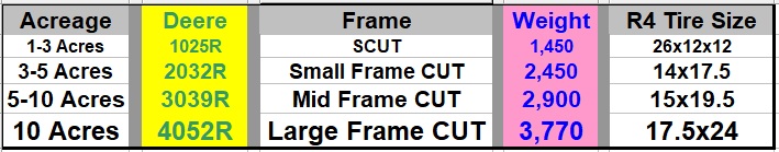

Suggested revisions to Working Draft 6 are WELCOME.
WORKING DRAFT (6)​

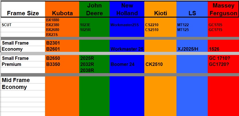

The most efficient way to shop for tractors is to list your tasks first, then determine bare tractor weight needed to SAFELY accomplish your tasks. Bare tractor weight is a tractor specification easily found in sales brochures and web sites, readily comparable across tractor brands and tractor models.
For most tractor tasks greater chassis weight is more important than tractor horsepower. For novice tractor shoppers the fundamental importance of tractor WEIGHT is difficult to comprehend. In subcompact and compact tractor categories it requires a 50% increase in bare tractor weight before you notice a significant tractor capability increase. It takes a 100% increase in bare tractor weight to elicit MY-OH-MY!
Shop your weight range within tractor brands. Budget will eliminate some choices. Collect a dealer brochure for each tractor model in your weight range. I spreadsheet tractor and implement specs, often a revealing exercise. I have a column for cost per pound.
Tractors under 3,000 pounds bare weight are offered in one configuration. Most, such as the high volume Kubota Standard L Series, are sparely equipped to hit competitive price points. Others, such as the Yanmar YT235 and Kubota B2650/B3350 series, include enhanced productivity and comfort components.
Most tractors under 3,000 pounds bare weight operate in residential applications on one to five flat acres. These "residential tractors" fit in a typical garage.
Heavier tractors are built on larger frames with larger wheels/tires. Heavier tractors with large diameter tires have more tractive power pulling ground contact implements, pushing a loader bucket into dirt and pushing snow. Larger wheels and tires mean more ground clearance, enabling a heavier tractor to bridge holes, ruts and downed tree limbs with less bucking, yielding a less disturbing passage over rough ground.
Safe hillside operation demands more tractor weight than level land operation. Tractors optimized for hill work have liquid installed in the rear tires rather than air. "Loaded" tires are filled 75% to capacity with liquid, which lowers the tractor's center-of-gravity, making a tractor more stable and increasing rollover resistance. "Loading" two compact tractor rear tires will increase weight 300 pounds to 800 pounds over weight of same two tires inflated with air.
Heavier tractors have adjustable rear wheel spreads; wide rear wheel spreads reduce tractor lateral instability.
Safe hillside operation requires four wheel drive (4-WD). Tractors have brakes only on the rear wheels. When going down hill, tractor weight distribution shifts forward, decreasing rear tire grip. With 4-WD engaged tractor feigns four wheel braking. Without 4-WD engaged, on a steep slope, an uncontrolled descent may occur.
Tractors over 3,000 pounds bare weight are generally offered in a utilitarian configuration and a deluxe configuration, on a common chassis. Deluxe kit enhances productivity and operating comfort ~~~ but you have to pay. Many tractors over 3,000 pounds bare weight are too tall to fit in a typical garage, even with ROPS folded.
Selling a used tractor is easy. Selling light implements in order to buy heavier, wider, implements for a heavier tractor you eat more depreciation on the implements than on the tractor. Passing time with multiple implement browsers is a pain. ((Ask me how I know.))
For most new to tractors a quality dealer, reasonably close, available for coaching, is important. Almost every new tractor is delivered with a glitch or two that requires correction. My Kubota dealer is six miles away. I feel my local dealer continues to add value to my equipment. Dealer proximity is less important to others, well experienced with tractors, who perform their own maintenance.
BUY ENOUGH TRACTOR.​

It was not a B3350SU. It was a B3300SUHSDP. Tires inflated with air. I run over irrigated lawns in an upscale, rural residential community every operating day.

Suggested revisions to Working Draft 7 are WELCOME.
WORKING DRAFT (7)​
The most efficient way to shop for tractors is to list your tasks first, then determine bare tractor weight needed to safely accomplish your tasks. Bare tractor weight is a tractor specification easily found in sales brochures and web sites, readily comparable across tractor brands and tractor models.
The fundamental importance of TRACTOR WEIGHT eludes many tractor shoppers. Heavier tractor chassis weight is more important for most tractor operations than increased tractor horsepower. Within subcompact and compact tractor categories, bare tractor weight must increase 50% before you notice a significant tractor capability increase. It takes a 100% increase in bare tractor weight to elicit MY-OH-MY!
Most tractors under 3,000 pounds bare weight operate in residential or hobby farm applications on one to five flat acres. "Residential tractors" will enter a typical residential garage with 84" door height.
Selling a used tractor is easy. Selling light implements in order to buy heavier, wider implements for a heavier tractor you eat more depreciation on implements than on the tractor. Dealing with multiple implement browsers is a pain. ((Ask me how I know.))
Heavier tractors are built on larger frames with larger wheels/tires. Heavier tractors with large diameter tires have more tractive power pulling ground contact implements, pushing a loader bucket into dirt and pushing snow. Larger wheels and tires increase ground clearance, enabling a heavier tractor to bridge holes, ruts and downed tree limbs with less bucking and disturbance when passing over rough pasture and woodland.
Safe hillside operation demands more tractor weight than level land operation. Tractors optimized for hill work have liquid installed in the rear tires rather than air. "Loaded" tires are filled 50% to 75% with liquid, which lowers the tractor's center-of-gravity, increasing rollover resistance. "Loading" two compact tractor rear tires will increase tractor weight 300 pounds to 800 pounds over weight of identical two tires inflated with air.
Tractors over 3,000 pounds bare weight are generally offered in a utilitarian configuration and a deluxe configuration. Deluxe kit enhances productivity and operating comfort ~~~ but you must pay. Most tractors over 3,000 pounds bare weight are too tall to fit through an 84" height garage door, even with ROPS folded.
A quality dealer, reasonably close, available for coaching, is important for tractor neophytes. Almost every new tractor is delivered with a glitch or two that requires correction. My Kubota dealer is six miles away. I feel my local dealer continues to add value to my equipment. Dealer proximity is less important to those experienced with tractors and qualified to perform their own maintenance.
BUY ENOUGH TRACTOR.
