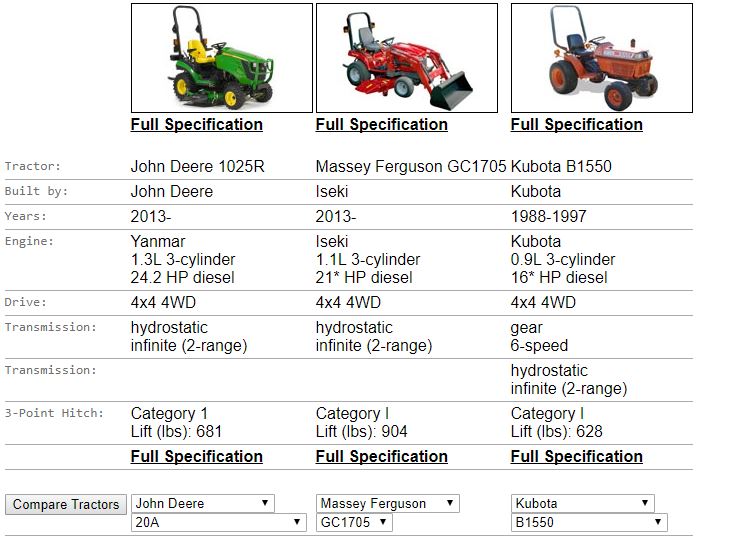

I made up something like this just goofing around the other day. Were you thinking like this? Not sure how to attach a spreadsheet.
/ GUIDE: Shopping/Sizing A Tractor (Development version) #12
Tractor Data Compare tool. Pretty cool! It doesn't have a lot of the data you have above though. Wish it did. Yours is great.
Excellent work. I like the color.
Under DIMENSIONS I suggest a calculation for tractor pounds per gross engine horsepower.
I would show width as WIDTH/R1 TIRES.
NICETIES: I would describe non-turnbuckle stabilizers as telescoping or rigid/pinned. (Just me.)
As you have data for Gear and HST it would be interesting to see drawbar HP comparisons between the two transmissions.
In factory brochures some models seem to be more efficient at converting gross horsepower to real work.
(However, as a retired sales manager and occasional marketer I am skeptical of published data which cannot be cross checked, at least with experience of TBN regular contributors.) ((I am aware of the Nebraska state tractor tests but seldom visit there.))
