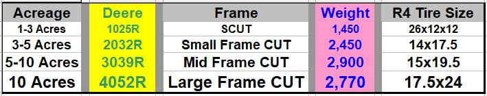

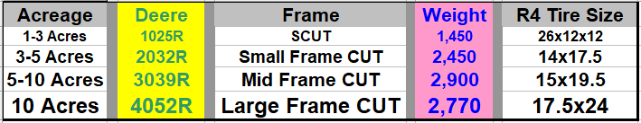

I see that my formatting got all screwed up, so here is another pass. I have no problem with using weight as a primary differentiator, but why not explain that as weight increases, generally so does ground clearance, width (for stability), and rear tire diameter (for traction)?
Anyway, here is what I think could be a quick visual reference. Cheers!

/ GUIDE: Shopping/Sizing A Tractor (Development version) #48

AIRBISCUIT: Graphic in Post #47 is excellent.
/ GUIDE: Shopping/Sizing A Tractor (Development version) #51
AIRBISCUIT: Post #47 is excellent.
That is just meant to be a visual along with your narrative. The categories are not absolutes, but a kind of dead reckoning. There is obviously "smudge" between categories. A person' budget can be a factor on what they buy for their "first" tractor. That said, I think this will help them look at other factors than just hp and cost,

Then go to this:

/ GUIDE: Shopping/Sizing A Tractor (Development version) #54
Very good visual and textual start for a newbie; I think tire sizes are flipped though.
That's how they were listed on the John Deere Site.
