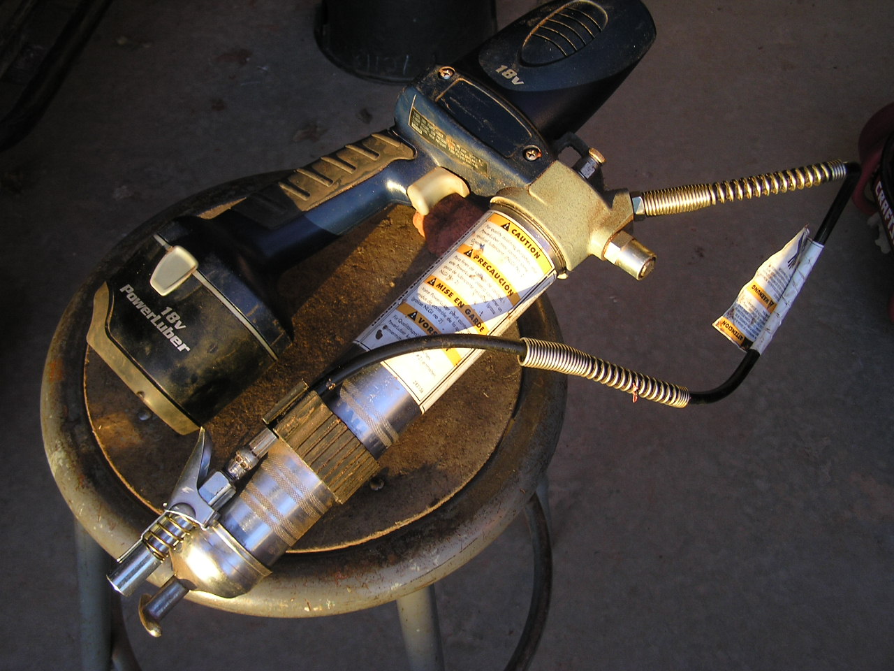

FYI, here is what I do with my grease gun. I had already posted this info else where. It has nothing to do with LockNLube adapter and the electric battery grease guns. I had an electric/ battery grease gun and gave it away because I prefer the air one. but it is what I did to make greasing anything easier. Maybe this will help other members and or this is a common thing that everybody does. I do not know. I have an original pistol grip grease gun from the 60"s which I used all of the time. Maybe about 15 years ago I added and extension hose, 3 of them in fact to the grease gun. Sure makes it easier. No need to worry about getting the grease gun into tight places. One hand on the hose and one hand on the grease gun. I thought about putting another length of hose on but this works good. I have had to replace the end hose a couple of times because it takes most of the abuse. Five or six years ago I upgraded to a air driven grease gun, a low cost from Lowes. It still works. It surprises me. Like I said maybe this hose extension stuff is a common thing that everybody does. The second item is the grease adapter. I purchased this back in the 60's for my mothers Buick convertible at the time. The Buick had a split drive shaft with a carrier bearing that needed greased occasionally and this was the adapter I bought. It is an aluminum body with an hardened tip. It was designed for the carrier bearing application but it fits almost perfectly into the ball check on a zerk fitting. I use it on those tight spots where you cannot get coupler on, AKA u-joints, axle shafts etc. Hold it straight on and pull the trigger. I am not saying you will not pop out a ball check once in a while but it sure saves a lot of aggravation. Somebody may make this style of adapter now, I do not know. I have other grease adapters but this one with the hardened tip works great as noted. Also I was never in love with those lever arm grease guns. If you want a mechanical grease gun a pistol grip to me is the way to go. Hopefully somebody can benefit from my post. Later- 20150123_182726.jpg20150123_182819.jpg20150123_182945.jpg20150123_183458.jpg

I just ordered an 18v DeWalt grease gun, $157 with case. You guys better not be foolin'!
This Lucas drill powered grease gun on Amazon looks like its about half the size of the DeWalt, and $100 less. But the reviews on the DeWalt are generally 4 or 5 stars. DeWalt has a 42 inch hose. And a case to leak into.

If it has the 42" hose you will really like it. That in it's self will make it a lot easier to grease things. Another thing about the grease that you use. I have been using John Deere grease probably for over 25 years. I buy it in the 10 cartridge package, maybe 2 to 3 cases a year at the most. It has never separated. That's it. Later
