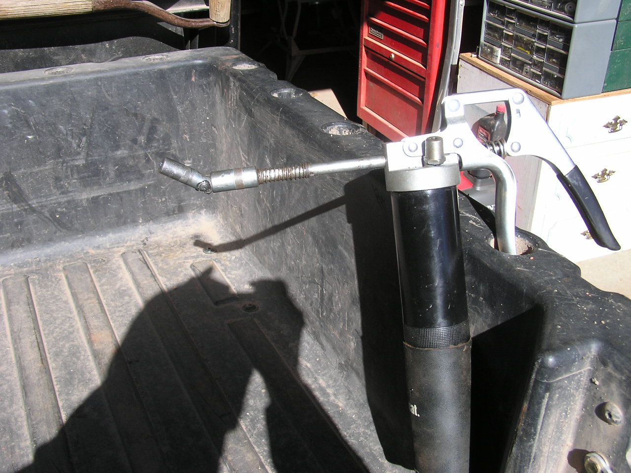

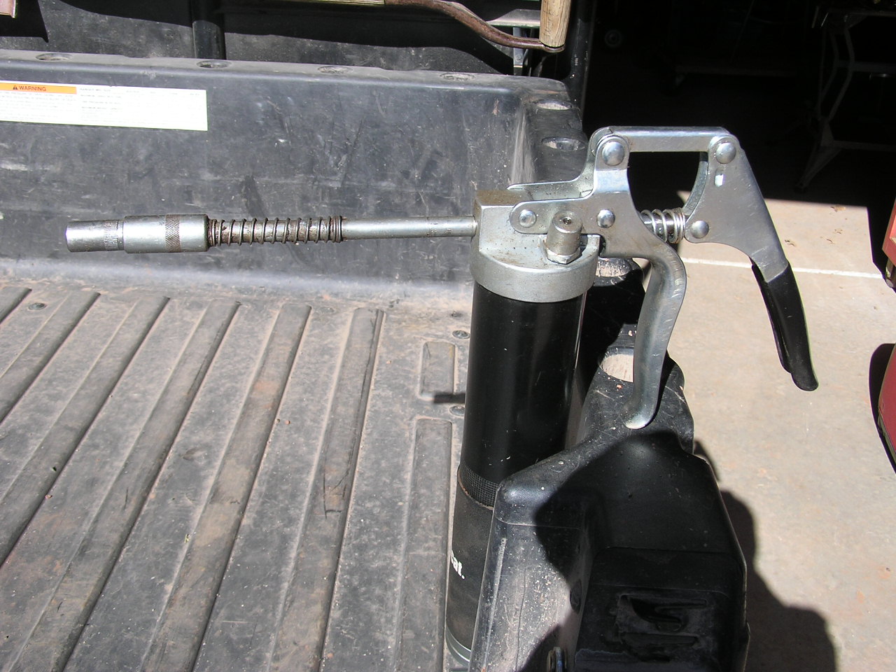

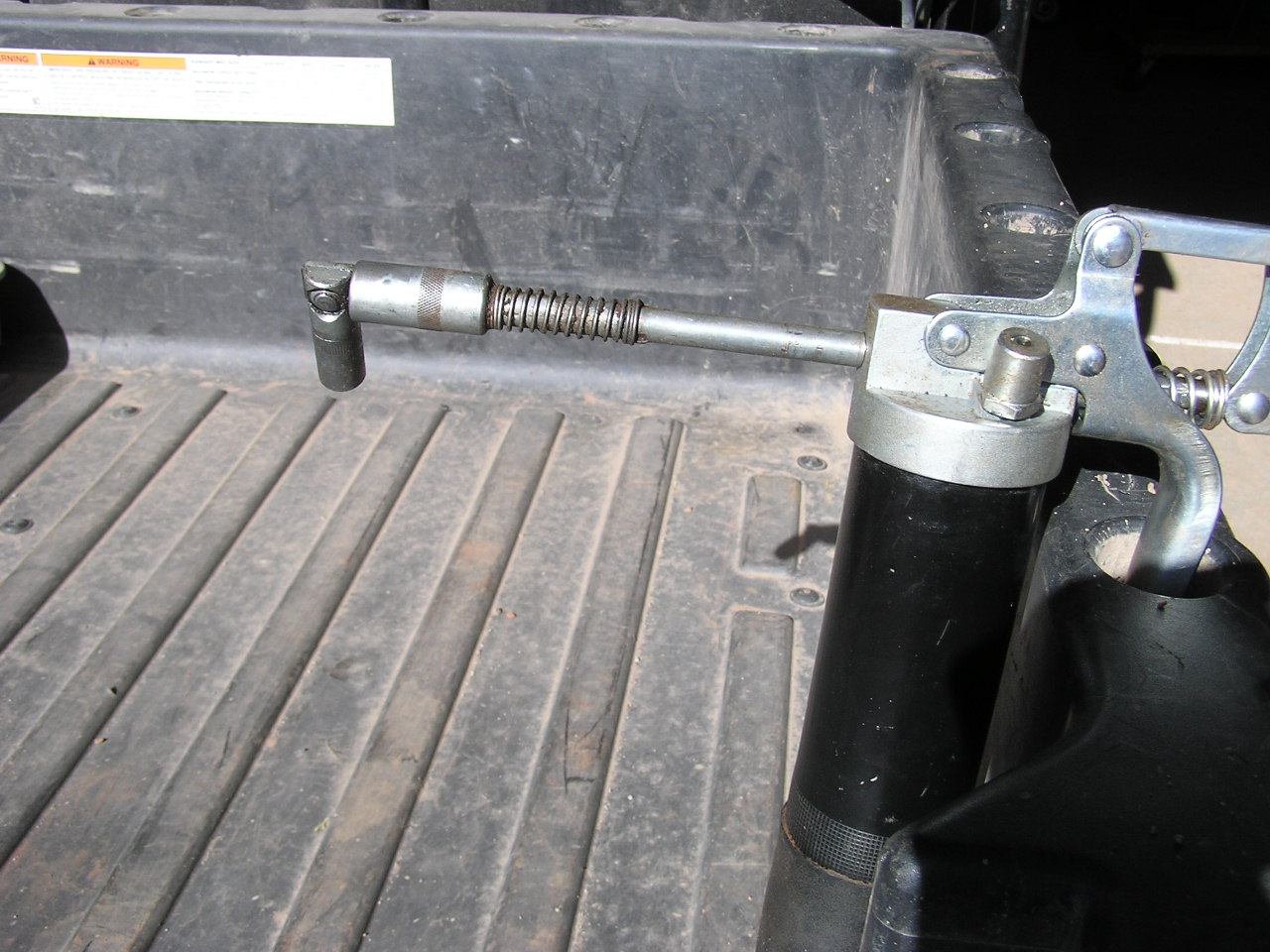

Oh, one other thing. When I was trying to grease me truck yesterday, it came to me that there needs to be an L shaped grease gun end. I cannot get those long metal tips on so many fittings very easy. Do they make such a thing?
I have this style on my pistol grip gun.
