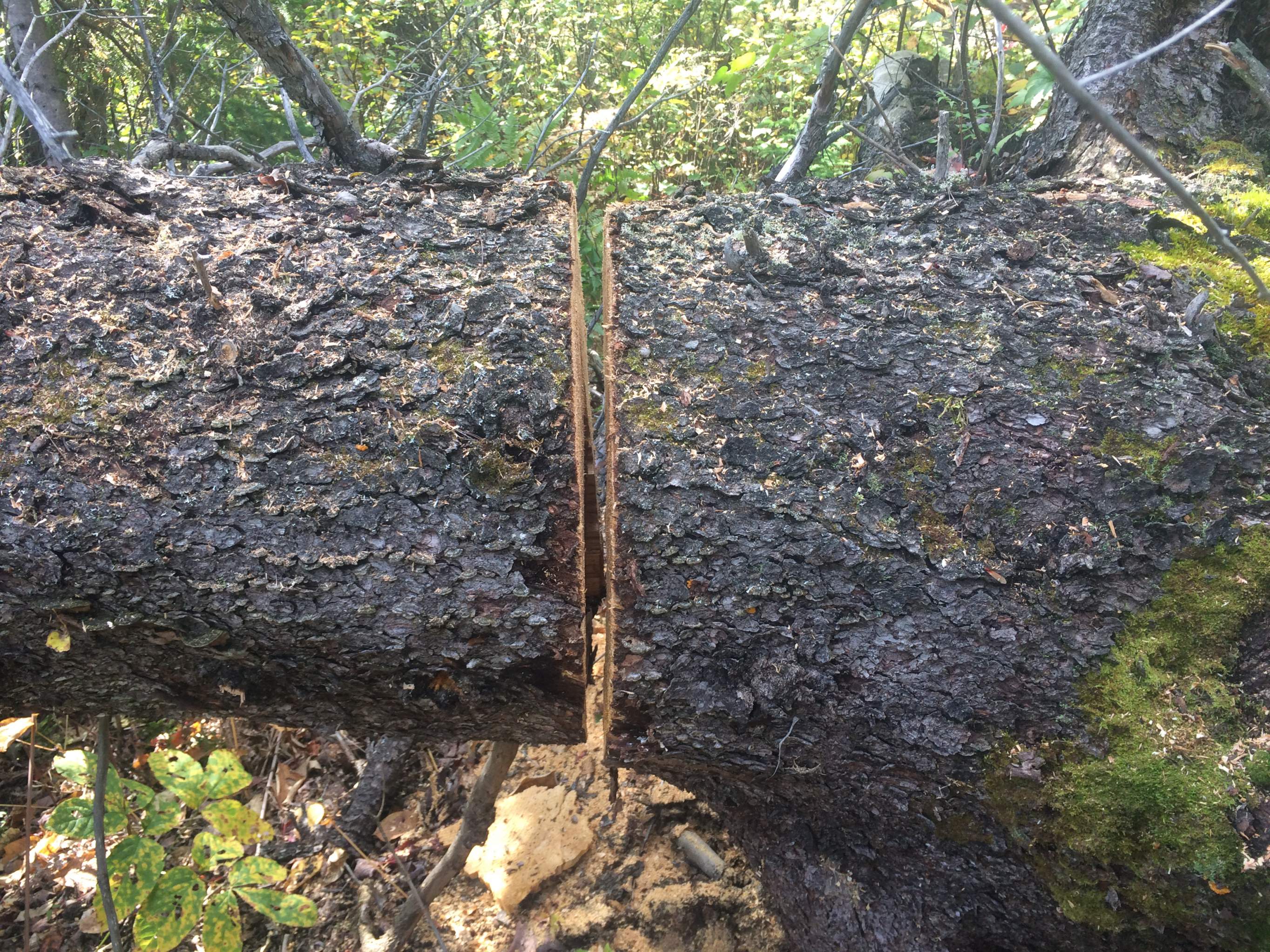

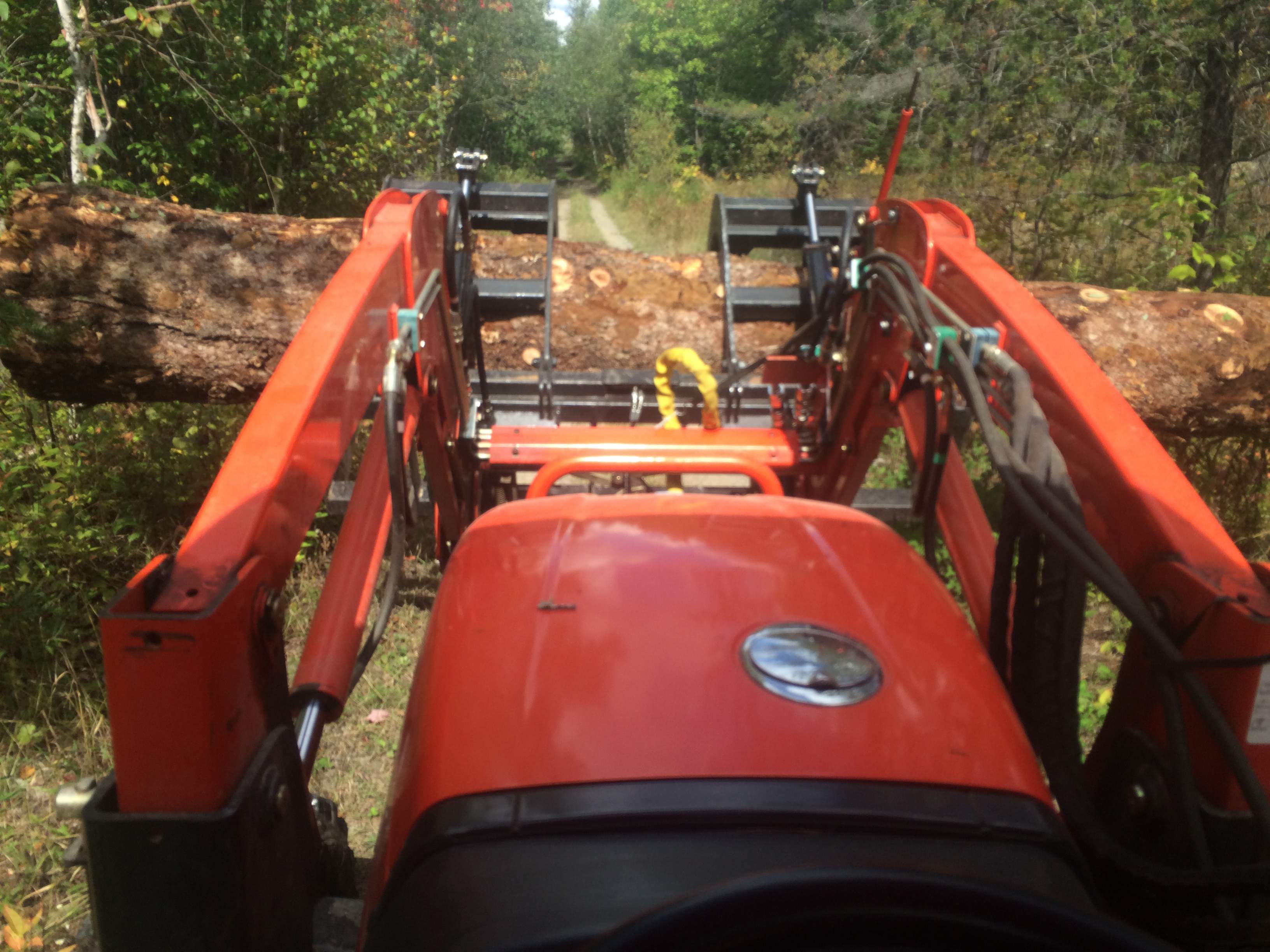

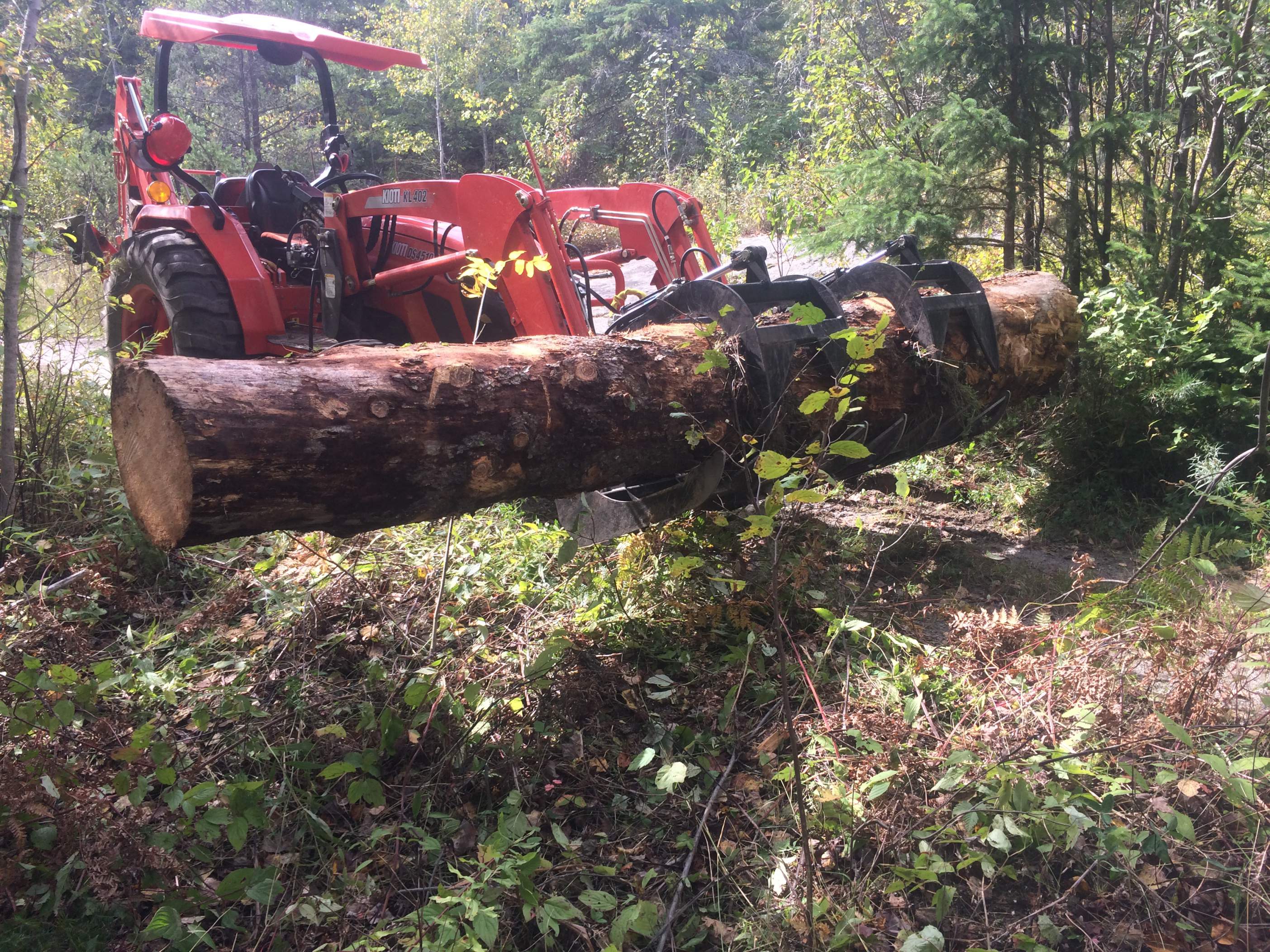

From the bush to the mill....white spruce dead-fall.....grapples are great!!
13 foot log going down an 8 foot wide bush road makes things interesting:
....and finally on the mill:

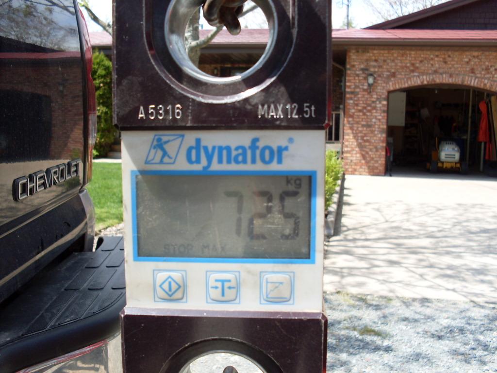

Neat scale. I am guessing that is a half ton. Have you ever weighed it?
My 3/4 ton GMC weighs 7300 pounds, front axle 4100, rear axle 3200.
seems kinda light for the back half of the truck.
By picking up the backend he is transferring some of the weight to the front axle.
I think it is somewhere around 4500lbs. 05 Silverado Z71. Roger is correct, I would not be able to lift the front end at all.
Steve
I'll have to try it with my truck and see how it compares to the weight on the axle.
I had the crane scale on and remembered these posts from last year. My truck has been weighed at the Co-op, front axle, 4100 pounds. Rear axle 3200 pounds.
2344 pounds lifting from the receiver hitch, a lot less than I expected. Bullitt is right. :thumbsup:
