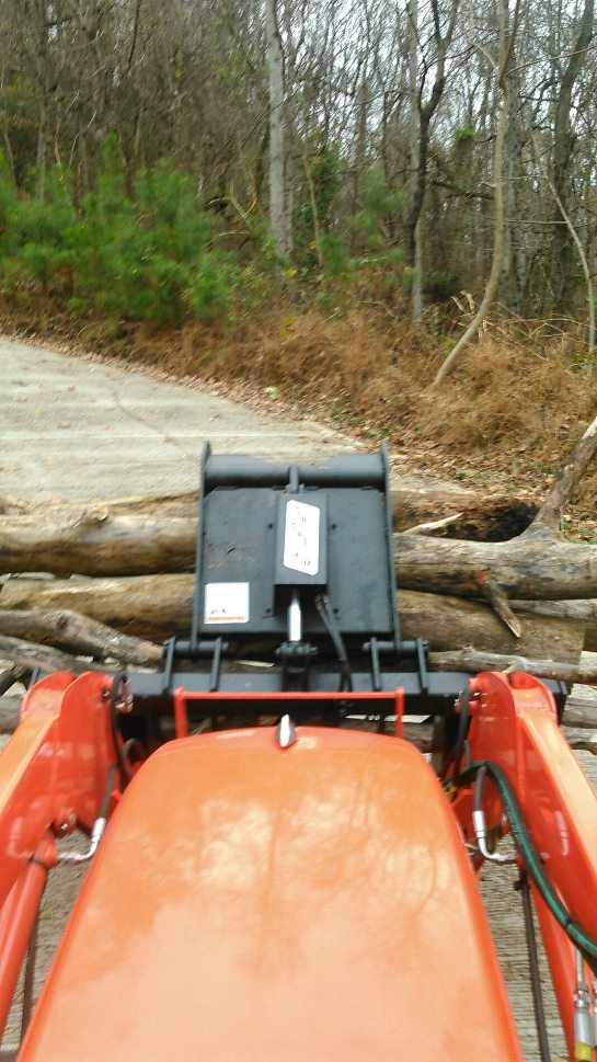

The second one looks cool. Independent controls is awesome. Do you have multiple buttons on your joystick?
All two lid grapples are independent. The cylinders are plumbed in parallel so the lid with the least resistance to movement will move first. When it contacts something the other lid will move until it contacts something, then same hydraulic pressure is applied to both cylinders.
For the picture both lids were up, I opened the pressure release valve for the aux hydraulic connectors and pushed on the lid to start it moving, gravity took over and it closed.
