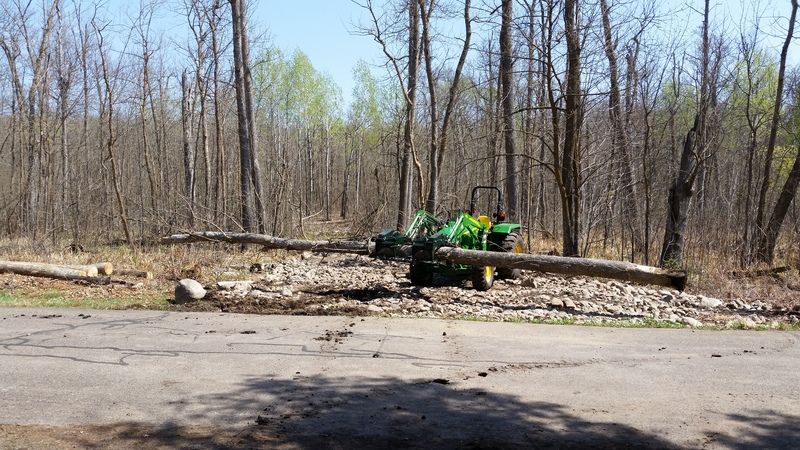

As promised...first grapple picture. I had to make a few trips back and forth to the place that made my hydraulic lines to get the right fittings so I was running out of daylight by the time I got to try it out.

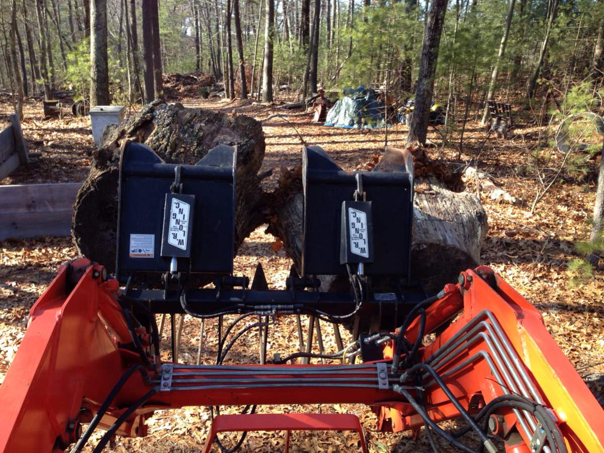

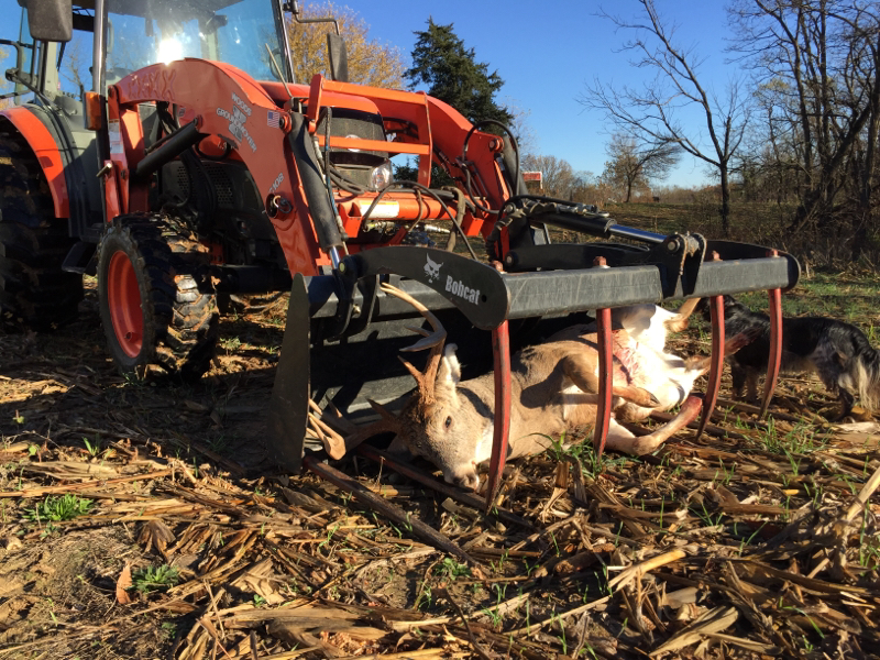

Got to try out my new grapple on Sunday...thanks to everyone who who suggested I get this Attachment.
/ Grappling fun - A Picture Thread.... #471

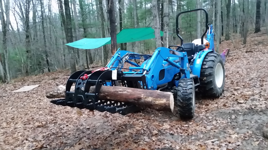

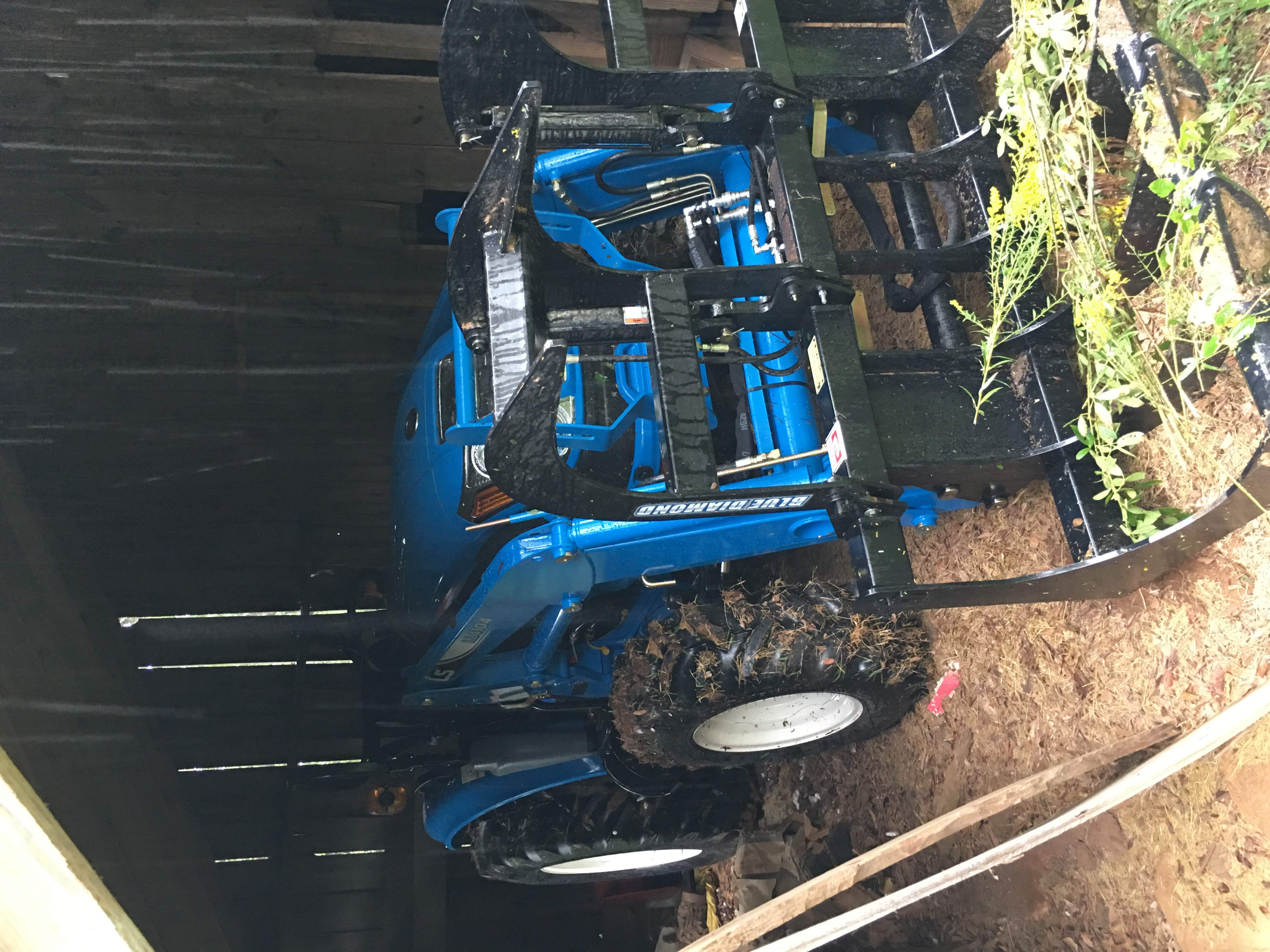

Don't really have any working pics of my grapple but here is my Blue Diamond 66" Dual lid root grapple on my LS XR 4145H ;) <img src="http://www.tractorbynet.com/forums/files/attachments/447919-grappling-fun-picture-thread-img_0244-jpg"/><img src="http://www.tractorbynet.com/forums/files/attachments/447920-grappling-fun-picture-thread-img_0246-jpg"/><img src="http://www.tractorbynet.com/forums/files/attachments/447921-grappling-fun-picture-thread-img_0247-jpg"/><img src="http://www.tractorbynet.com/forums/files/attachments/447922-grappling-fun-picture-thread-img_0248-jpg"/>
Looks great! What is the jaw opening on your BD Grapple?
