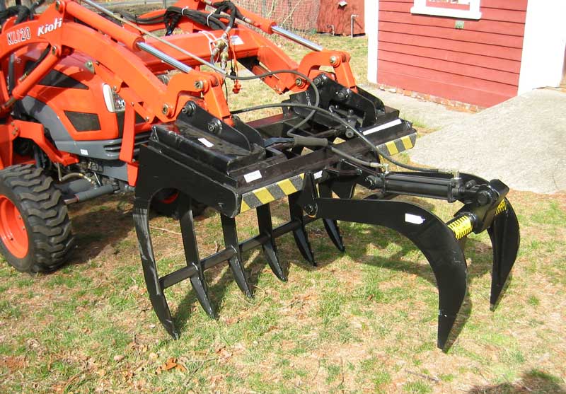

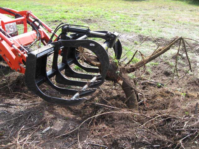

I don't disagree that the more an attacment is designed for a purpose, the better it can be for that. But bucket grapples are very useful. It also allows for material removal that you want to get rid of which would/might sift through a grapple bucket. I guess it depends what you want and what you're willing to put up with.
In my use, I could not justify a dedicated grapple and elected to go with the bucket add on grapple. The real advantage of a true grapple bucket (to me) was moving big logs that stuck out the end, carrying them closer to the pivots. I did not really need that since my fel has 2,500lb capacity. As far as brush goes, or dead stuff, my grapple add on crushes the brush into my bucket anyway, so the sides do not become compomising at that point. The bucket is a great help for me instead of the sift feature, as I move a lot of crud, broken branches, rocks along with the brush piles. If this stuff filtered through, I'd have to put a bucket on and pick it up afterwords in my case.
Just another view on the subject.
Here are some pictures of my bucket add on grapple in use.
To put it in perspective, my 55hp Kama is pretty big pushing 7,500lbs loaded.
This is one before the add on grapple with only a toothbar. So it all depends on what you want to do and what you expect.

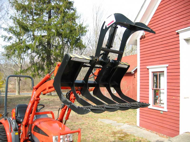

I think I'm gonna go ahead and order a Markham Welding root grapple (66") and a toothbar today. I know I've said that before but if I can find the time before 5pm I believe I'll go ahead and do it. I had considered the 60" grapple but I think the 66" would look more balanced with my big tractor. It only would add about 25lbs too. So I don't think that would adversely affect my net lifting capacity. I couldn't imagine lifting a ton of brush. I guess I could imagine lifting a 2,000lb rock though. But the weather's supposed to be in the single digits early next week. So I may have my dealer pick up my tractor and install the extra hydraulics and get the grapple on the way since I won't be able to "play" outside.

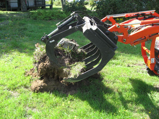

Then how does one curl the "Brush Crusher"? You need to be able to curl/uncurl a grapple in order to pivot the jaws over the top of a pile or stump before closing the jaws. Otherwise you are limited to a passive straight forward scooping motion (e.g. float position) which would certainly work for some things but would be pretty limiting.
If you cannot curl you cannot pick up things like this:
/ Grapples Galore #55

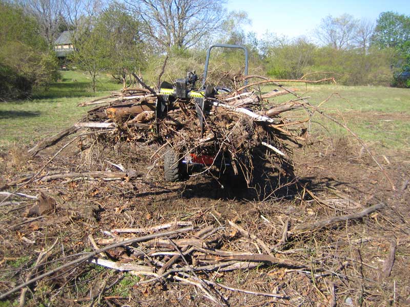

Absolutely... you can pick about twice as much brush if you come down on it from the top. If it is a tall pile, use downpressure with your bucket to crush the brush down, then close the grapple to pinch a big bite...
If it is looser stuff, like slash from treetops, I like to tilt the front of the bucket (and toothbar) down about 30 degrees, then push into the pile until I've filled the entire bucket and grapple (with the grapple open) and then curl the bucket trapping the brush underneath it. Finally, close the grapple and pinch all this together into the bucket. Then lift straight up, with the grapple still pointed toward the ground. I can get about twice as much brush into the bucket using this technique. Plus, with the grapple pointed down to the ground, it moves the whole load back closer to the tractor (and lift cylinders and pivot points) and I can pick up noticeably more weight...
/ Grapples Galore #56
KentT said:
If it is looser stuff, like slash from treetops, I like to tilt the front of the bucket (and toothbar) down about 30 degrees, then push into the pile until I've filled the entire bucket and grapple (with the grapple open) and then curl the bucket trapping the brush underneath it. Finally, close the grapple and pinch all this together into the bucket. Then lift straight up, with the grapple still pointed toward the ground. .
That is exactly what I do. The only tricky part, which really just requires practice, is rolling the top of the grapple over the pile as you slowly move forward. That manuver helps to crush the brush into the grapple. Just driving forward without rolling the grapple over the top will just push the pile along the ground rather than trap it in the grapple.
