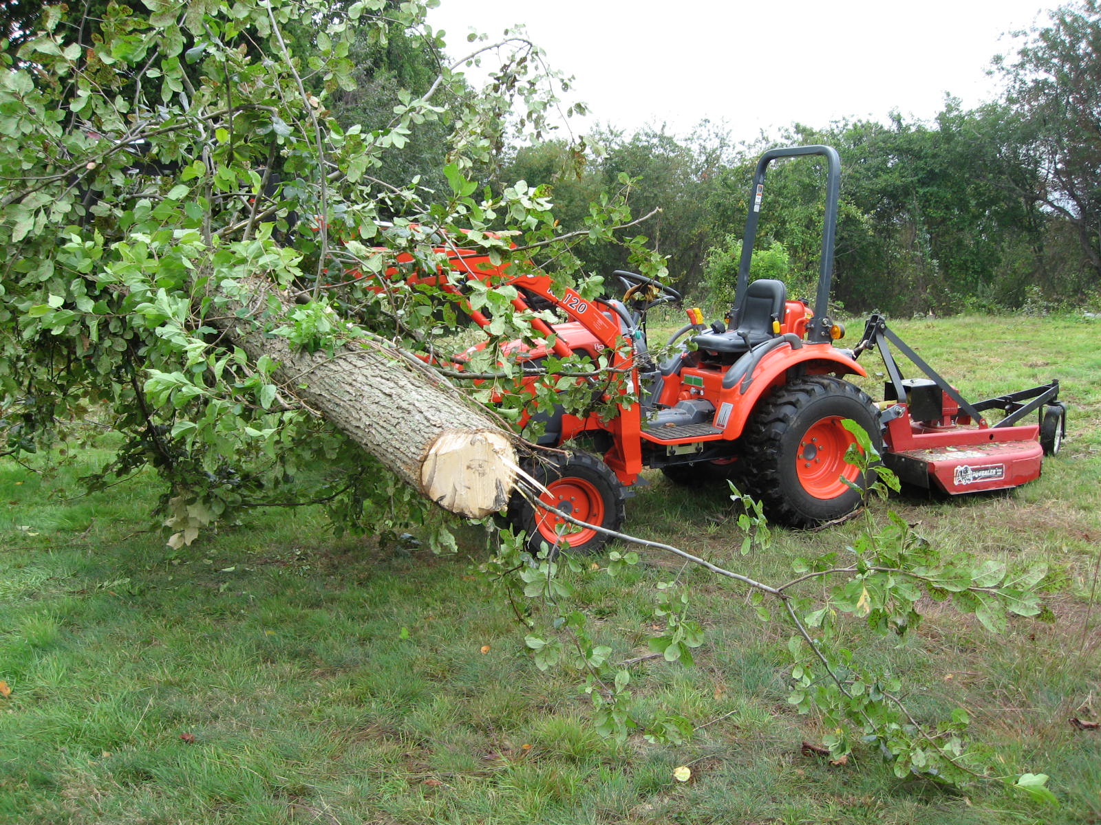

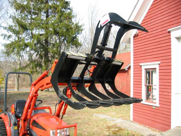

I have posted a few more photos of the "naked" Millonzi 48" Light duty root grapple. Wt. 280lbs. These show some of the positions you can put the grapple in to pick up material. I think a straight bottomed grapple might not work as well with what I term the "pick up" mode rather than "scoop up" which all grapples and grapple buckets should do well. While I use the scoop mode quite often, when it comes to picking up a small brush pile it is more efficient and less messy to come down over the top of the pile and "pick up" the pile rather than pushing it along the ground to scoop it up. I will actually come down on the pile at a slight angle to get the bottom grapple jaw under the pile then slowly drive forwards while rotating the top grapple over the pile. I find that increases the amount I can get in by rolling the pile into the grapple jaws. Once the top jaw has rolled over I just close it and I have a nice big bite of brush. The same is true for positioning the grapple to pull out small rootballs/stumps as you can come down over the top of the stump and use the grapple jaws to dig under the stump and then curl and pull it out in one step.

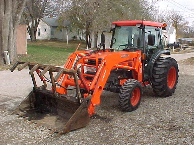

Here is a bolt on one. ($1,200)

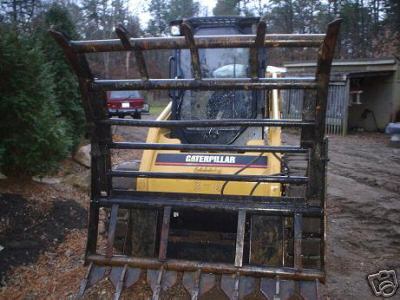

Here's one that works well and is similar to several others shown here, can pick up a pile of brush or one stick of wood at a time and move to the splitter. Found it on EBay.

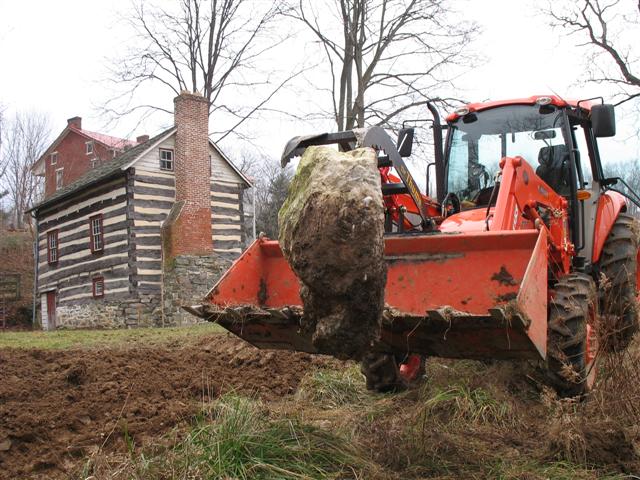

Here is a pic of some brush picked up by Dehner's Big Arm. I would have preferred the grapple bucket but total cost for my setup last spring, including hoses and fittings run from the rear remotes was $520.
