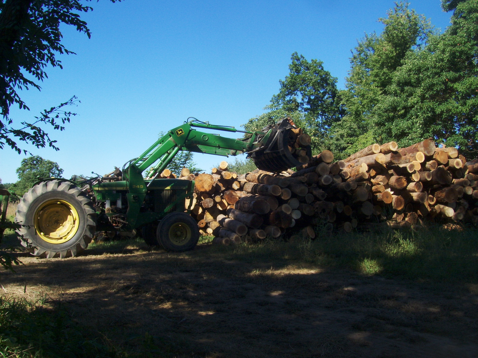

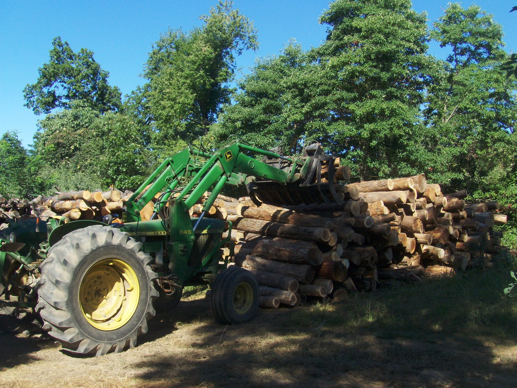

That's what I should have done. Made my frame mount tab taller and more forward, then used a shorter stouter cylinder. Famous last words!!!
Do you know what the stroke length is on that cylinder?
Edit: Never mind, I checked out your link. They say 10". My pea size brain can't figure out how to make that work on mine. My claws and apron must be shorter than theirs. I'll have to take some more measurements of mine.
Yours looks like it is working pretty good. :thumbsup:

Thank you, yes if works fine. I'm just regretting little things I could have done to make it better. That is if I had retained what I learned in Geometry class. :D

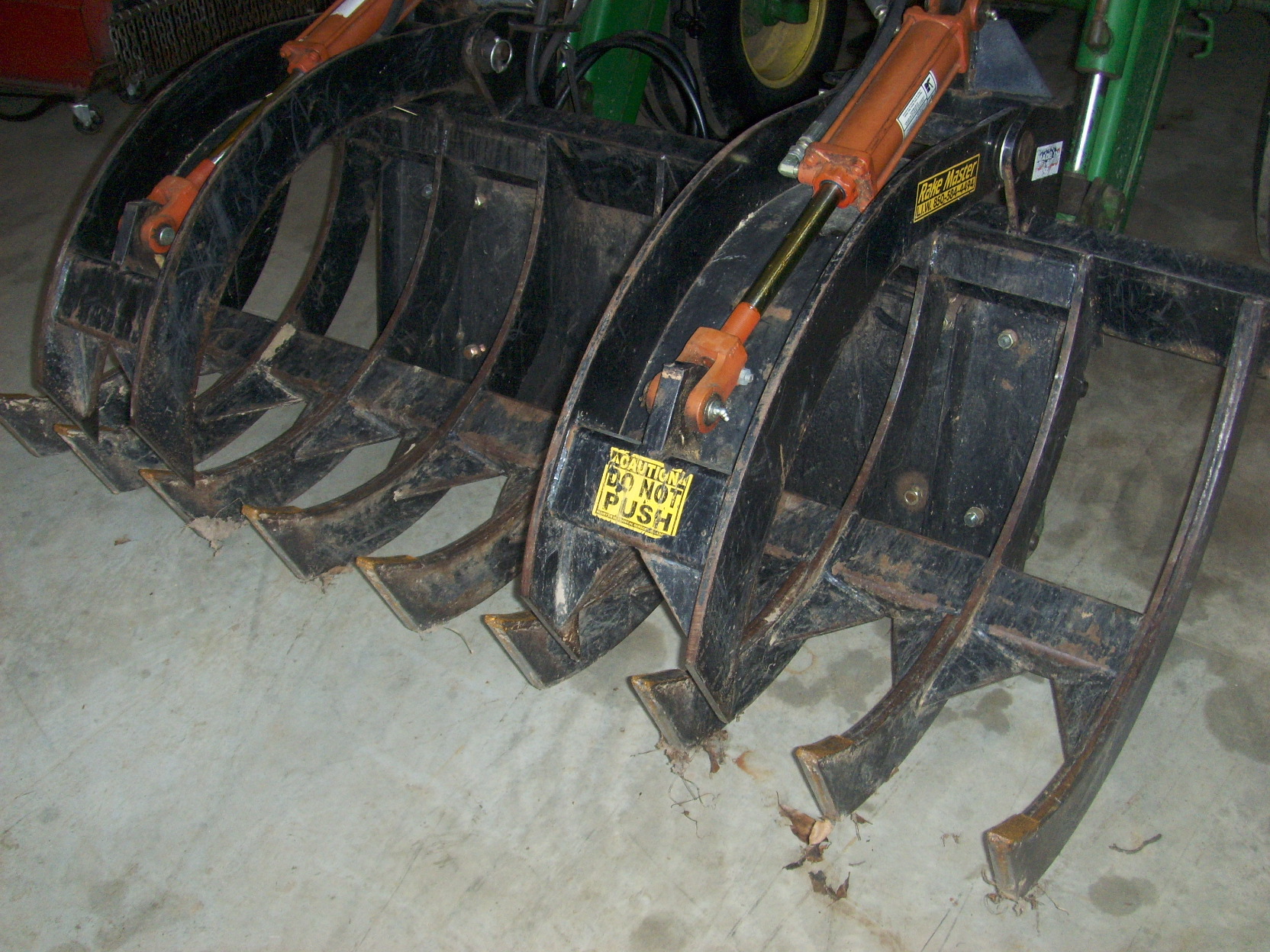

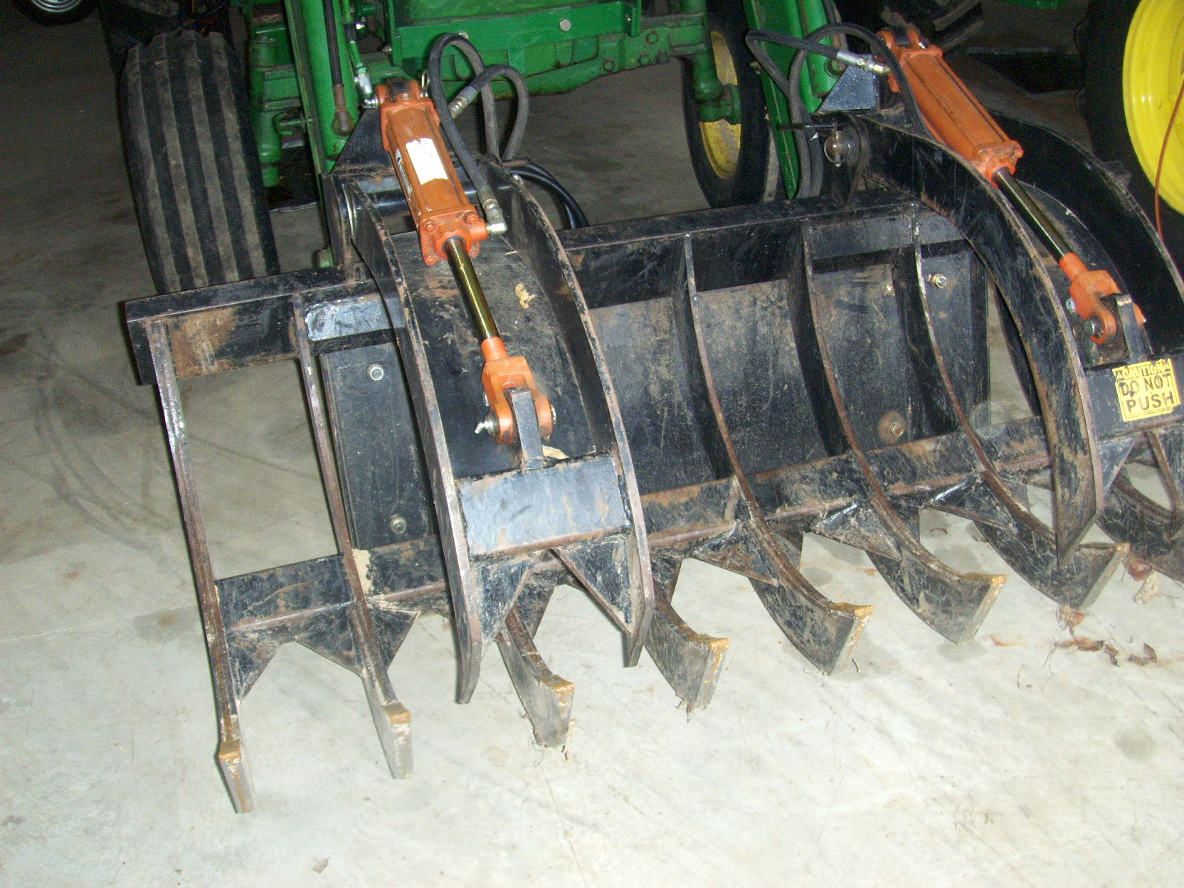

Here's a couple of pictures of the RakeMaster grapple

That thing is very well built!!!! Are your cylinders 2x8?? Anxious to see your "C" measurement. Also would like to see a pic with the claws open if you have one. Thanks!!!!
