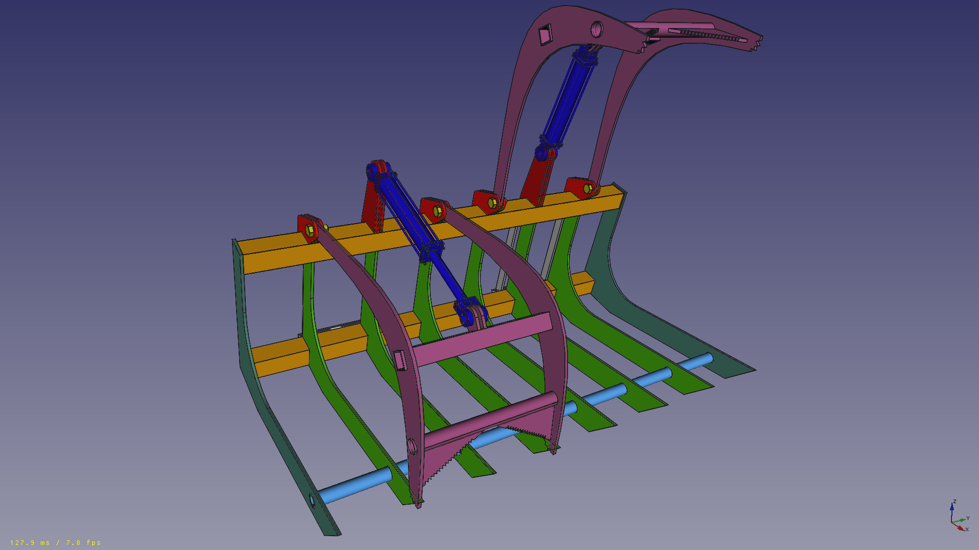

Need to gusset the lower tines
Also needs more bracing in the claws unless heavy high tensile steel is used. Might incorporate a cylinder protector into that part cause it can't be used without one.

I think the design is almost complete. I just need some bracing on the lid, some expanded metal at the back and some protection below the cylinder. But I am tired, I need a break from CADing. I will start working on the BoM. What I am missing is a easy way to do the nesting for the CNC. Freecad's nesting tool is in development and does not work well yet.
Here is the step file.
Here are the original Freecad files if someone wants to edit them (needs Freecad v0.17)

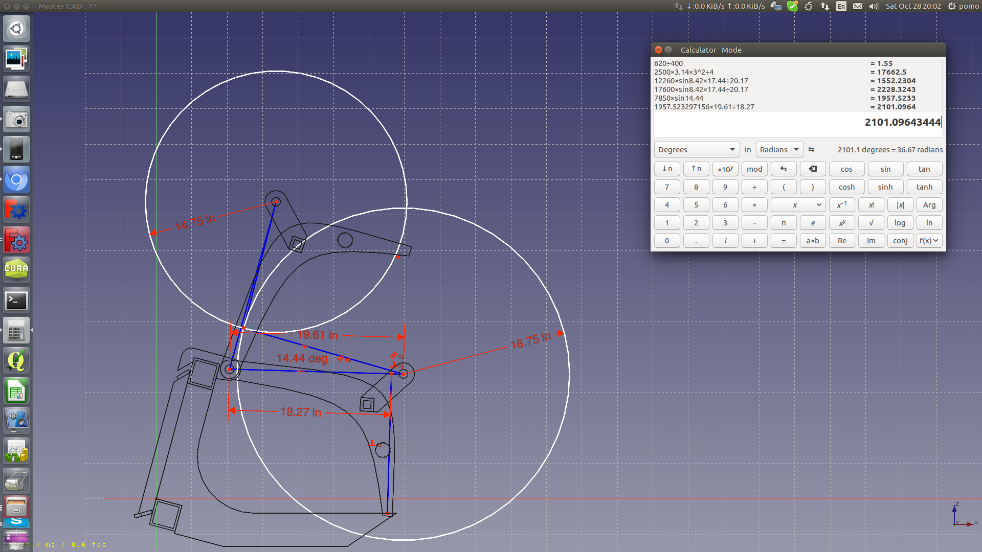

With these 2.5" cylinders I get 2130lbs at the closed position
or 1360lbs with the 2" cylinders
And thats the geometry. The cylinder at the closed position is not 100% extended, it has a little travel yet thats why the lids look like they are overlaping the tines.

I would skip the expanded metal for the back. Use sheet metal for under the cylinders. And NOT use NPTF threads/fittings!

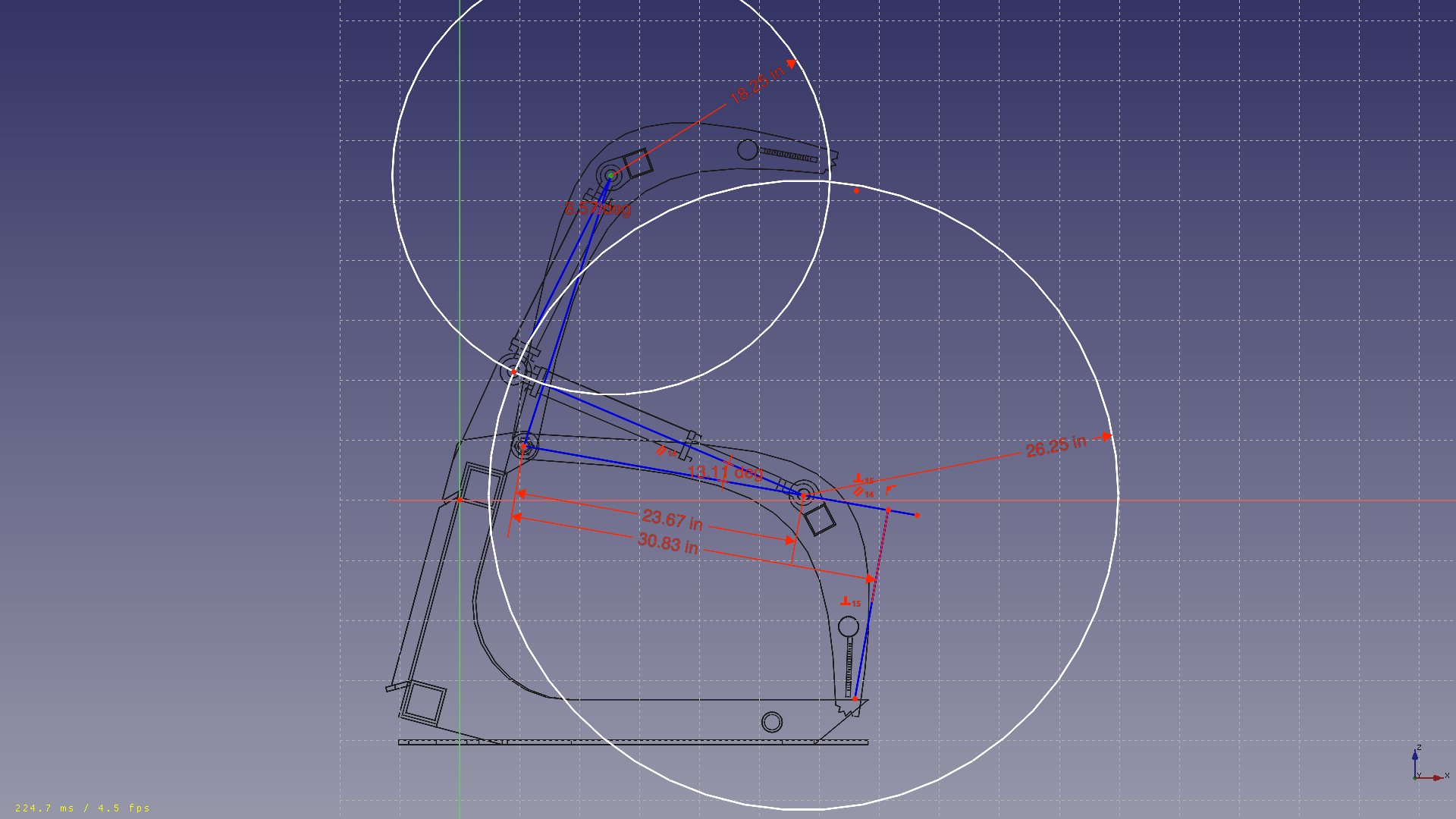

Just to throw a monkey wrench in...
Did you consider placing the cylinder(s) behind the bucket? Your clamp would pivot at the top of the bucket, with some extra length sticking out the back for a lever that the rod actuates. It solves the angle problem by pushing nearly perpendicular to the lever arm at full clamped position.
But you'd have a heck of a lever disadvantage. So unlikely you would gain much in the long run if anything

Not really. Maybe I explained it poorly. Google "clamshell loader bucket" for pictures. Compact design, cylinders are protected, and plenty of clamping force. It also avoids the large lever arm going up above the back portion, which is usually the part that gets torn off on large farm equipment that is working round bales.
/ Grapple project OPEN SOURCE #151
I know what a clamshell bucket is. And what you are describing doing for a grapple is like the root rake that bcp posted a picture of.
The top clamp is a long lever. With the center picot much closer to the cylinder than the tips of the tines. The result is a long lever. The tips of the tines have what looks like a solid 8:1 advantage over the cylinder.
So while there is no reduction due to angle of cylinder mounting.....a cylinder with 8000# force will only yield 1000# or so of bite force.
So like I said, different design with it's own pros and cons....but not really gaining anything in terms of clamp force

IF a 2x8 cylinder is chosen.....you have approx 7850# of force to work with over an 8" range. THATS IT.
If your grapple travels 80" open to close...thats 10:1 and you will have 10x's less force....IE 785#
If your grapple travels 40" open to close.....you have twice the force at half the distance of the previous example.

Yes I did considered it. But I am loosing LOTS of clamping force because of the lever. I thing that the cylinder end up nice there, and the protective sheet will also double as bracing.
Any chance you can get some FEA on it? That will tell you exactly where you need to add gussets
Freecad has a FEM workshop, that uses Calculix. BUT, its soo more advanced than me. And most tutorials are for building with fountations etc, so it will take me some time to learn it. I decided to take the CAD learnign approach step by step! I know now about the 20% of the functions/commands. And the FEM looks soo scary!! :eek:
So what I am doing now is to try to get a nice nesting software, so we can finally have a .dfx file that anyone can take to a CNC machine and get the cut steel. But It will take a while as the Nesting tool of Freecad is buggy, and the whole process is messy. Also trying to figure out a a convenient way to have a repository for future designs also, that will also allow for more immediate development convertations, easier to collaborate. There is so much information on that thread but its lost in the depth of the 16 pagess. I do not expect that anyone will ready all the posts. Maybe a wiki website? I would like to note down all the ideas, and the mistakes also, so the next guy will have some heads up. The BoM is very easy I will finalize it when I find out how much steel I need, and get a guote.

I took more accurate measurements and I actually have 6" of distance between my claw hinge pin and barrel end of the cylinder pin rather than 4". I've gave up trying to calculate my "bite". It's simply above me. :)
/ Grapple project OPEN SOURCE #160
Yea, that makes a difference.
Previously your cylinder was on a 7.1* angle, giving 970# of force at the cylinder for being on such angle, resulting in ~776# clamp force at the tines.
With the new measurements, You are on a 12.4* angle. Giving 1688# of force at the cylinder for that angle, resulting in ~1350# of clamping force.
Amazing what just a few inches and few degrees can make.
