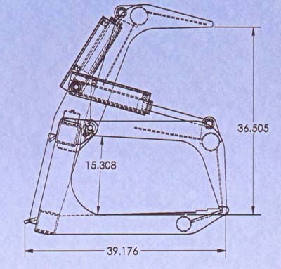

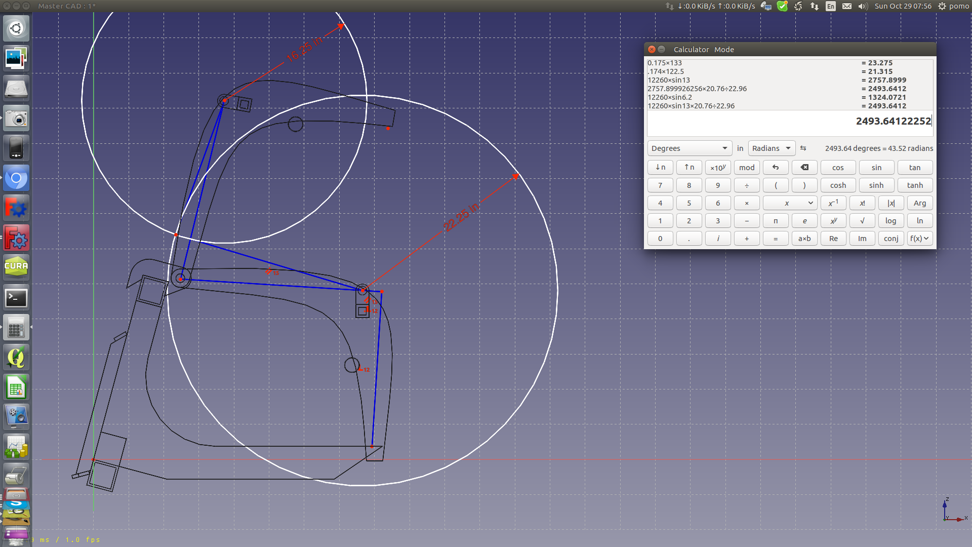

Previously your cylinder was on a 7.1* angle, giving 970# of force at the cylinder for being on such angle, resulting in ~776# clamp force at the tines.
With the new measurements, You are on a 12.4* angle. Giving 1688# of force at the cylinder for that angle, resulting in ~1350# of clamping force.
Amazing what just a few inches and few degrees can make.
Interesting LD1 calculated my "bite" at 1300lbs using my tractor's rated pressure of 2250psi. In post #115

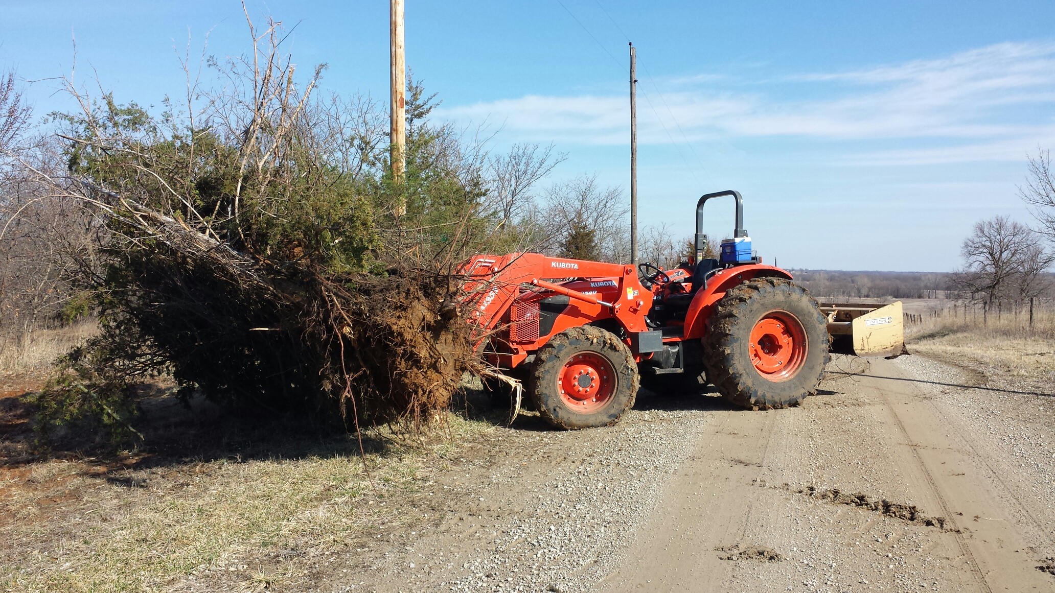

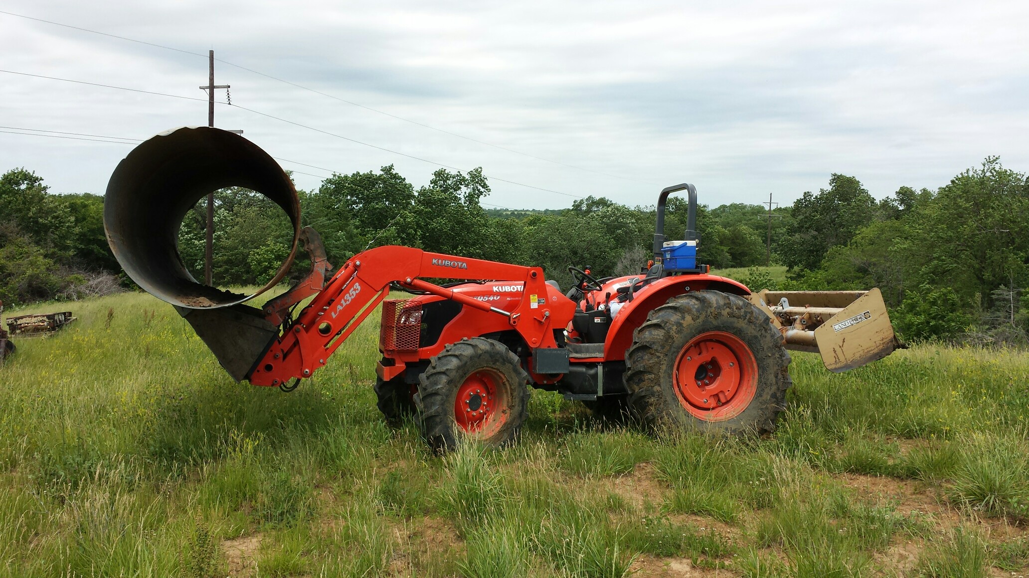

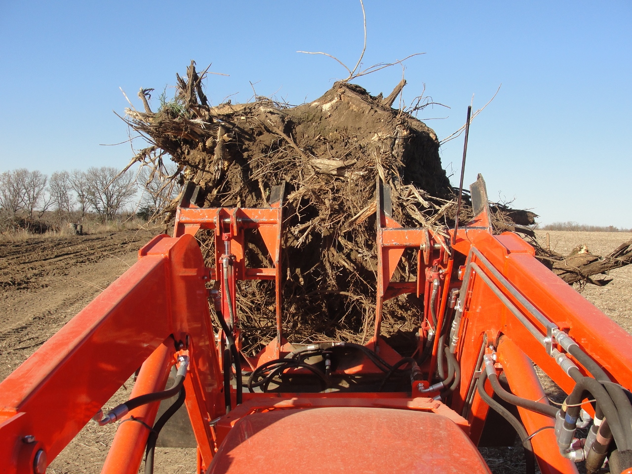

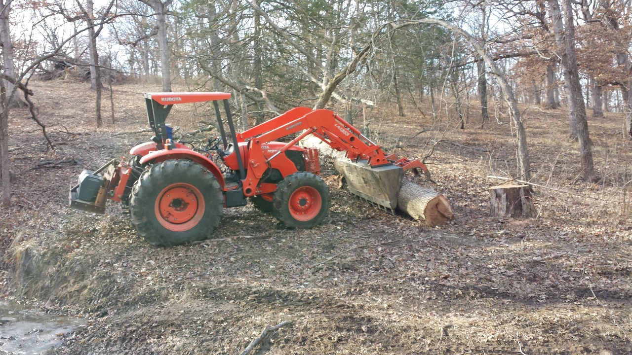

In this specific implement, after 2 years of use(abuse), I believe I have some feedback:
a) AR400 is weldable even from beginners like me if you be careful on heating/cooling. I have zero cracks on the metal.
b) 1/4"=, even AR400, will bent if you use the grapple as a dozer blade! haha! But If you use it to move stuff around, I think its fine. Od course, if you have a tractor bigger than a compact one and you have enough lifting force available, go to 3/8. Its removes the stress factor.
c) The top square tube has to be 1/4" thickness at least. The 1/8" will rip like newspaper when you grab something with the 2" cylinders at 2500psi. Literally like newspaper!. I was not paying attention and I didnt do stress analysis there. Combine this with my zero experience on metal fabricating, resulted in a big fail on the top square tube. I say 1/4" at least, because I doubled the top face of the cylinder between the lid hitches) with a 1/4" flat bar to avoid another breakage.
d) The front round bar that goes between the tines was a simple sch 40. Wrong. It bent at one edge at some point. I would go with both sch 80, and one diameter size up.
Anyway, just a few thoughts after working with the grapple. I use it in the forest as I am thinning to make piles of limbs, and to load the firewood processor.
