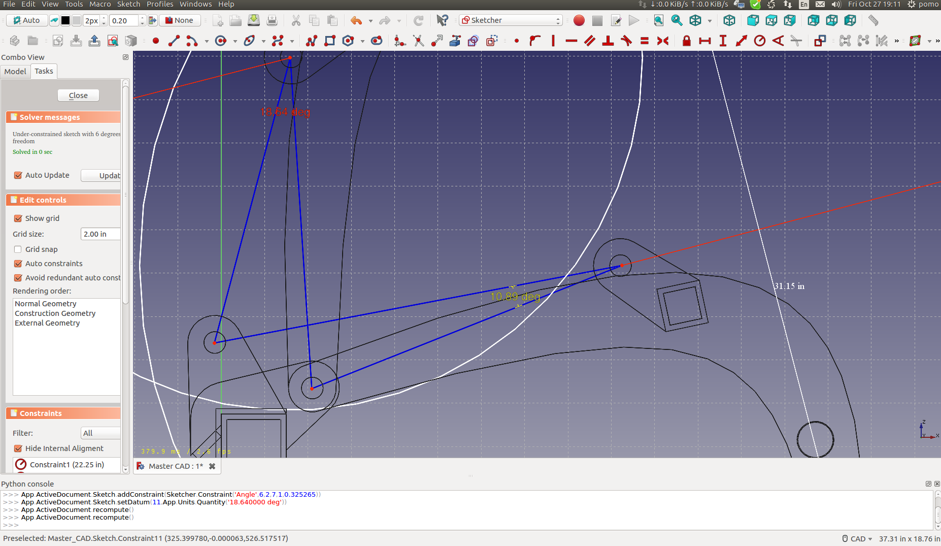

There is another way. I can give you easy instructions in a video how to do it in Freecad. Its really very easy, no need to learn the whole program, just how to draw a few lines in 2D. Then it will show you the angles, and the distances. It looks easy for me anyway!! hahah

Not trying to jump over LD1.
Measurements with claws closed.
A = distance from barrel end of cylinder pin to ram end of cylinder pin
B = distance from hinge pin of claw to ram end cylinder pin
C = distance from hinge pin of claw to barrel end of cylinder pin
D = distance from hinge pin of claw to tip of claw
Here are the measurements for my RakeMaster grapple
A = 28.25'
B = 23.50
C = 6.25"
D = 31.75"
Cylinder is 2 1/2" x 8"
Tractor has 2250psi
Thanks for bite pressure calculation!
/ Grapple project OPEN SOURCE #115
Approx. 1300# bite force zebra.
Cylinder is on a 9 degree angle. But since you start off with a 2.5" cylinder...that starts you will 11000# of cylinder power instead of 7800 with a 2".
