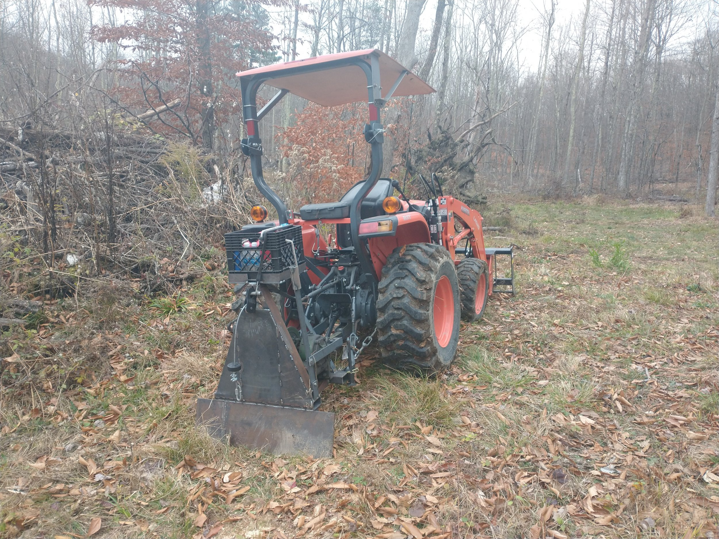

I have a winch as well but it's a pain to use alone for these short logs. I plan on adding a couple of sliders on the cable of the winch so I can drag at least three of them at once.
Said winch:

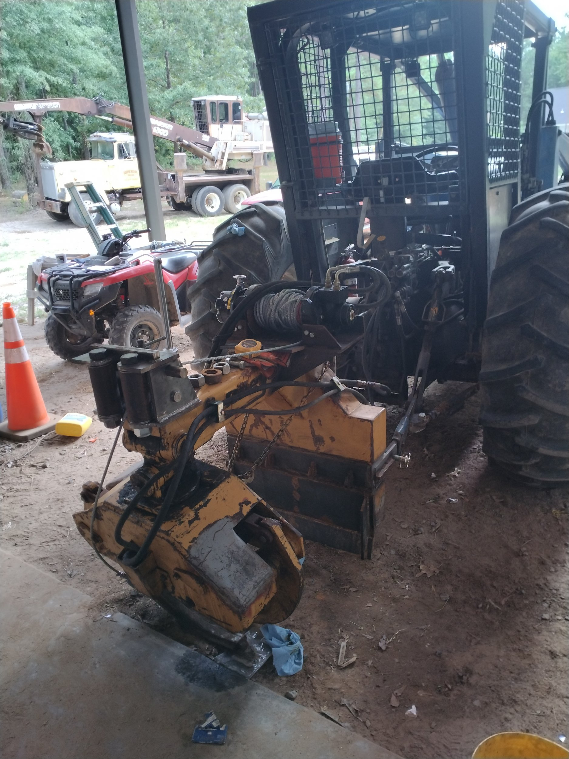

This grapple just has two 1" arms and they bypass to close to zero. One cylinder in top makes it happen. No rotator. I don't see the need for one. We put a hydraulic winch on it, now the tractor stays out of so much junk.
