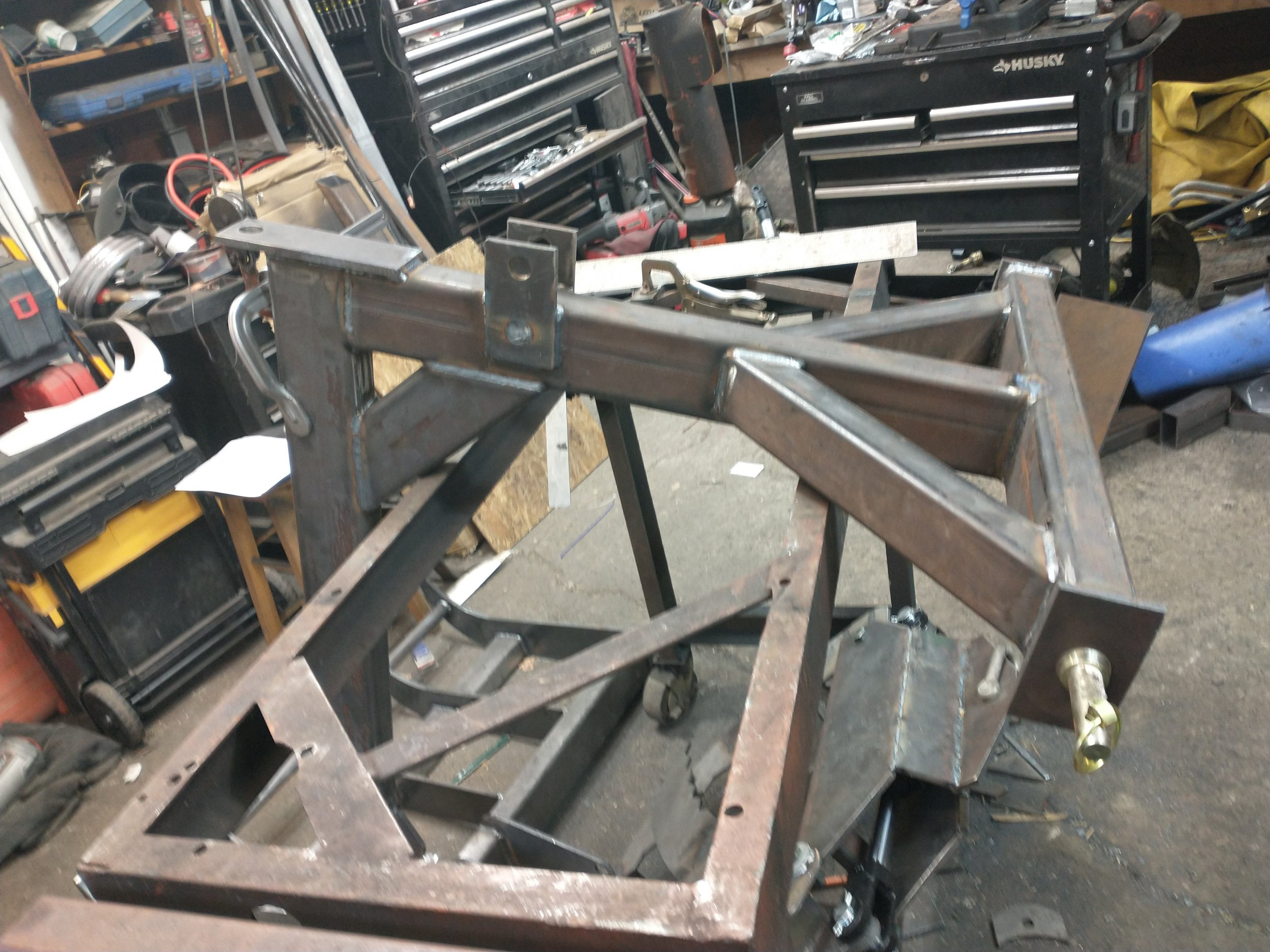

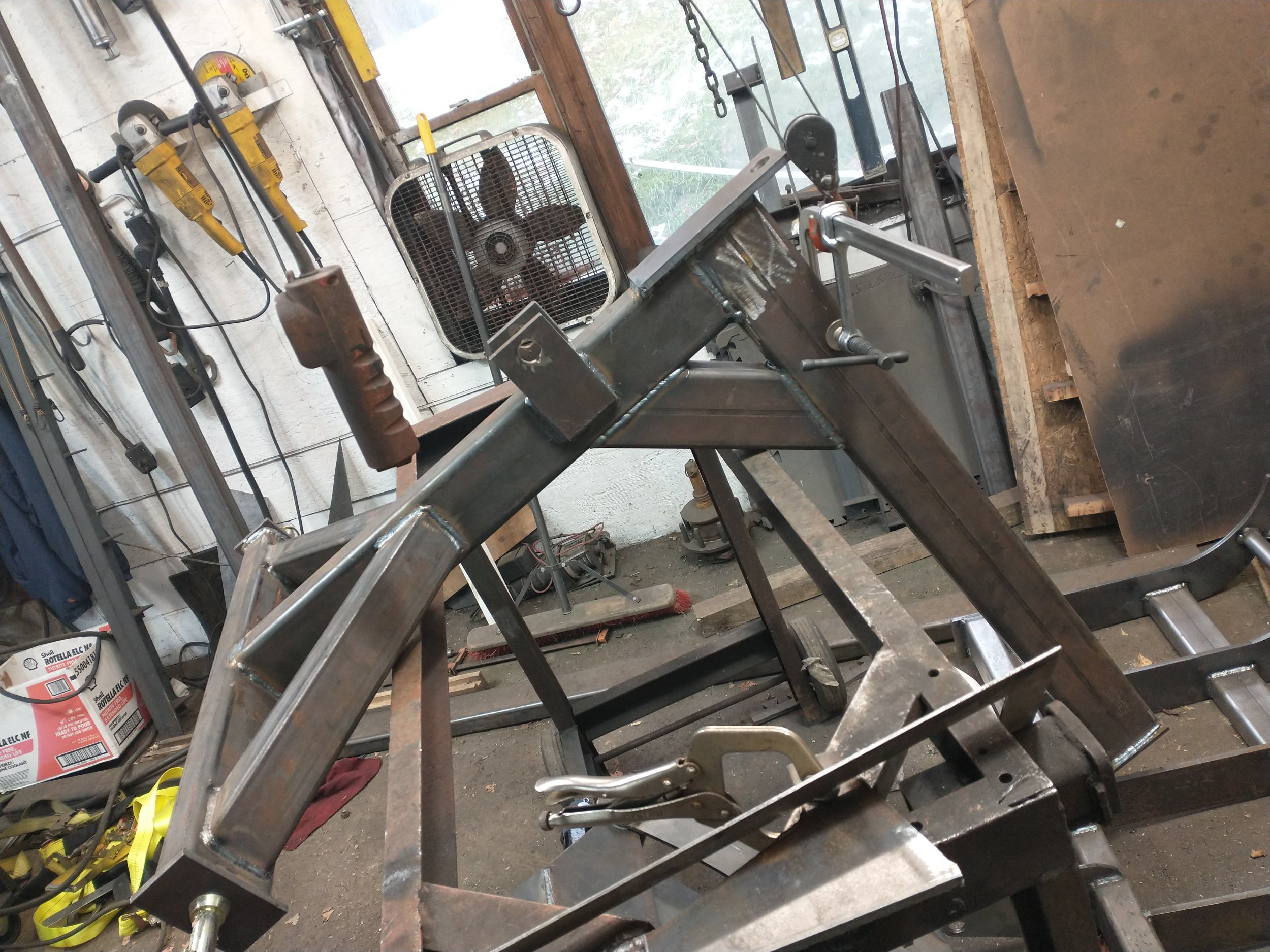

I made a little progress today.
Got to work on the 3 point setup.
I added a lifting hole and another on the outboard end just in case I want to add something out there.

Looking good! Nice work.

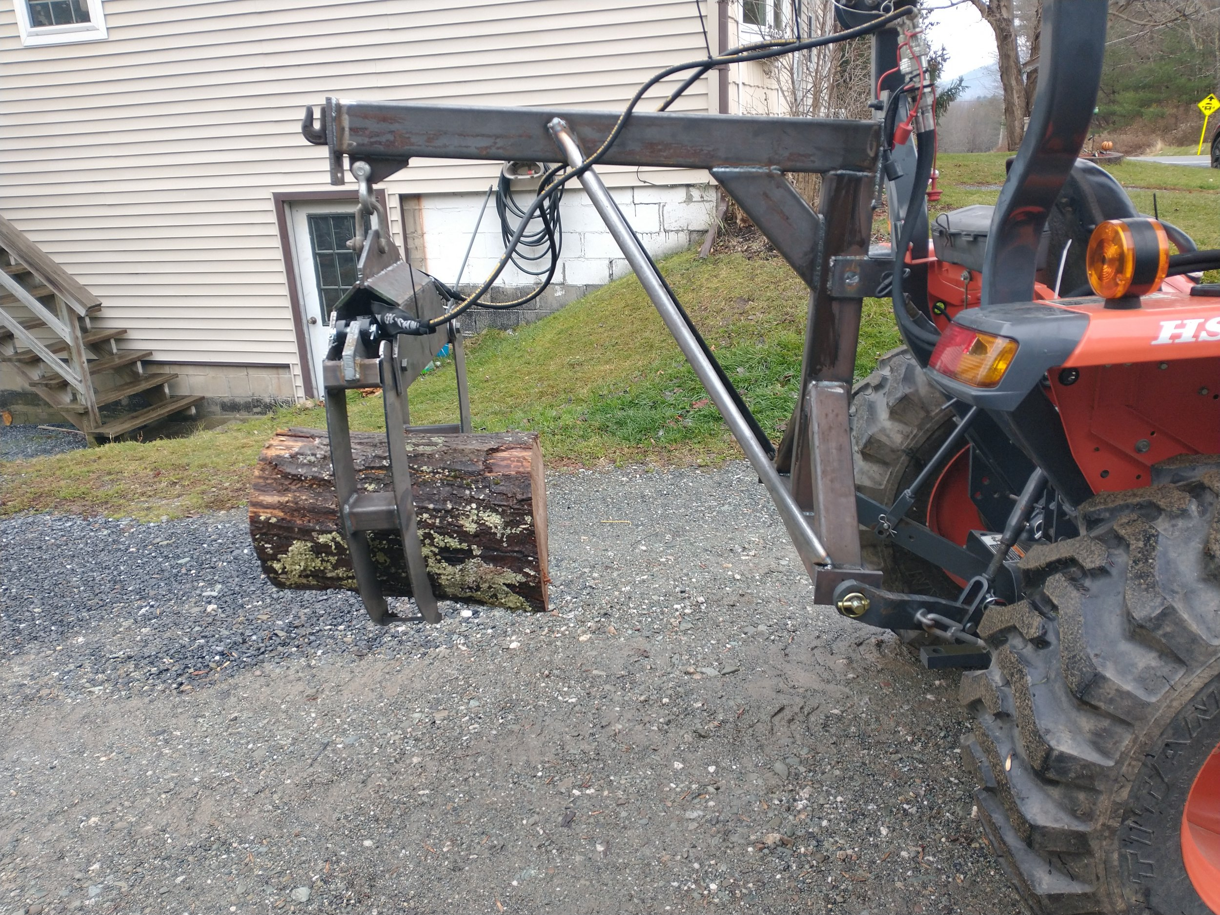

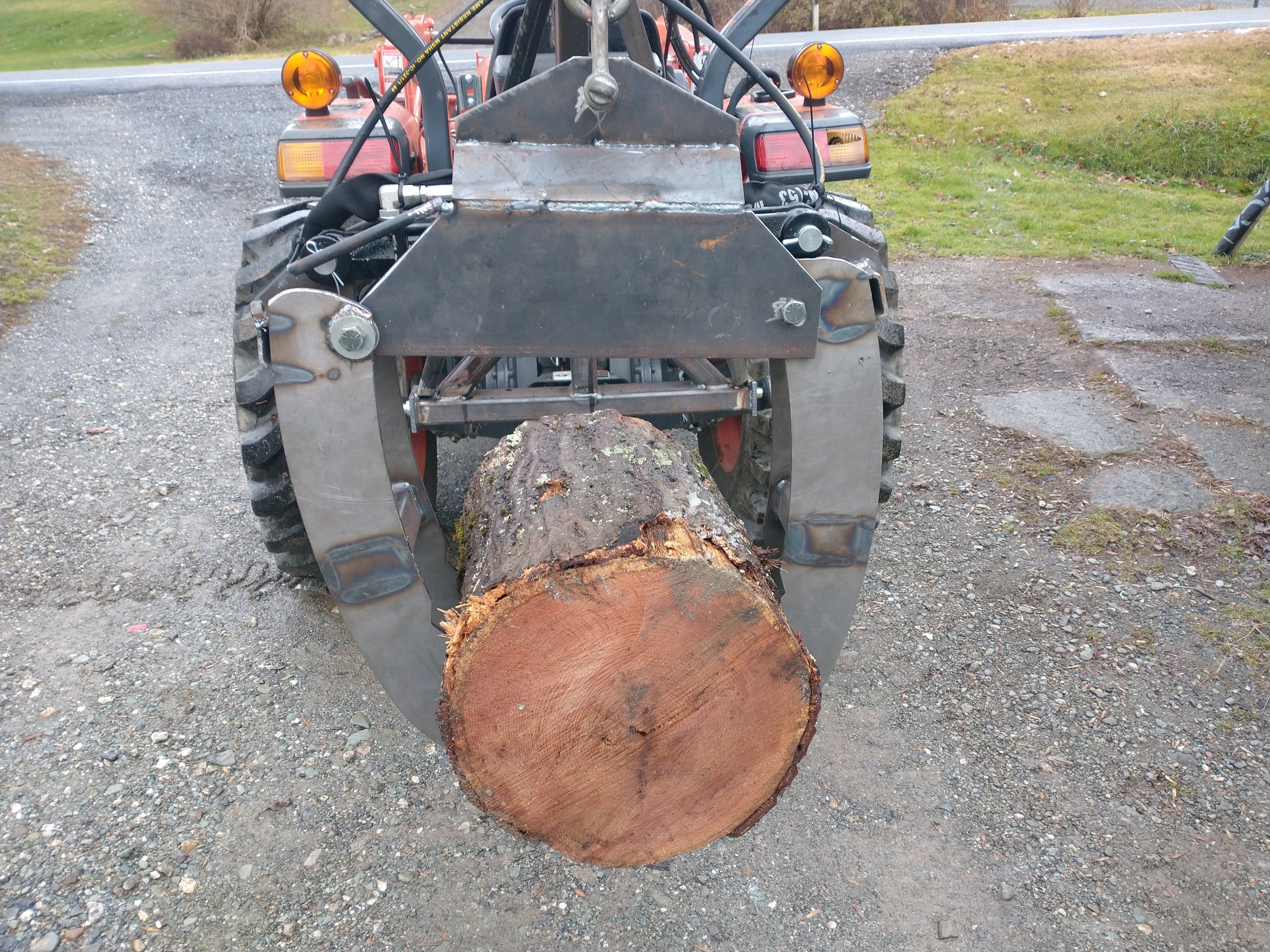

Today's update, it's operational!
The way it's configured the cylinder is kind of floating so whichever side has the least resistance will move first which isn't a huge deal but I would like them to move together. It looks like I will have to fabricate up some rods that will go from one claw to the other so they move in unison. Tomorrows project...lol

Very nice work!
