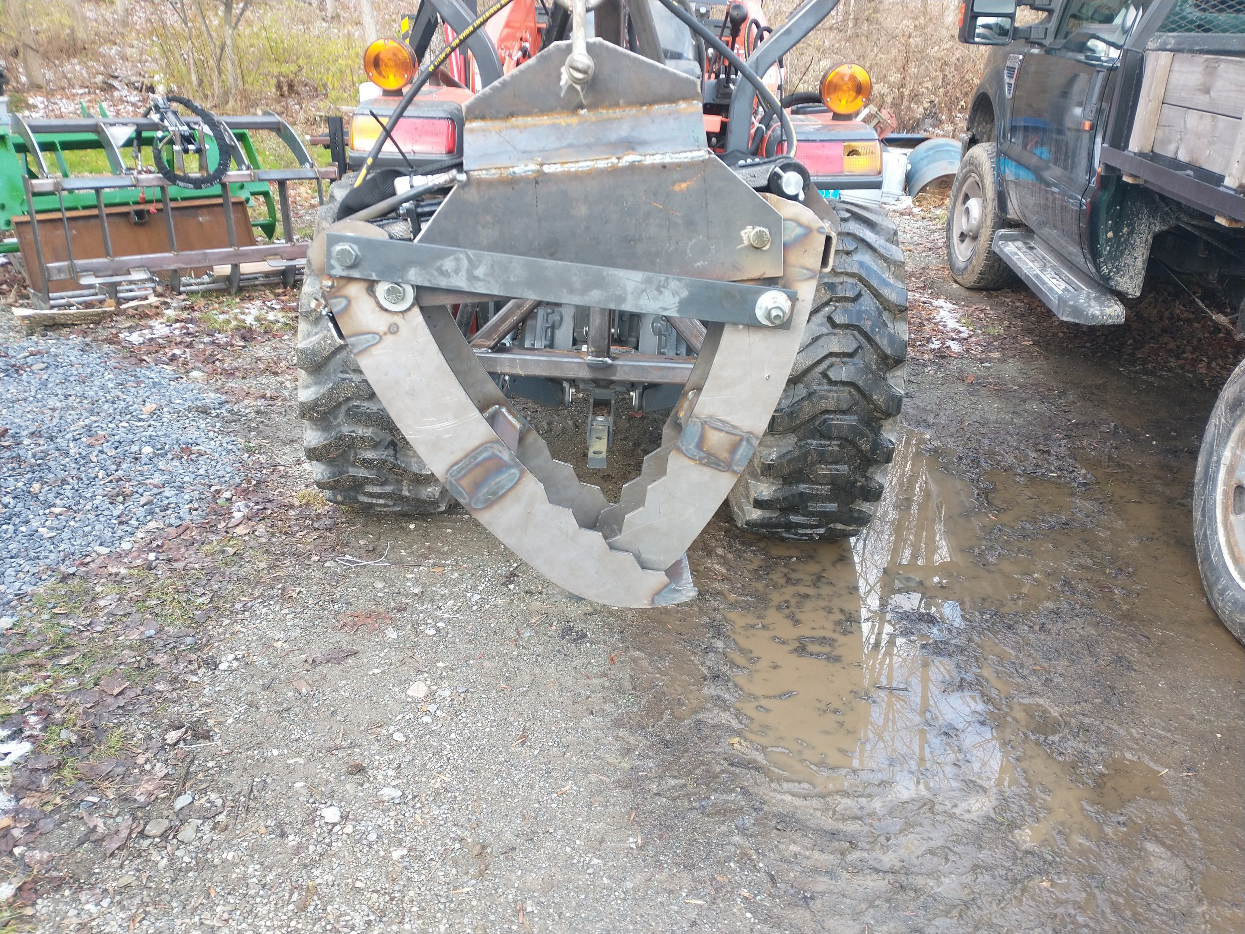

Today's update, it's operational!
The way it's configured the cylinder is kind of floating so whichever side has the least resistance will move first which isn't a huge deal but I would like them to move together. It looks like I will have to fabricate up some rods that will go from one claw to the other so they move in unison. Tomorrows project...lol
Hope it works well for you. Nice going.
Do you ever get to sleep?
   / log grapple design/dynamics? 3 pt
#53
I installed a flat arm from one side to the other, works as I thought it would, now they open/close together.
Arrow I sleep at night. LOL
Not working now so time is plenty.
