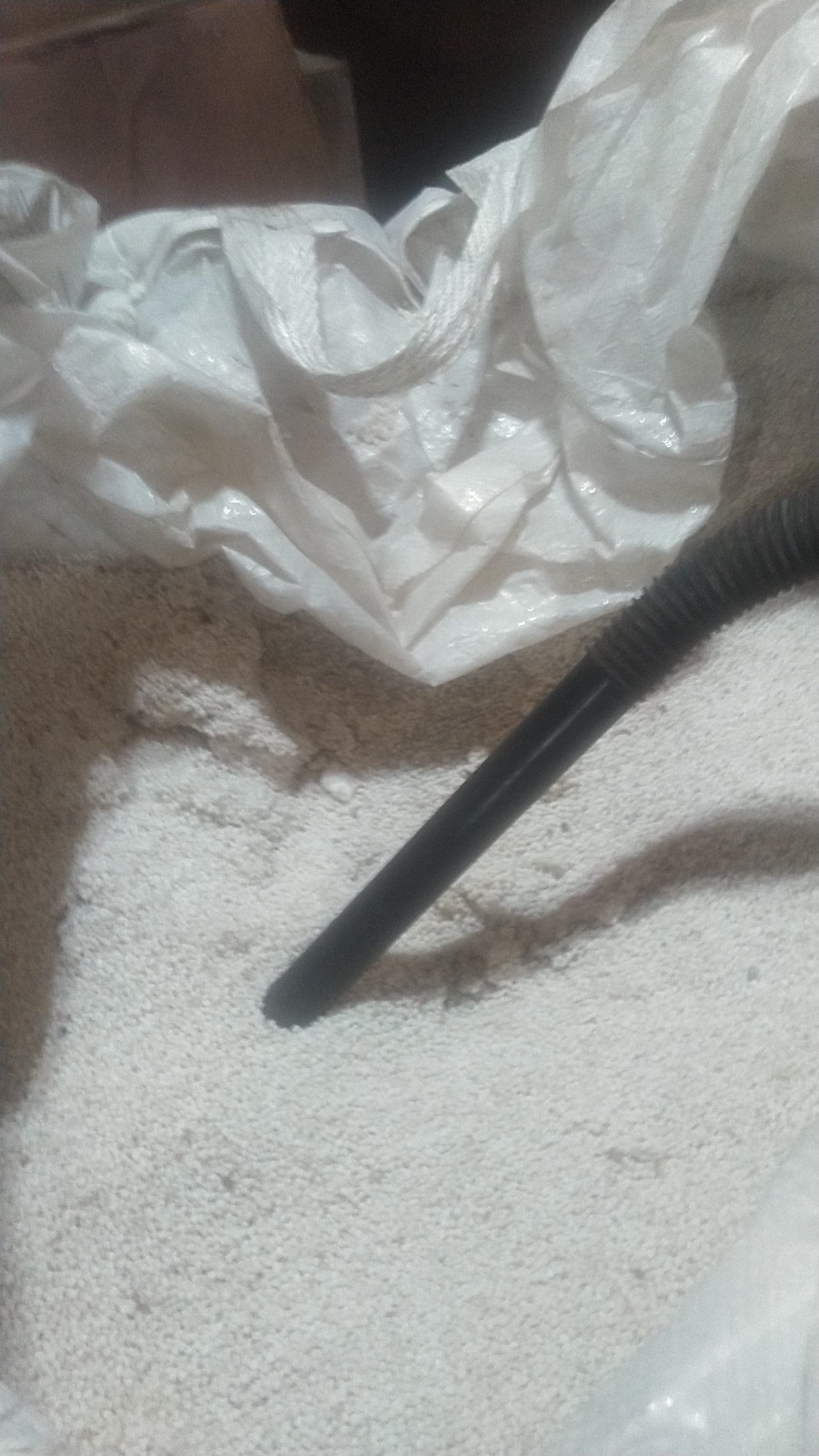

I've come to believe that the plastic collection bin is an integral part of the suction power, and a unperforated plastic bucket seems the best I can do producing enough suction with that older shop vac.
Yeah I’m sure it is … any leakage at the plate and the vac head would reduce suction.

I get a sense of stupid bragging accomplishment when a backwoods hack works like I want it to. My somewhat repurposing of a 20+ yr old shop vac and empty 5 gallon buckets filling a small pull behind spreader I'll still use mini x on filling a 800+ lb cap three point though, works great on my small scale hobby and is quicker and makes a lot less of a mess than shoveling fertilizer out of one ton bags. Any ideas on a somewhat mechanical side dresser using old lawn tractors? 🤔

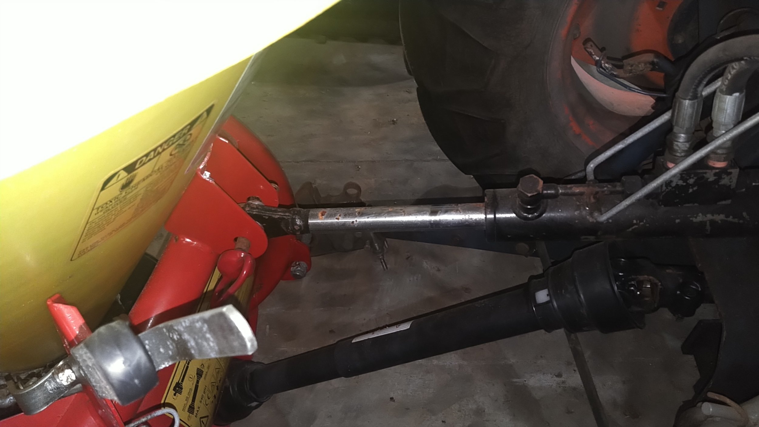

Good point, if I go with steel probably use smaller hoppers fill seasonally from one ton bags. I wonder how much life I'll get out of a old shop vac I'm currently using? Yeah fertilizer, either potassium or nitrogen is corrosive left a little on my hydro top link and it started pitting and corroding the ss ram arm. Lots of ideas to ponder wish I had more skills and I could do to plastics what I can do with steel.

Fortunately I found a free thin walled 300 gallon liquid tote on the roadside a few yrs back spent a few hrs cleaning it out. Was going to use it as an irrigation device of some sort but changed my ideas and it's just sitting around doing nothing so good idea, plus I have enough repurposed steel and might even use repurposed wood to elevate it and build some sort of cage around it so the sides don't blow out as my 1st prototype I'll look or buy a second one if first backwoods hopper hack is successful lol. Repurposed a shop vac with bottom cut out over 5 gal buckets as a stopgap means to fill my small pull behind spreader without shoveling and it works better than I ever expected. Thanks for the insightful ideas.
