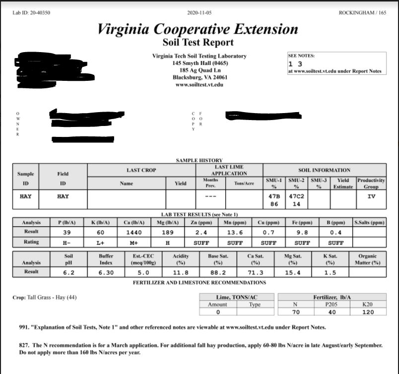

I am just a small hobby guy who makes some orchardgrass/bluegrass/fescue square bales on the side. For the last several years I have just been fertilizing with 19-19-19 and had been putting off getting a soil sample taken. I finally did a sample this fall and got it back and now I need some direction on interpreting and also what to use as the fertilizer since I am used to just using triple 19. This would be done using a 3pt broadcast spreader. A buddy of mine recommended using DAP for my phosphorous and muriate of potash for the Potassium. Can these be bought in bags? Being new to this, if I went this route would I apply 1 product on the entire field and then apply the 2nd product afterwards since I would be buying in bags and have no way of mixing? Thanks in advance.

You can in fact, buy bags of Phosphorous by itself. I think the formulation is 0-46-0. On the potassium side, none of my suppliers around here sell potassium by itself, so I use a 15-0-15.
Also, pay attention to the ph level of your soil. It should be around 6-7. If it's below 6, you would likely need to add some lime to your soil to get the ph up. There should be a recommendation on your soill test results if you need lime.
If you have a good size broadcast spreader, you simply make multiple passes over your acreage. Once per each chemical you need. Doesn't take that long at all. I wouldn't even think about trying to mix it in a single batch. I always try to time the application before a rainy period (<2") to get it into the soil.
Getting your soil balance is important to letting the plants soak up the nutrients you'll put down later. Otherwise, you're just wasting money on triple 19. Wouldn't hurt to do another soil test in Jan-Feb to see how much more correction (if any) you need, and if you should change your fertilizer ratio at all.

Thank you for your reply. I figured 1 pass per chemical would be the way to do it but wasn't sure.

I use Clemson University. Pretty quick with the results, and they give you a pretty detailed analysis, with graph, and specific recommendations on how much of what formula fertilizers/chemicals/lime to use. Used them for 3 years now. Not disappointed at all.

Check locally where farmers buy their bulk fertilizer. Depending on how much you need, they will blend it, and you can spread all in 1 trip. I usually only need around 850 lbs to do my 4 acres of hay ground,but a local supplier will gladly blend it, and load it on my 1 ton dump truck. Takes me about 15 minutes to shovel it into my cone spreader, but sure beats making 3 trips over the field.

Your pH is good, not sure what commercial blends you have available, but I'd pick one close and do it in one pass.
For example blends I have used
550 lb/acre of 12-24-24 would almost give you your N & K with a 92lb/acre surplus of P.
670lb/acre of 18-6-18 would give you exact P&K with a 50lb/acre N surplus

I'm a master gardener and retired chemical engineer. We had a little bit on soil analysis during our training, but our local agent was the only one authorized to read the soil sample results when they came back from VT. I really like the Clemson report MUCH better and agree that their recommendation to use the 15-0-15 fert fits your analysis. You're only low on potassium (the 3rd one of those fert NPK #s) and probably on N, which is too movable to analyze.
Don't really think you need lime, because your pH is 6.2. I'm happy if it above 6 (vs. our natural 5.5 in Va), and it takes A WHOLE LOT to get to an ideal of around 6.5-6.8. If you want to get some lime, I'd just mix it it 50/50 with your 15-0-15 fert and apply it the way you've usually done it, maybe a tad heavier because you have the lime mixed in, and it will dilute the fert.

He's already high in Phosphorus (the P in NPK of fert #s) but low on Potassium (the K in NPK). He needs the 15-0-15 that Clemson mentions.
