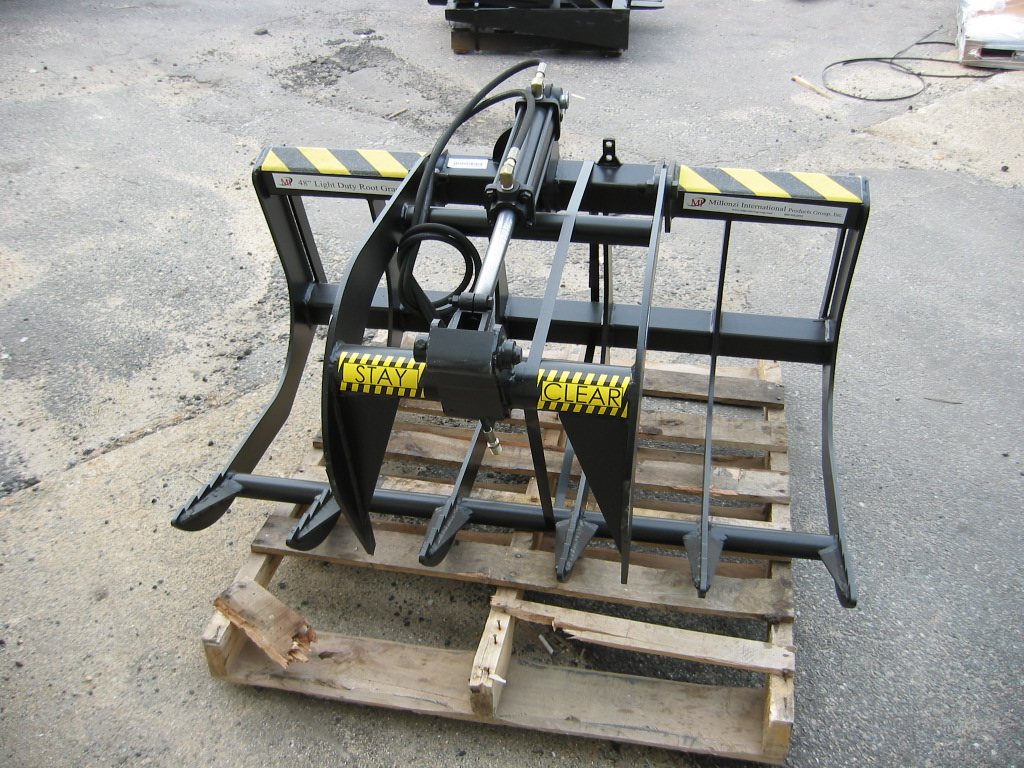

I have multiple grapples, but if I only were to have one, it would be a narrow L bottom with a single lid. The lid would open in excess of 40" and the grapple would be reasonably light.

I made my decision.............. going with a 50" wide single lid. The lid will be 36" wide and the opening will be 45". Had it mocked up and I think it looks ok. I figure that if I'm not happy with the width I can always add 2 more tines down the road, to make it 66".
Tomorrow I start construction. Being a novice at this, it will likely be a day or 2 before I get enough progress to post any pics but they will come.

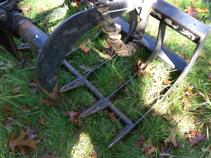

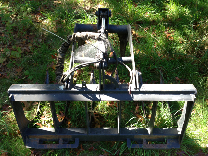

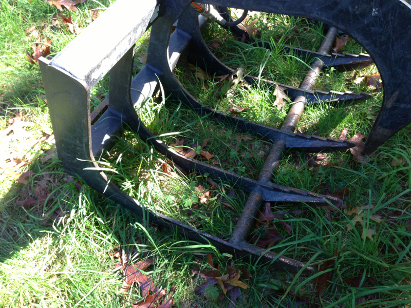

Did you bend the lid, bottom tines or the frame? Now I'm back to thinking 2 clamps would be better.:duh:
The bottom tines (rake) and frame are fine, I torqued the grapple itself a bit. I think I did it carrying a heavy load asymmetrically, but I could have been careless pushing over trees and allowed the grapple to do the pushing (a mistake to avoid). When sitting in the cab, I can see that the top of the grapple isn't quite parallel to the plane of the rake/frame...but it is just aesthetics; everything still works great.

Hilbilly, you might be safer with a narrower lid, unless you make it good and stout. I'm thinking about how the lid might get torqued on a rock when one corner grabs first. 50" - 36" is only 7" of open grapple on either side of the lid.
One other aspect of the lid to remember is it blocks your view when it is open. View is at a premium when you're trying to grab an object (boulder, log, etc.)

Good point about visibility. That can also be addressed by using something other than a solid protective plate to protect the upper arm cylinder. If you can see through that area it helps alot. Two bars connecting the upper tines with a simple bridge of two or three inch wide piece of angle iron directly in line with the cylinder would protect the cylinder without blocking any more view than the cylinder itself does.
I think my upper jaw is only about 18" wide. If I were to custom build one now, I'd make it wider than that but would probably be happy at about 24". The width of the upper jaw is really not that critical to holding the load. Think of your hand where your thumb is the equivalent of the upper jaw. Your thumb works fine to hold loads in your hand even though it is only a fraction of the width of the whole hand.

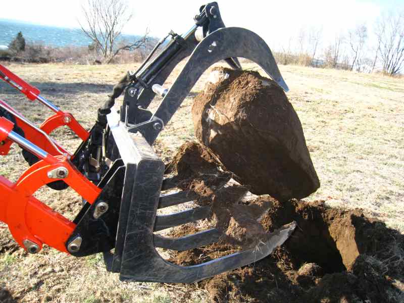

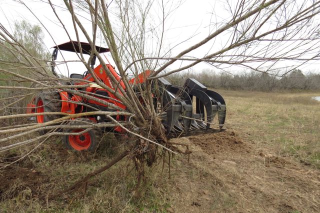

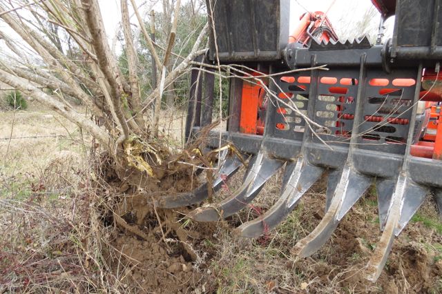

I think the 50" is perfect. Mine is 54". Single lid is fine. Without the bottom cross bar you can dig deeper but with it you can back drag better and don't go too deep and have a better chance of cutting off instead of sliding through some roots. There is no perfect grapple for everyone just envision what you need to get the jobs done.
Side digging next to fence line:

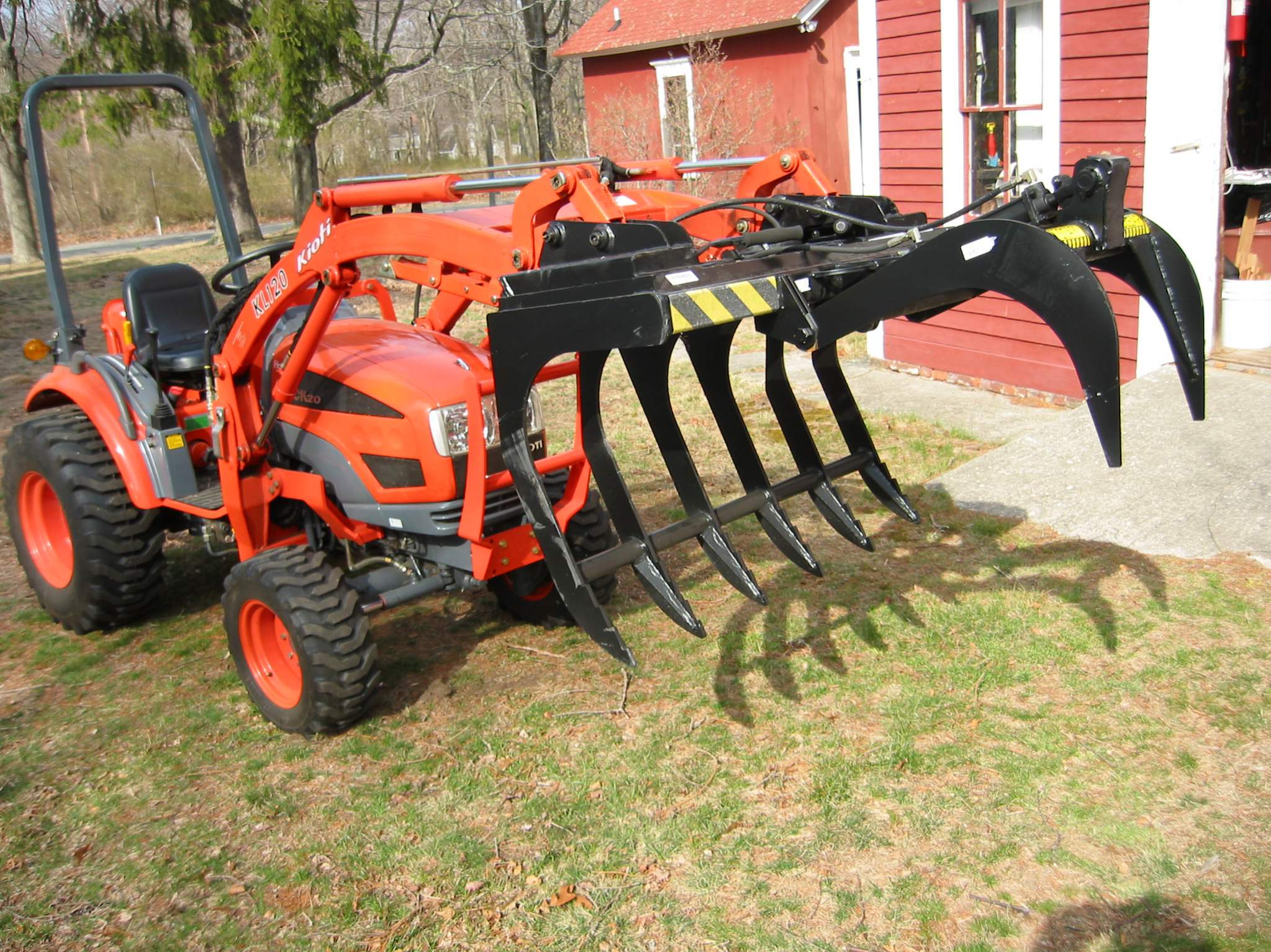

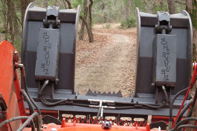

Isn't that the exact reason for 2 lids being better than one wide one. I also like the comment about visibility. Excellent point and I will take that into account when I get back to the grapple. Now I might reconsider dual lids.
You do need to protect the hydraulic cylinder(s) and the front of your tractor. My two solid lids protect the cylinders. The extra metal on the back side of the grapple protects the front grill of the tractor. I do look in-between the lids. I also use the space in-between the lids to push trees at a higher point without putting pressure on the lids. . . and just for you I will go outside in this 39˚ weather and push a tree. Picture in about an hour.

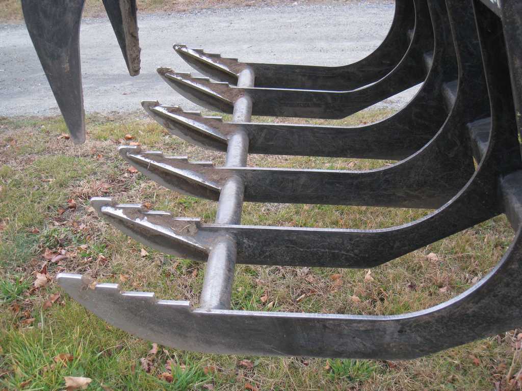

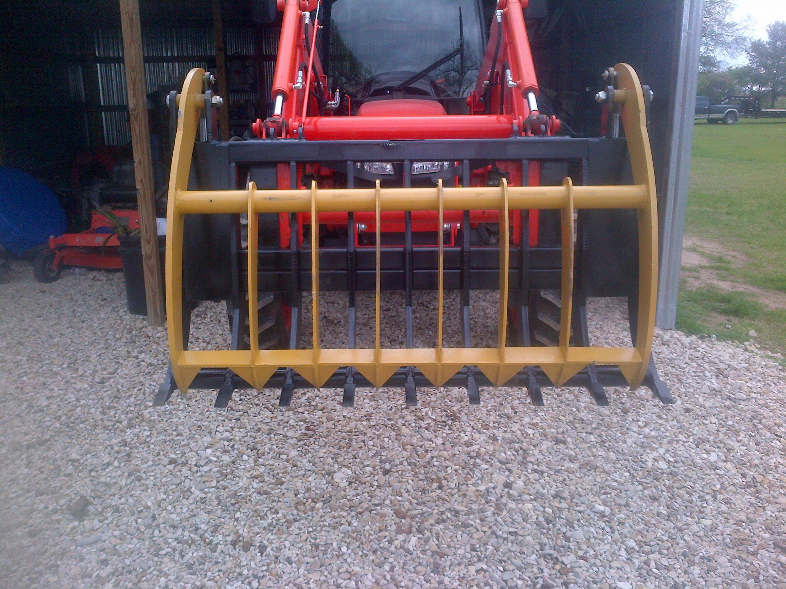

In case you haven't seen it in other grapple forums, here are the dimensions of my two lid Monster Grapple that is made for high capacity machines.
And their smaller Root Grapple.
Loflin Fabrication
The 72" Monster on my V417.

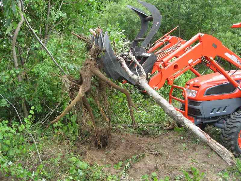

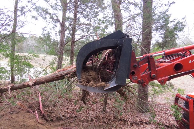

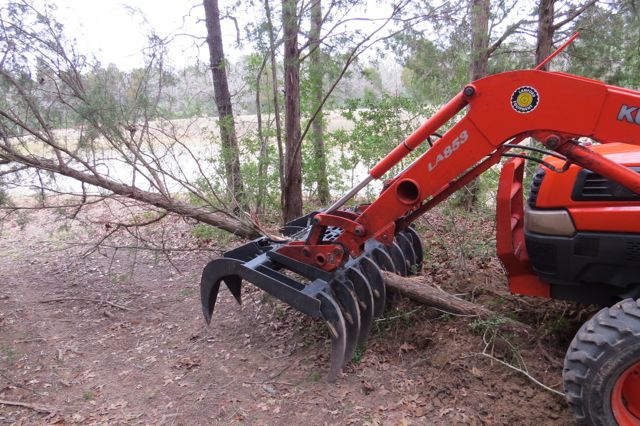

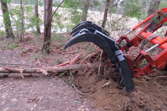

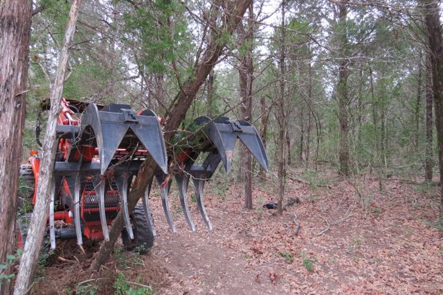

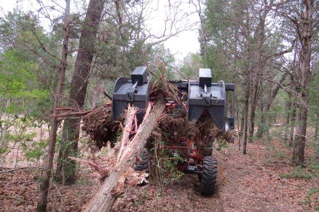

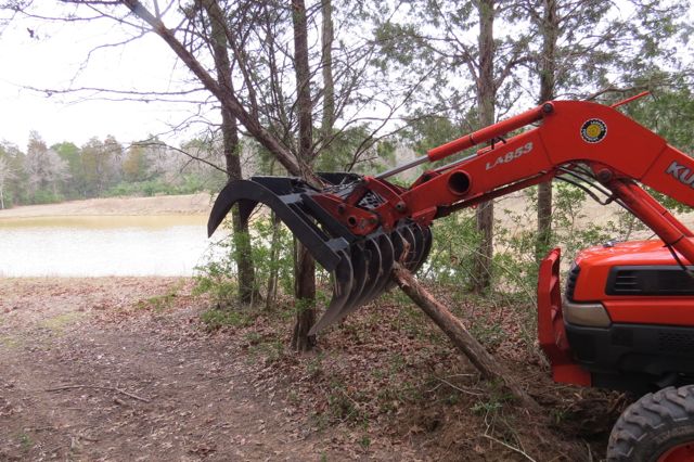

Medium size cedar tree removal with grapple:
First I loosen the rootball,
then I push the tree down,
then I pop out the tree,
then take it to the brush pile,
then run the box blade along the trail.

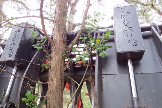

One more shows visibility with the lid open.

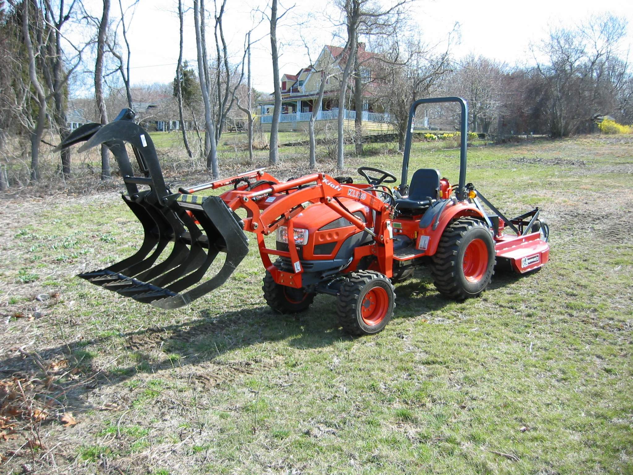

My opinion is xfaxman has perfect dimensions. I like the longer bottom tines vs. txdon's ( no offense) And when pushing a big tree down, I do the same thing but with my bottoms tines and the FEL elevated. Why use the more fragile upper assembly, that's attached to cylinders? The bottom tines are bombproof.
The longer tines give more capacity for brush. And I still believe one upper thumb is plenty, and two just adds weight, complexity, and is un-necessary on a narrower grapple. The human hand has one thumb and it works great. why two ?

Remember though xfaxman's grapple is a very heavy grapple meant for a Bobcat. I don't know exactly what it weighs but I'm guessing something between 600-800lbs or more than twice the weight of a light duty 48" grapple. There is a penalty to pay in net lift capacity for having such a heavy duty grapple. Not an issue if your Bobcat loader is rated for 4000lbs or whatever but for a typical CUT that would hurt net lift.
I was a bit surprised to hear that the bottom tines were as short as 24" on some of these grapples as they just "seem" longer than that. Perhaps my mental image of the grapple includes the backing/frame.
