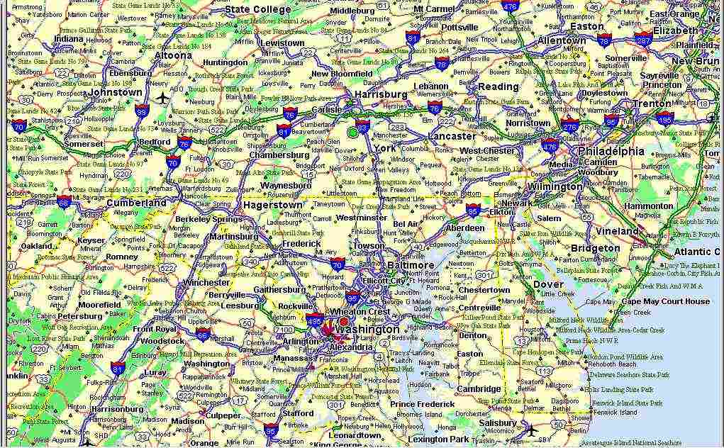

What about doing a screen print to the Clipboard and then pasting into your favorite graphics editing program?
Attached is a jpg file from Street Atlas. The original bmp was almost 2 megs.

BMP is the native format for windows. The reason it is used so often is that images are actually stored on the video card exactly the same way as they are saved in a file. Saving the image as a BMP in most programs is nearly identical to dumping the contents of the memory making the format easy for programmers to support. BMP is lossless, it currently does not support compression. Displaying a photograph using BMP is as good, from an image quality point of view, as any other format. Therefore, your problem is not the file format per-se.
If you are using a mapping software package that renders lines, arcs, circles, and background objects that make the screen have graphic as opposed to photographic appearance, then the program that you are using does not work in the same way a photographic rendering would work. The program would be storing instructions rather pixels. When it comes time to display the instructions, the program would determine the screen characteristics of your monitor (e.g. resolution 800x600, 1024x768, number of colors, etc.). Once this information is known, the program renders the instructions as a bitmap or BMP file consistent with the limitations. Therefore, if you have a low resolution monitor/graphics card, your saved image would be low resolution.
At first, when I read the post, I wondered why you would print the image rather than save it as an image file. However, in the case for graphic rendering, printing may make sense because the resolution of the printer is far greater than the monitor or graphics card. If the program is smart enough, it will adjust its’ graphics rendering engine to the printer resolution, yield a far higher resolution picture. Most printers today have a real resolution of at least 300 dot per inch, so a rendering to the printer at 7 inches x7 inches x 300 dpi inches gives you at least 2100 pixel X 2100 lines, a reasonably high resolution image.
Now, if we assume that you are rendering graphics, and not photographic materials like aerial photos, the authors of the program could have allowed you to save an image to disk at whatever resolution you wanted as easily as they programmed for printing.
Therefore, I think you ought to see if you have the ability to change the saved file’s DPI, that is the effective resolution of the output device.
