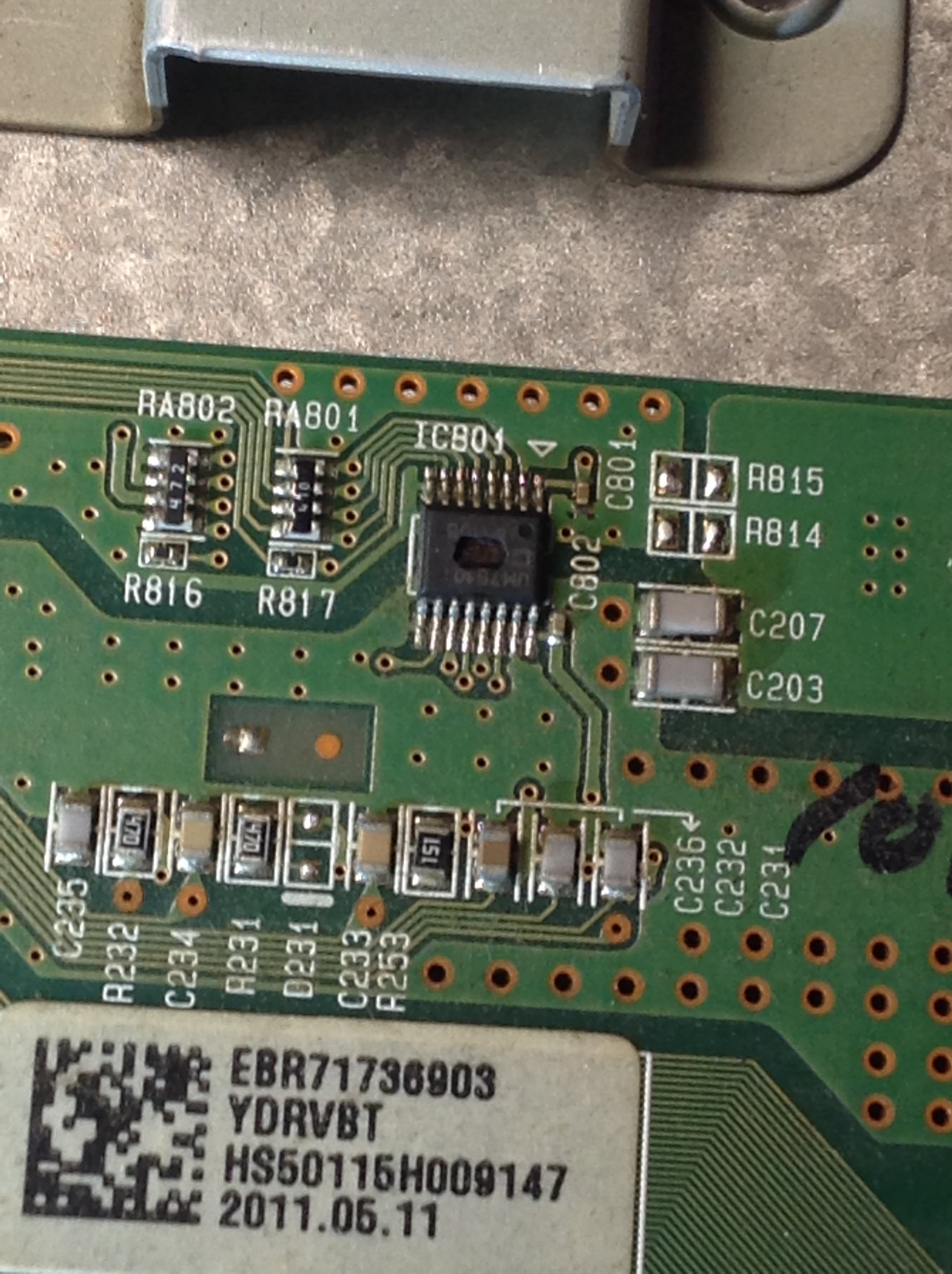

Cool. want to replace this chip for me?
It is surprisingly easier than you might think. Step one get some Chip Quick and the rosin that comes with it. Spread the rosin on all pins up close to the body of the chip. Take a flat tip, yes a flat tip on your about 40 watt iron. NOT a pointed tip as you would think, but a flat tip that will spread the heat between several of the pins at once.
Now introduce the chip quick "solder" which is a special blend of solder with a very low melting point and is slow to freeze because it is formulated with special alloys. Float it on to both sides an and do it several times until both sides are molten. Take your tweezers and pluck the chip off of the board. Now take your solder sucker and/or solder braid and clean up the board and the traces.
Very carefully place the new chip and get it perfectly aligned. using a light touch use a good lead based solder to tack down one corner pin. Flood all of the other pins with liquid rosin right up next to the chip body. Checking carefully that all pins are still aligned. Now taking the same flat tip, flow solder all of the pins while pulling the solder outward to the ends of the pins. You solder multiple pins at once, the solder will flow because of the rosin. Carefully inspect all pins with a good high power glass to make sure there are no bridges.
Reflow any solder bridges after adding more rosin, re-inspect. Take a Q tip and 91 percent isopropanol and carefully clean up all of the rosin. Carefully inspect.
That is how you do it on the cheap if you don't have a hot air rework station. Chip Quick is available at Amazon and will do several chips for the $12 kit.
