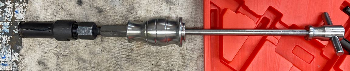

This is what was successful for me before for small bearings with little space under them

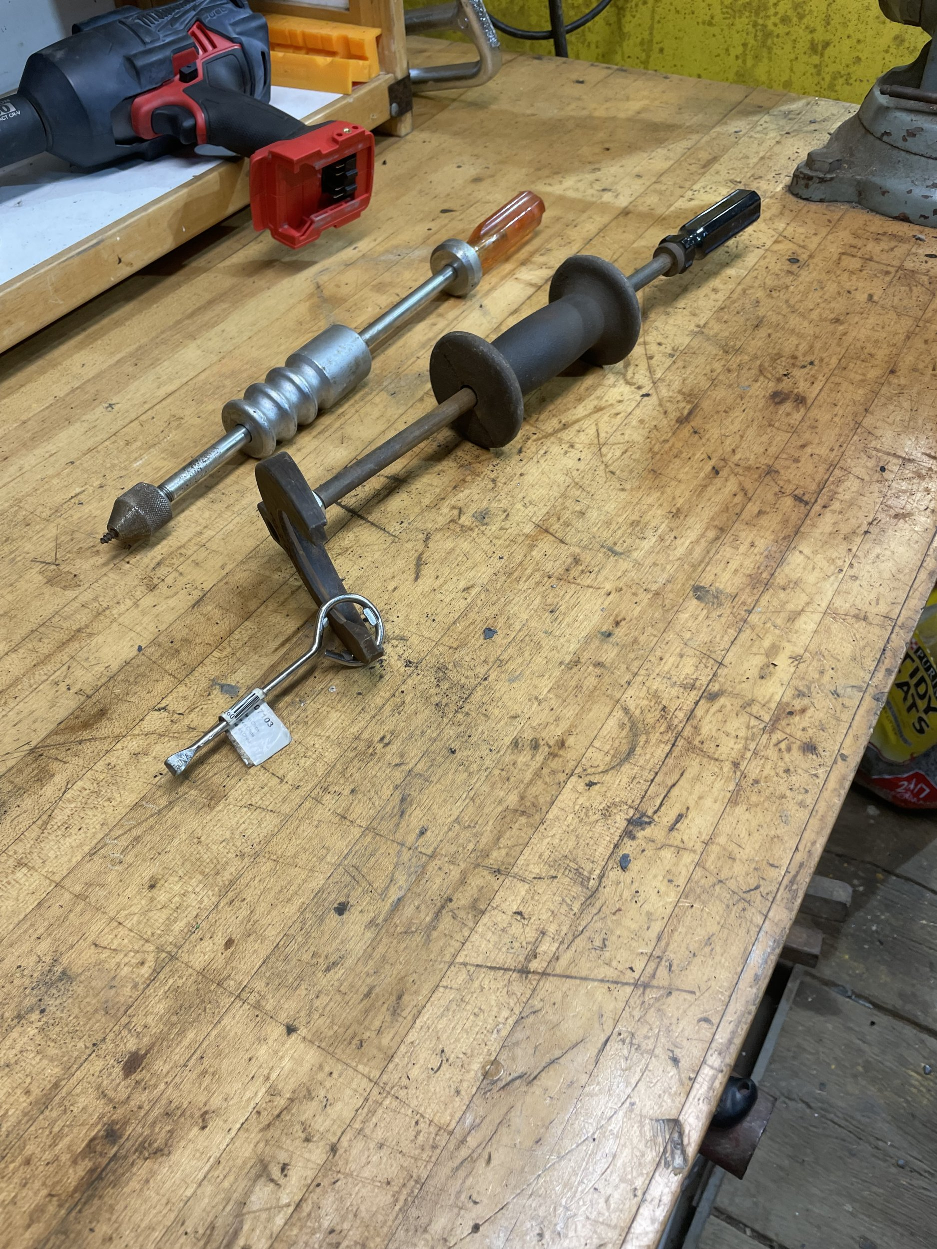

OK, here's a pic of the bearing/ case.
Turns out, I have a blind hole puller set like the one in the link I posted earlier:
Doesn't seem like it would need much of a gap behind the bearing to get a pretty good grip. It also uses a slide hammer, so no need for anything pushing in the center:

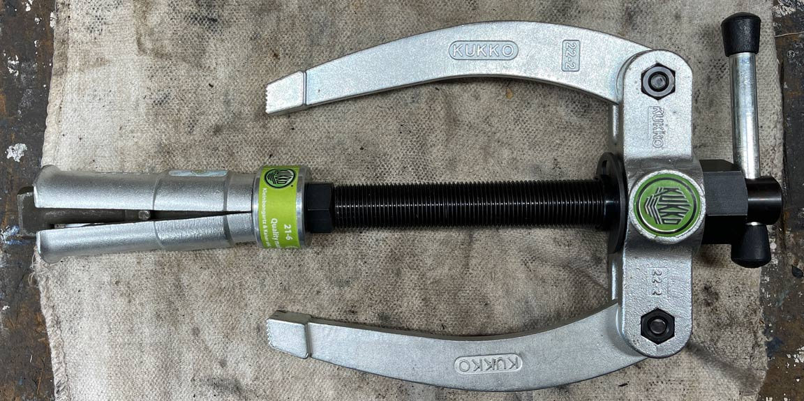

That kind of puller can also be used with an external frame like this one:
Those legs are arranged to push against the boss that surrounds the bearing. Doesn't seem like HF has knocked off this design yet.
