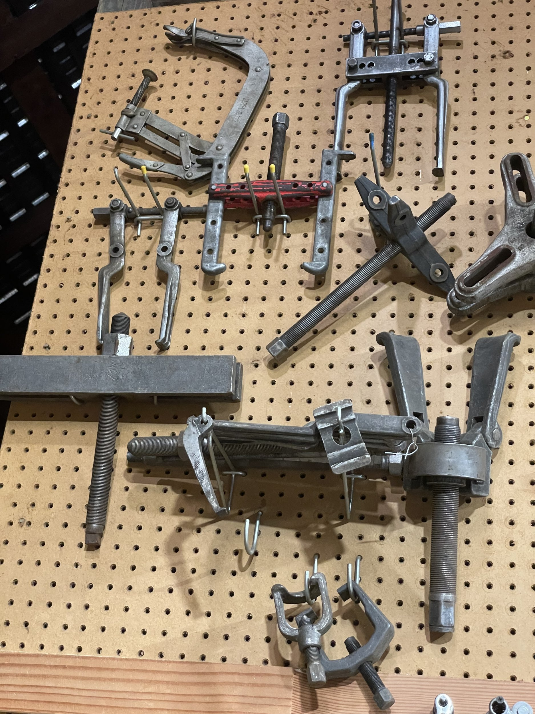

Here is a pic of some of my pullers. The arms are reversible on some of them to pull out inside bearings

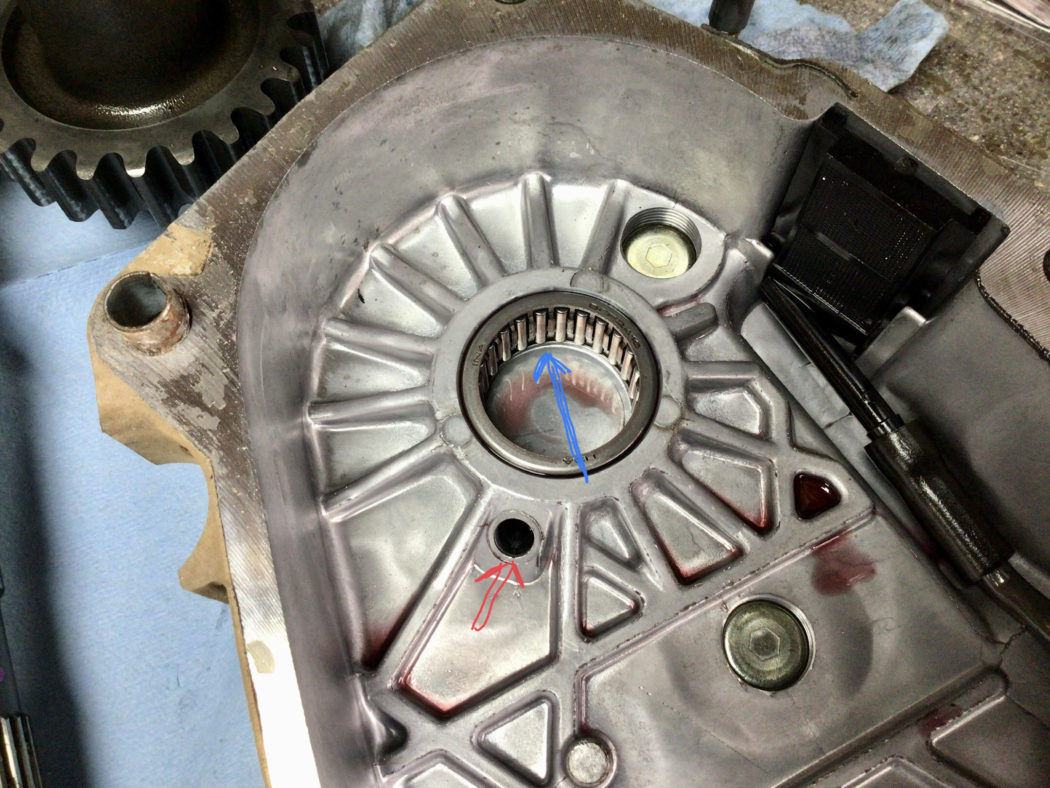

Thanks for the input on getting the bearing out. Unfortunately, the grease trick won't work..... there is a 3/8" oil channel off to the bottom side of the cup.
RNG, I have that bearing puller set. Unfortunately there is only an 1/8" of space under the bearing race, so no way to get the "cross arm" behind the bearing.
M7040, I have similar pullers, the type that screw down in the center won't work because the center pressure screw just punches out the back of the aluminum case.
I'll go out and take a pic.... It will explain the predicament.
   / Good morning!!!! #155,796
OK, here's a pic of the bearing/ case.
The red arrow is the oil passage that feeds under the bearing.
The blue arrow is the very small space under the race.
Can't push against the center of the cup... this is a pic of the backside, it's only about an 1/8" thick aluminum.
Any other ideas? .....

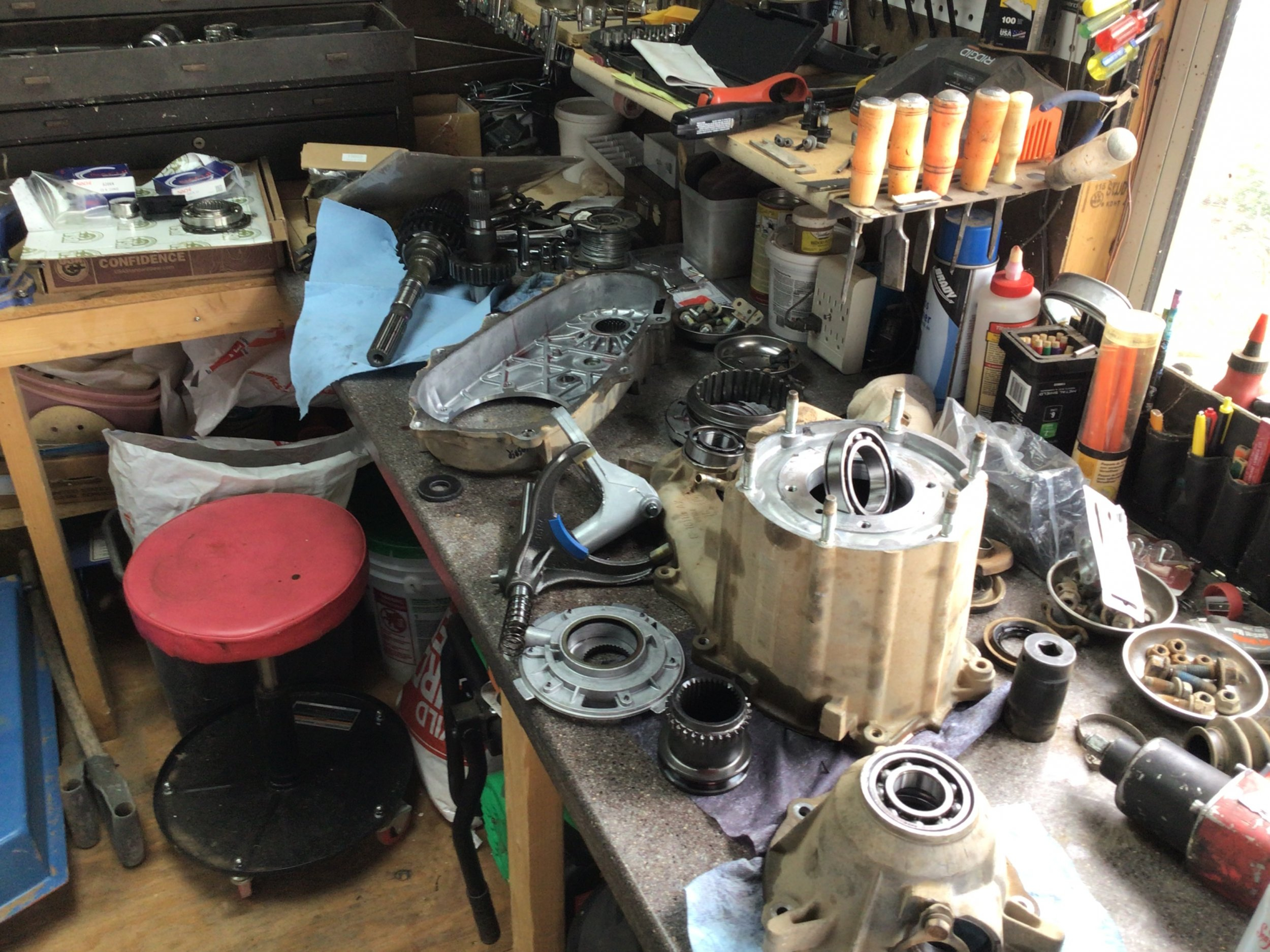

Just throwing in a pic of the mess.....

The best way I have seen work is the heavy grease method,
pack it full of grease after finding a wooden dowel that just barely fits in the bearing.
With the bearing filled with grease sharp raps on the dowel with a hammer will usually hydraulically push the bearing up and out.
Also once it's partly up then the expanding jaw pullers will also work.
   / Good morning!!!! #155,798
LS, what I would do is make up a rod and weld on or forge a hook that can go under the race and then use an old hammer head to slide on it and weld a big nut on the end to hammer against. Also heating the case with a torch will lose the fit due to differential expansion

You can also on the bench grinder modify the end of the rod to create a lip that goes under the race and then bend the other end to hammer against
Have used this before successfully
