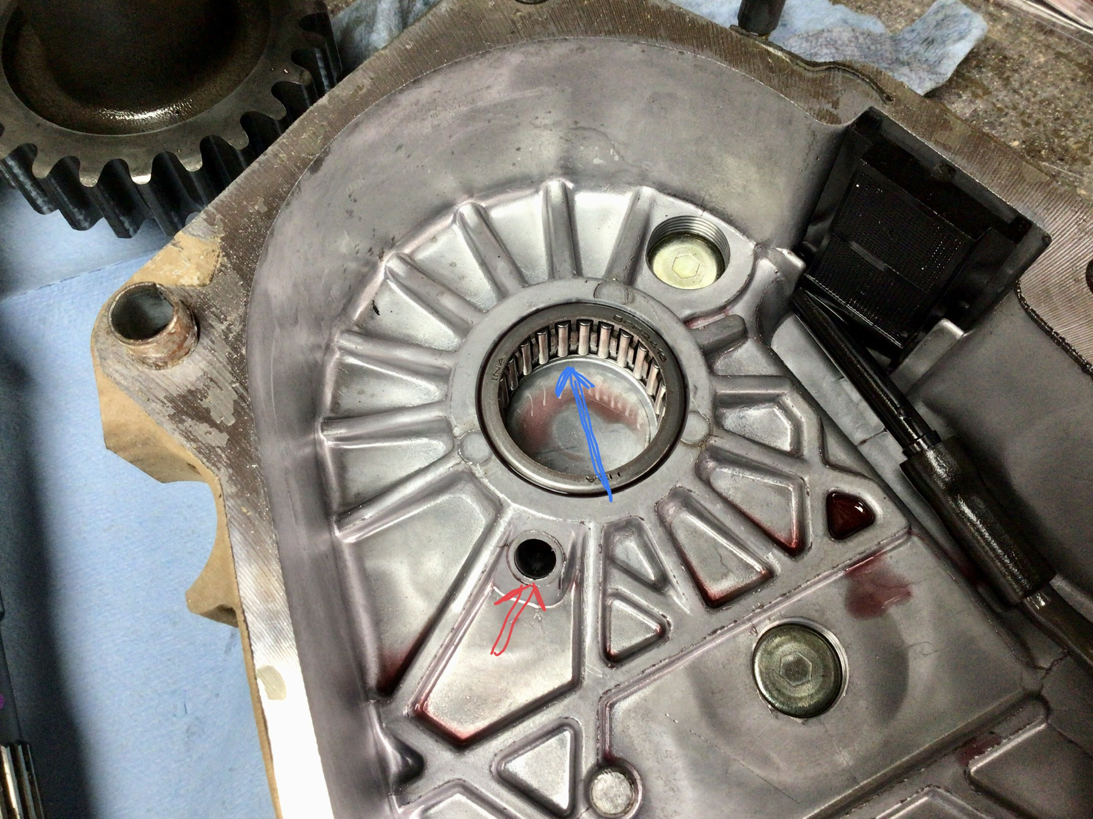

OK, here's a pic of the bearing/ case.
View attachment 762005[/ATTACH]

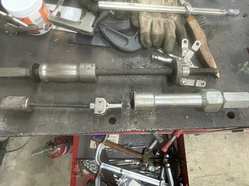

I went to the toolbox to take some pictures before RNG posted that a blind hole pulled is the solution.
My suggestion to try grease was based primarily on cost of tools. Blind hole pullers aren’t cheap, they are pretty size specific and then you need to set up a bridge or slide hammer to do the actual pulling. There is an example of a blind hole puller on the bottom right. A small slide hammer with internal expanding jaws might work, the jaws in the one pictured expand outward when the screw is tightened.
However, the pictured tools are all SnapOn, and I’m sure painfully expensive in todays dollars.
If you have access to a lathe, you could make an internal puller pretty quickly if you already have a slide hammer.

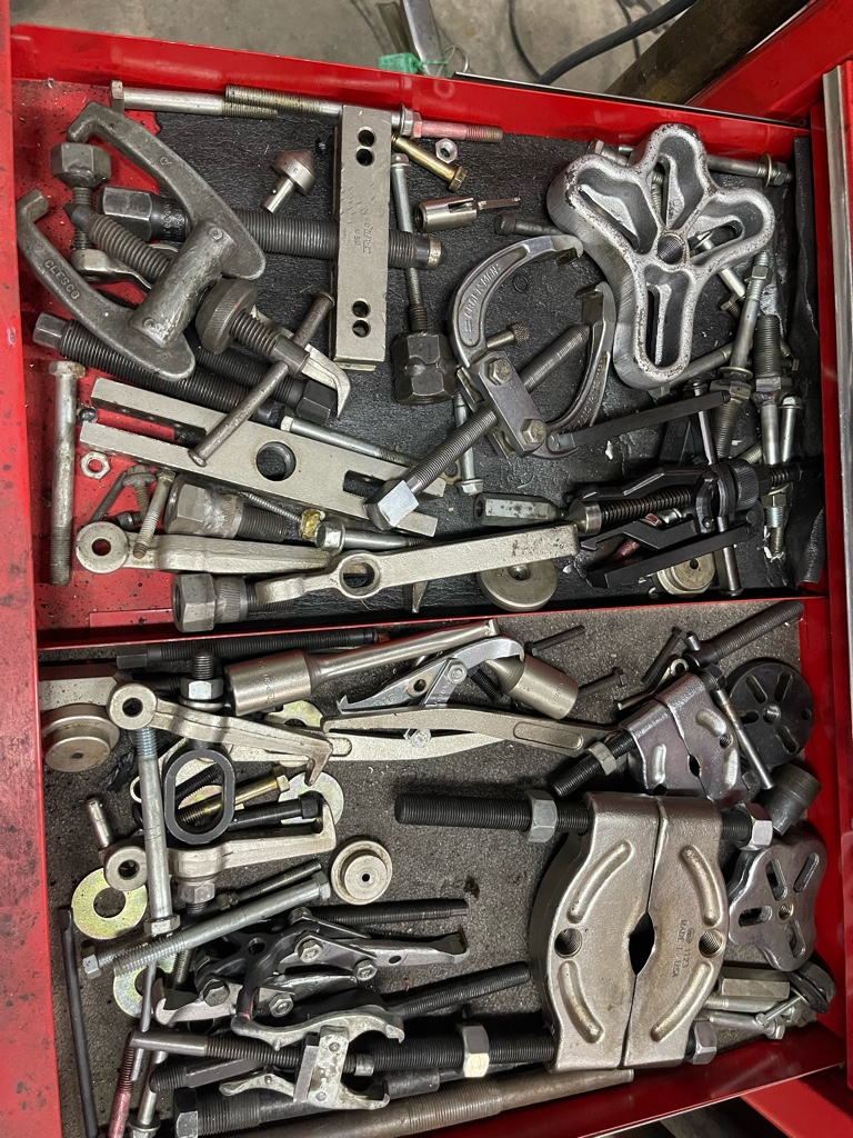

Here is one drawer or puller bits to be fashioned to do a lot of tasks.

Agree they are not cheap. I will try other solutions before going that route
Plugging the oil passage and using grease would be my first choice
I would be worried about using the grease pressure as the aluminium housing cannot take the pressure needed to push a bearing like that out. The housing will break out first. It would be cheaper in the long run just to buy the correct puller than a new housing.
   / Good morning!!!! #155,833
SUCCESS! The transfer case is reassembled, ready togo back into the Jeep tomorrow.
I went to HF and got another "mini" 2 lb slide hammer wit very small puller arms. Fought for about an hour, the little arms kept popping off the race. So, used pieces from my other pullers, made and external frame, and slowly applied the pulling pressure. Left the pressure on and heated up the "cup" the bearing was in. POP! ok, it moved an 1/8".... repeated 3 times and out it came!
Thanks for all the suggestions, it was a true mix of many great solutions.
I looked into getting a real 'blind hole puller'..... they are seriously proud of them... ranged from $450-720. Ridiculous! I don't do enough to warrant those prices.
RNG, I was mistaken.... I have the axle bearing puller set from HF.... I noticed that one was made for pilot and needle bearings ---- it would have been the correct set. Unfortunately, the local store didn't have one anyway.
There was definitely something awry with the transfer case before the rebuild. Now everything spins easy and quiet. Now just to get it back into the Jeep.
