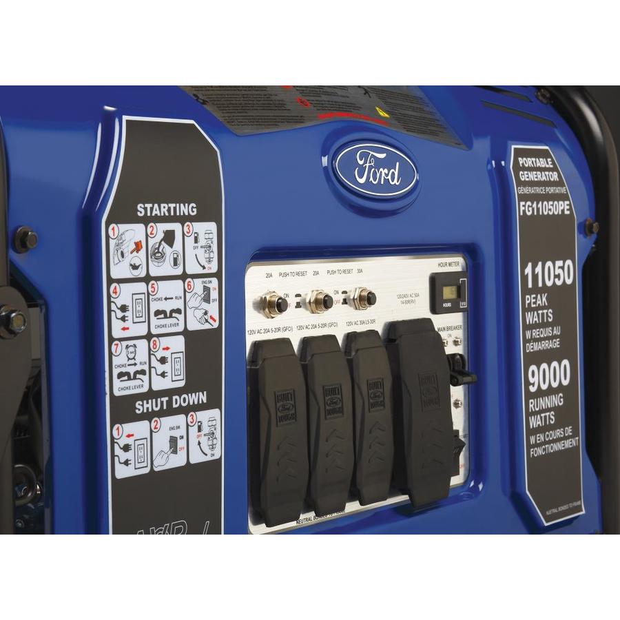

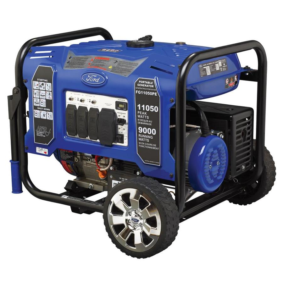

When did Ford start branding generators?
https://www.lowes.com/pd/Ford-11050...Portable-Generator-with-Oem-Engine/1000791494
Labeling in that picture shows 7500/6000W on LP, but the listing is for one that states 10500/8100
   / Generator Selection? #335
Anyone can brand a product under another name. This unit is a pulsar manufactured product made in asia... probably china.
supposedly uses a Ducar engine , i remember running one in a gocart years ago.
than again, ford probably isnt made in usa either anymore.
