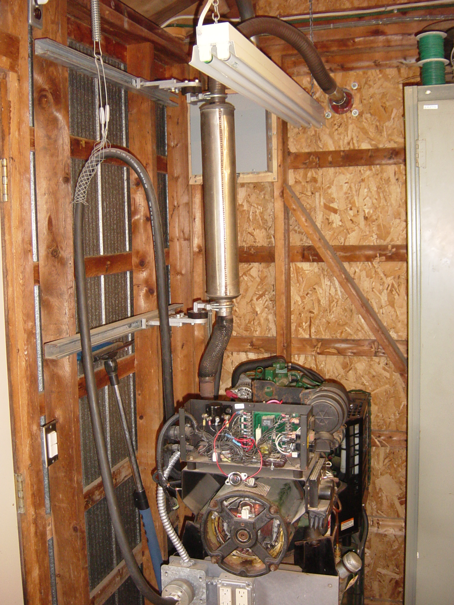

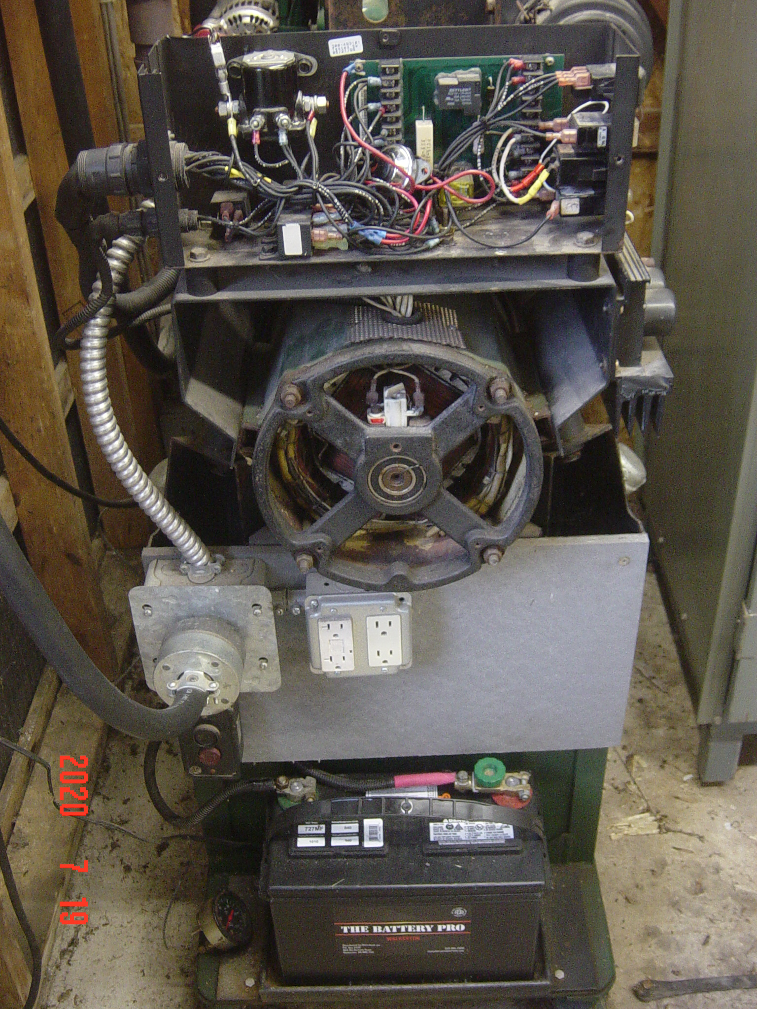

7.5 KW, Onan/Kubota set that is currently my primary backup.
Current Project of Mine. Onan Quiet Diesel 7.5 INVERTER. So quiet, you could sleep in a room with it, and NOT because it's in a box.
Peronally, I don't trust the electronics at all, but am willing to try it (mostly for night time and summer (low load) use. I have backups if it fails anyway.
