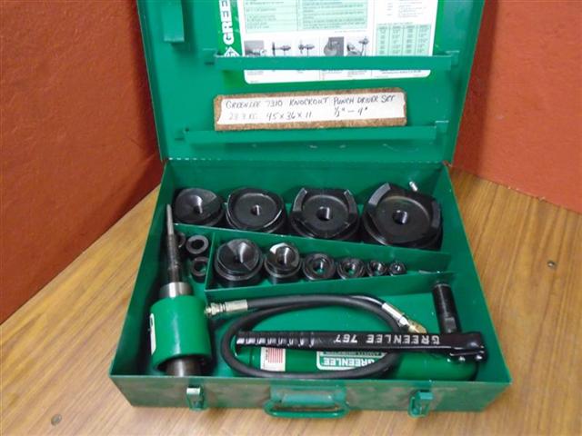

i always remove guts Before drilling. Mind you i have a hydraulic punch kit similar to this
that punches holes from 3/4” to 4”. But still have to drill pilot hole. But unless you have 1500+ to waste...
Go hole saw.

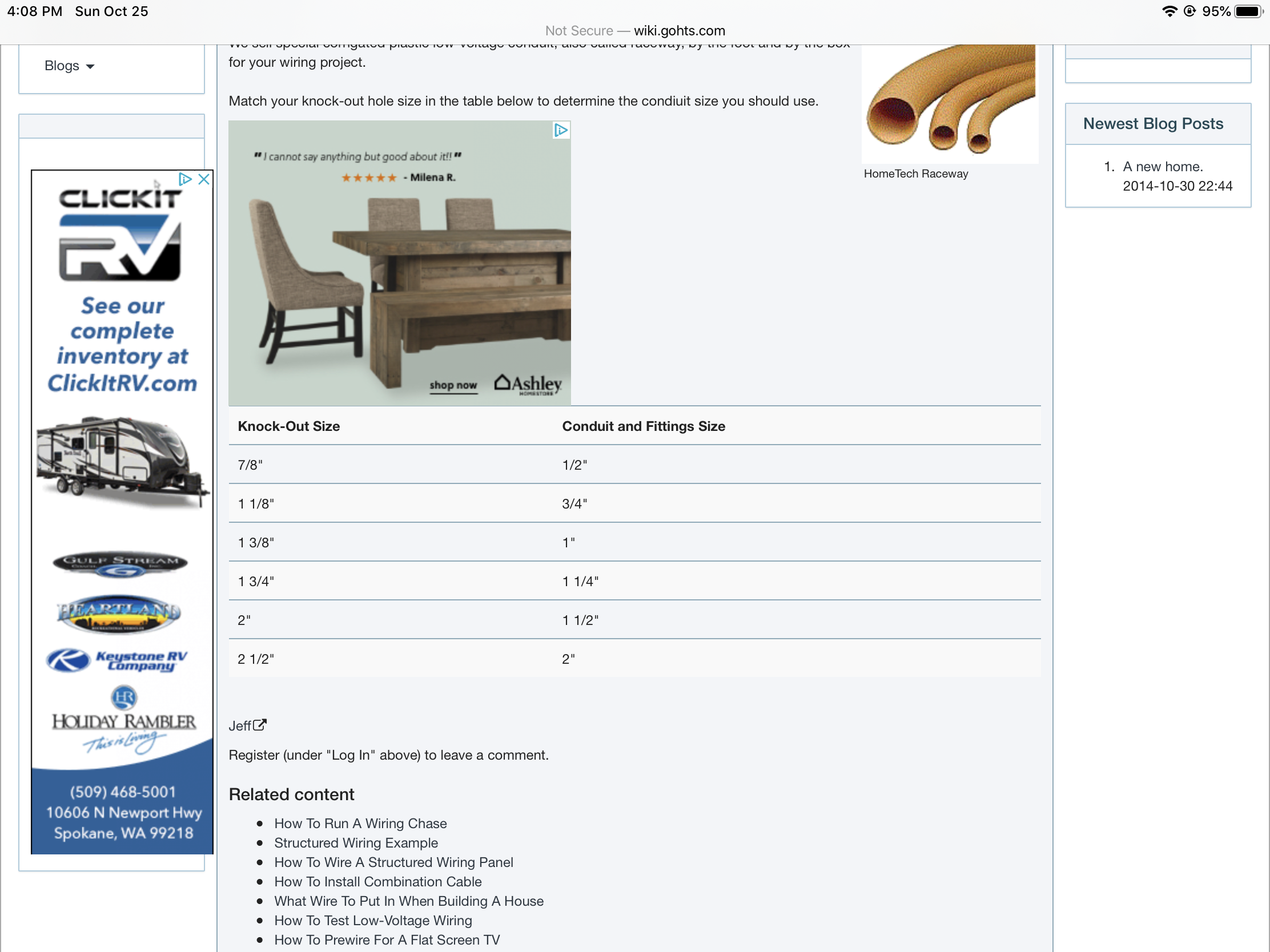

Personally, if your never have use for 1-1/4” hole later on, just get a hole saw. Make sure you size it to the thread.....not 1-1/4” hole.
Im not sure how accurate the following chart is, so measure actual fitting.

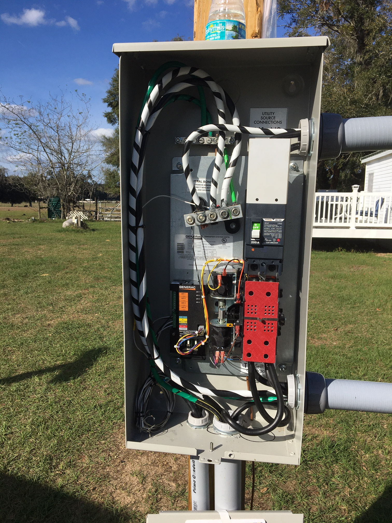

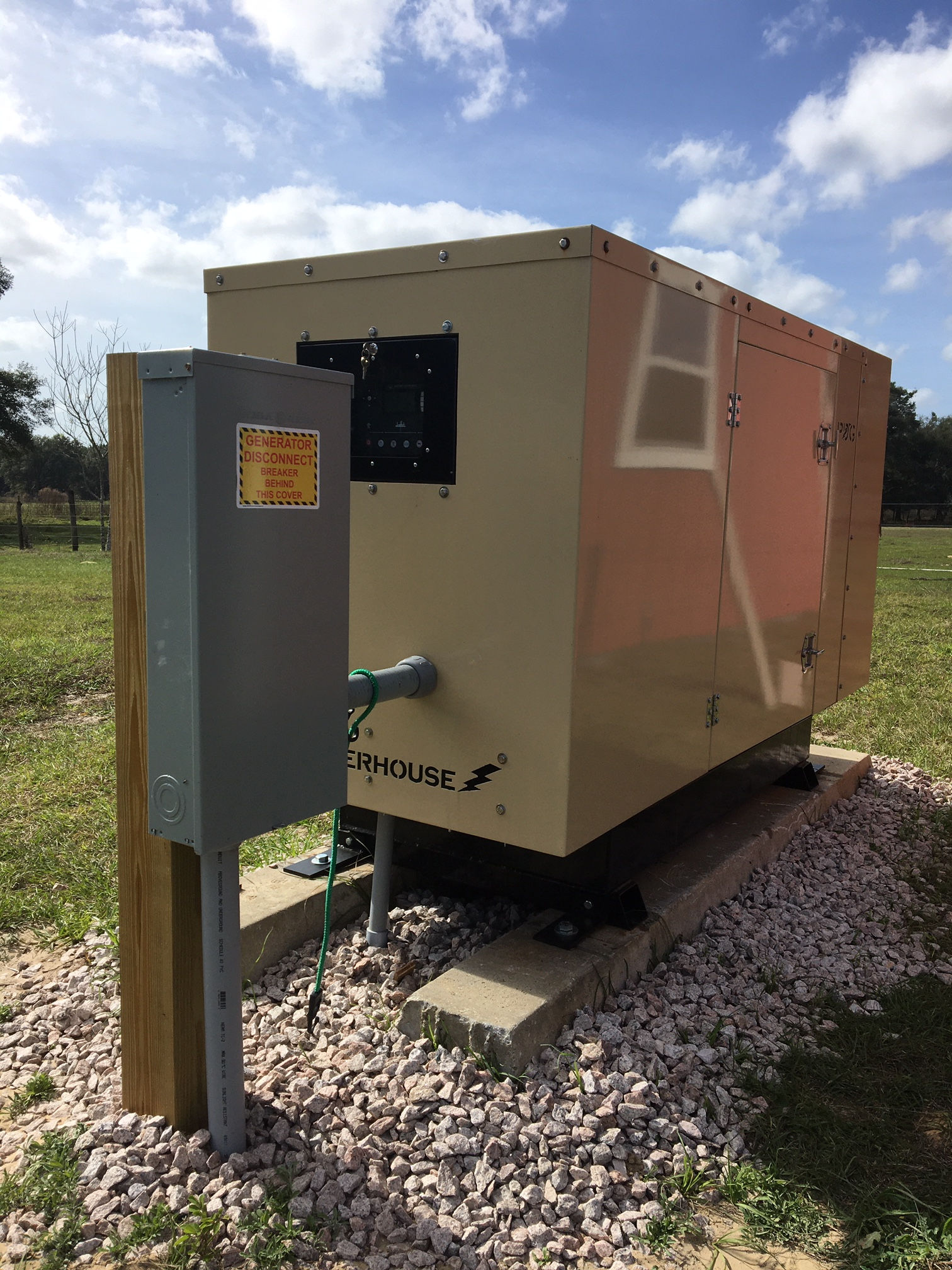

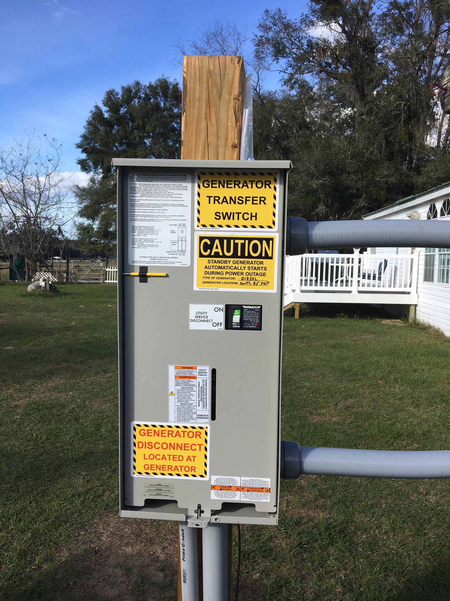

It doesn't need to be modified, only takes two wires 12vdc and ground.
Here the pics of a 36kva I designed, this is so quiet you can talk standing right next to it, only pain was getting it hurricane certified, as if that thing was going blow away.
