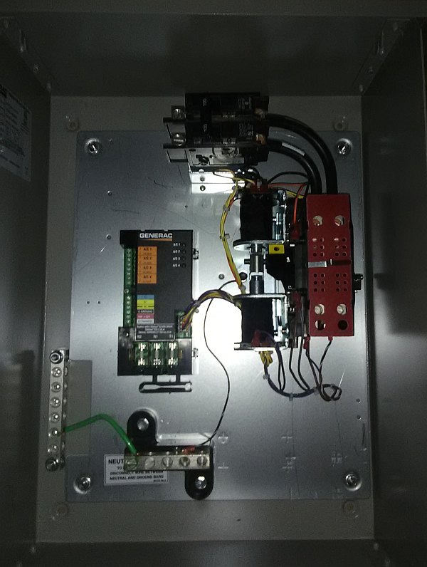

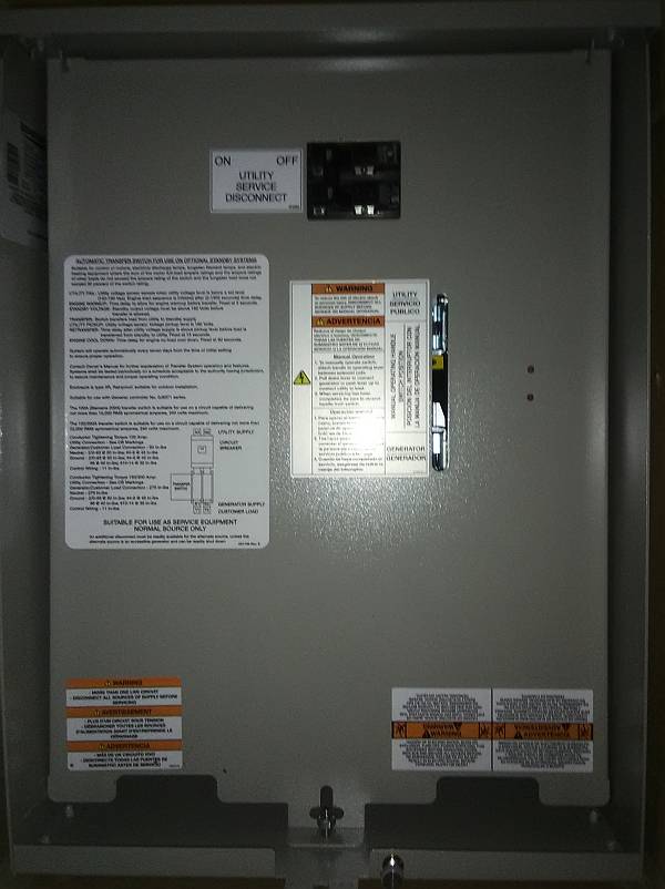

ATS showed up. Didn't expect FedEx to run today, but they did.
No knockouts in it at all, so now I need to find hole saws that will cut holes for 1-1/4" fittings in metal. Have a cheap HF set, but will have to see if they're metal rated.
Need to check with my local dealer first thing in the morning on the other two brands before I do anything more though. My guess is that now that I have it, I'll probably keep it and stay with G unless a compelling reason not to shows up. Now I guess I need to explore the 14 and 18K units. Drat.
There is a metal rod that inserts into the hole in the yellow tab to enable manual switching between sources.
674295d1603642427-generator-selection-deadfront-jpg
674296d1603642443-generator-selection-guts-jpg
I wish there would have been a better explanation of what 'suitable for service entrance' meant for us that aren't familiar with the term. I didn't really need the extra 100A breakers in here since I already have a set in the main panel and another set in the new disconnect I just installed. This makes three sets which I hope won't be an issue.

>> is there any warranty related reason I cannot remove the entire backplane with all components intact so I can drill/punch holes for conduit without risking getting shavings in the components? Looks like the four corner nuts and ground cable will free it all.
>> Is there any reason I cannot, or should not mount this to Super Strut used as stanchions embedded in concrete? Wiring would then be in either rigid or sealtight. My exterior wall construction would make wall mounting complicated.

Unless it voids your particular warranty, removing inner panels is pretty normal.

Service entrance means you can feed it directly from the meter can, then take the output to the old service panel. Zoro.com sells individual punch's. The cheap punches bind, so drill 1/4" then open with step drill then install punch. It will tilt cutting on one side, loosen rotate 90' and tighten again. I install a 200 amp panel for a 36kva diesel genset.
