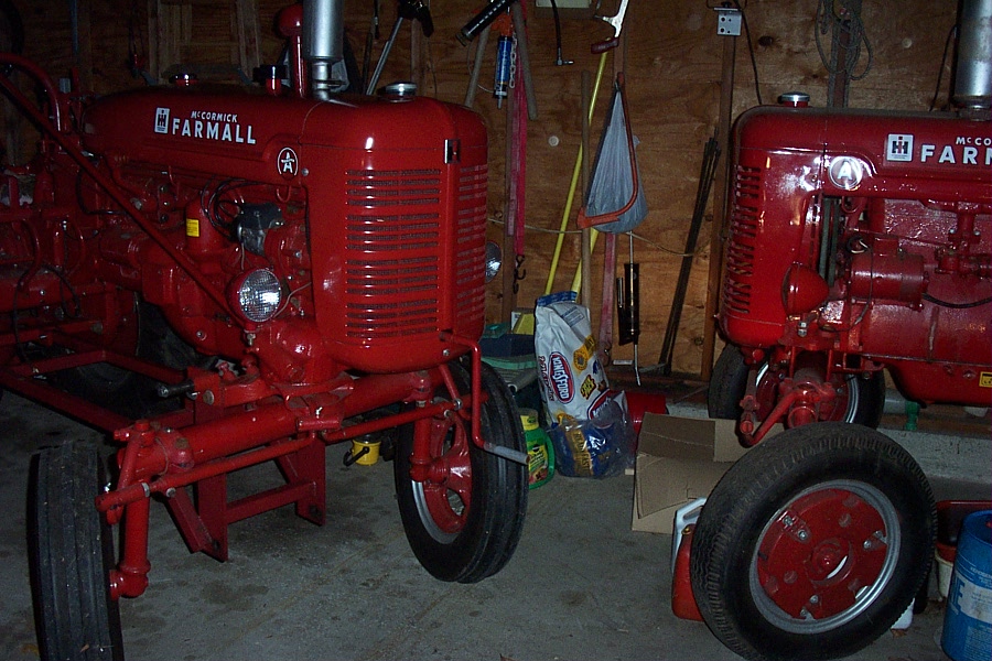

REAL MEN drive gear tractors with HAND CRANK to start. If you got and use an electric start on your tractor then you are just a poser and should sit down and shut up and let the BONIFIED REAL MEN with crank start lay down the law to those upstart HST kids.
Pat
Good Evenin Pat,
Absolutely agreed !!! :D:D:D
Darn, should have disconnected those darn electric lights first ! :)

Good Evenin Pat,
Scotty, For you I will make an exception. You can comment on my transmission (and spinner-no spinner) even though you have electric lights A_N_D those high maint rubber tires.
Thanks for the pix of really nice old tractors.
