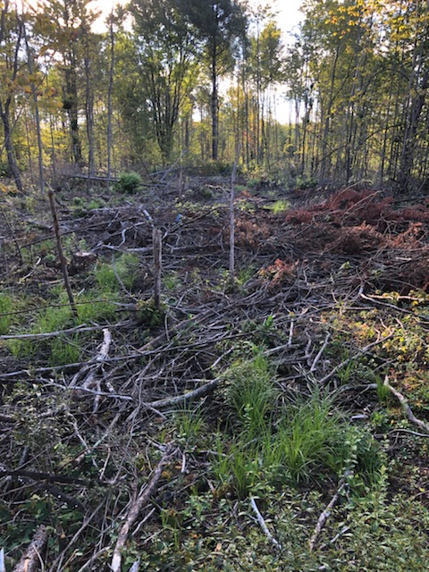

This is what my woods looked like after the logging . This would be why I got the Grapple . I have learned that a tractor is not a bulldozer in any way shape or form . You can do many things but pushing these piles is not one of them . Even with a Grapple you can grab a whole pile but if the tops are 20 ft long and under the next pile the tractor will tip . I often grab the pile but then use the pole saw to cut the ends off . I'm in no way trying to push you towards my Tractor size . Bigger with Ag tires will do better but for the money saved I can buy all the good implements I need .
All this research is FUN :)
Thanks for sharing, that’s exactly what I was figuring I’d have to do with it, grab some and cut it into a more manageable size. I’d like to build some hugelbeds with all the leftover wood in tandem with the tops to act as screens and funnels so being able to lift and maneuver and stack some decent sized logs is a must. You’re right though it is fun talking through all this stuff with everyone, I’m enjoying learning more and more.
Great photo!!! you've got some work there, albeit fun work!!!
