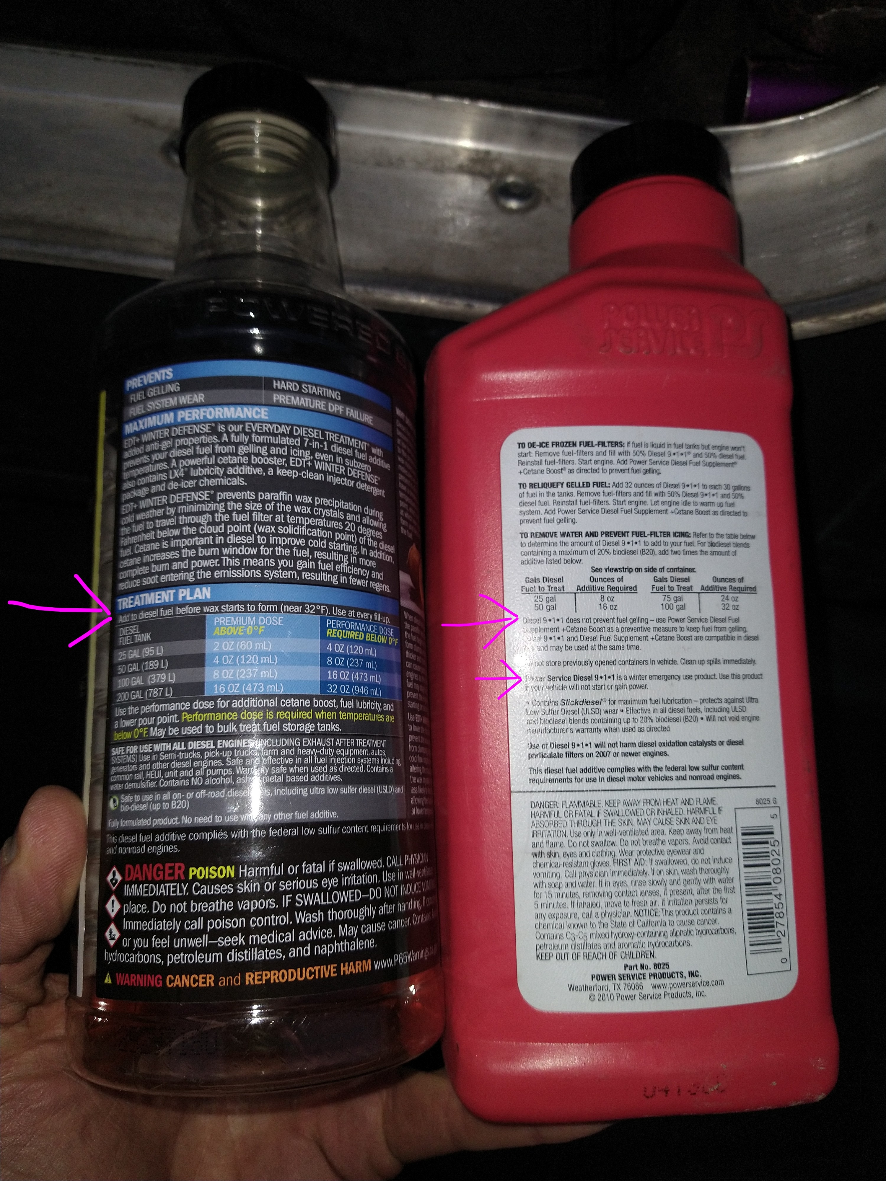

Here are two bottles ... HotShots Winter Defense on the Left, Power Service 911 on the right ... I just pulled out of my side box.
Basically says to mix anti-gel at 32°F+ and the 911 is not to be used as an anti-gel, it is for emergency use of non-starting engines ...
I have never used 911 ever in 34 years if driving, but use anti-gel ... I carry it mostly if another driver has a problem ...
