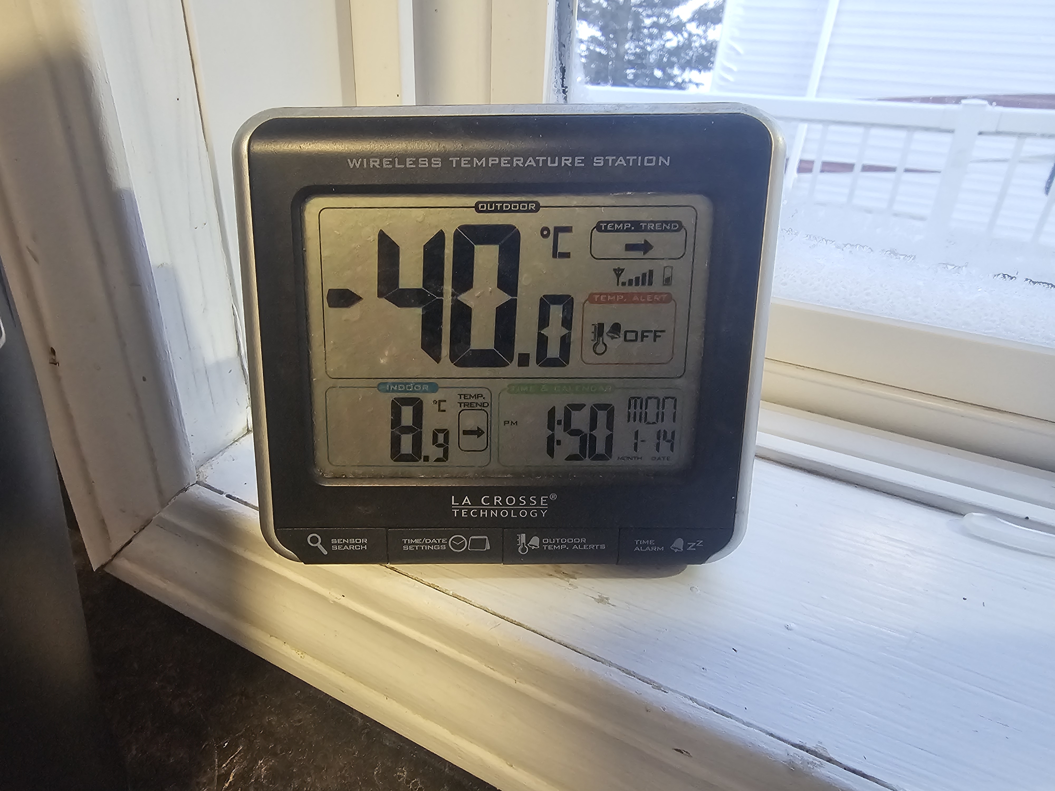

View attachment 4830654 it gets so cold in thd Prairies that we need to prevent our propane from Liquifing. I use my L5240 in this weather sparingly. I wahted til it was -25C to plow the driveway. Its hard on them for sure. I feel sorry for you folk that don't usually get this cold. Be prepared and stay warm.
Hey that's almost as cold as -40F.

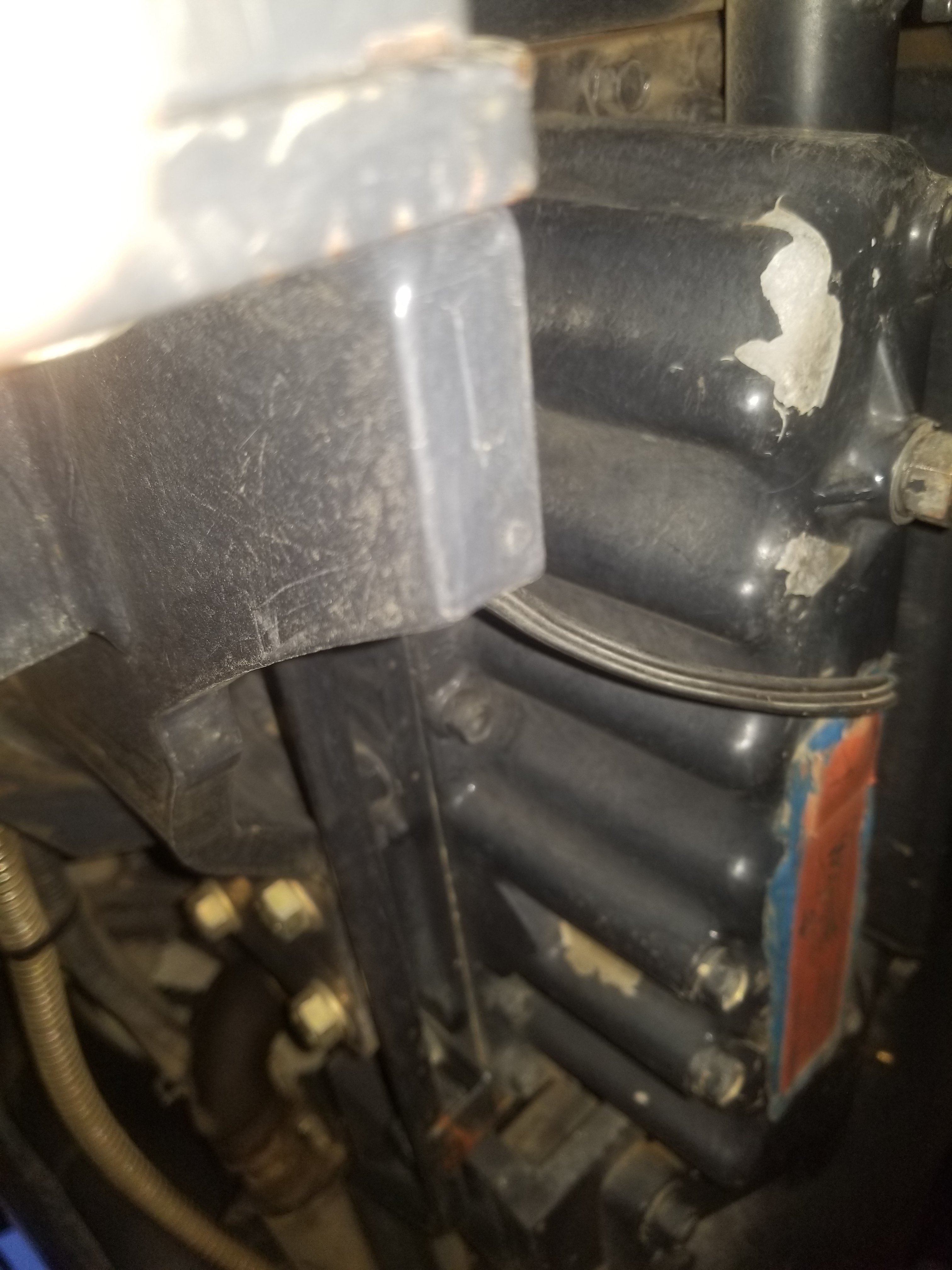

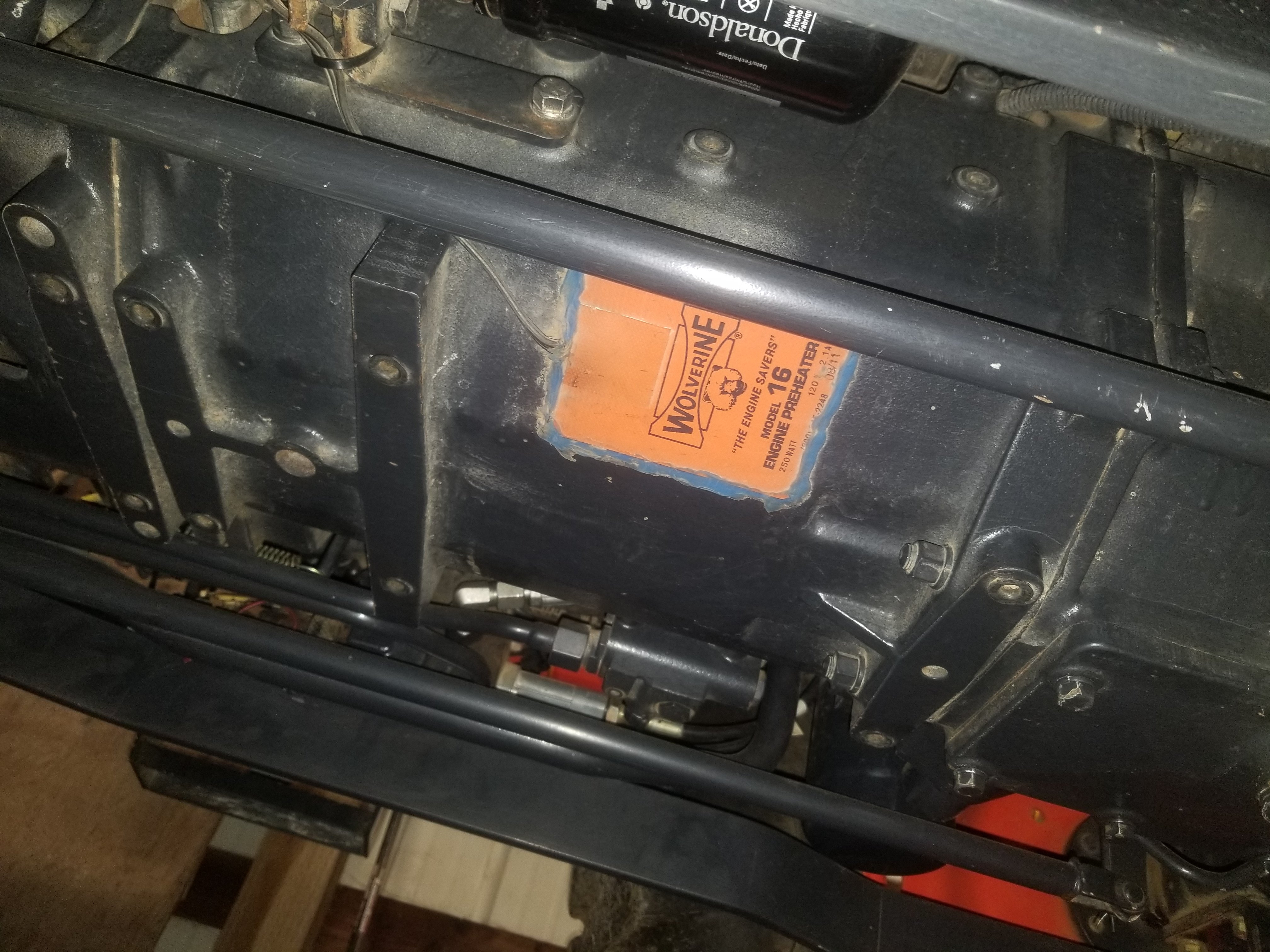

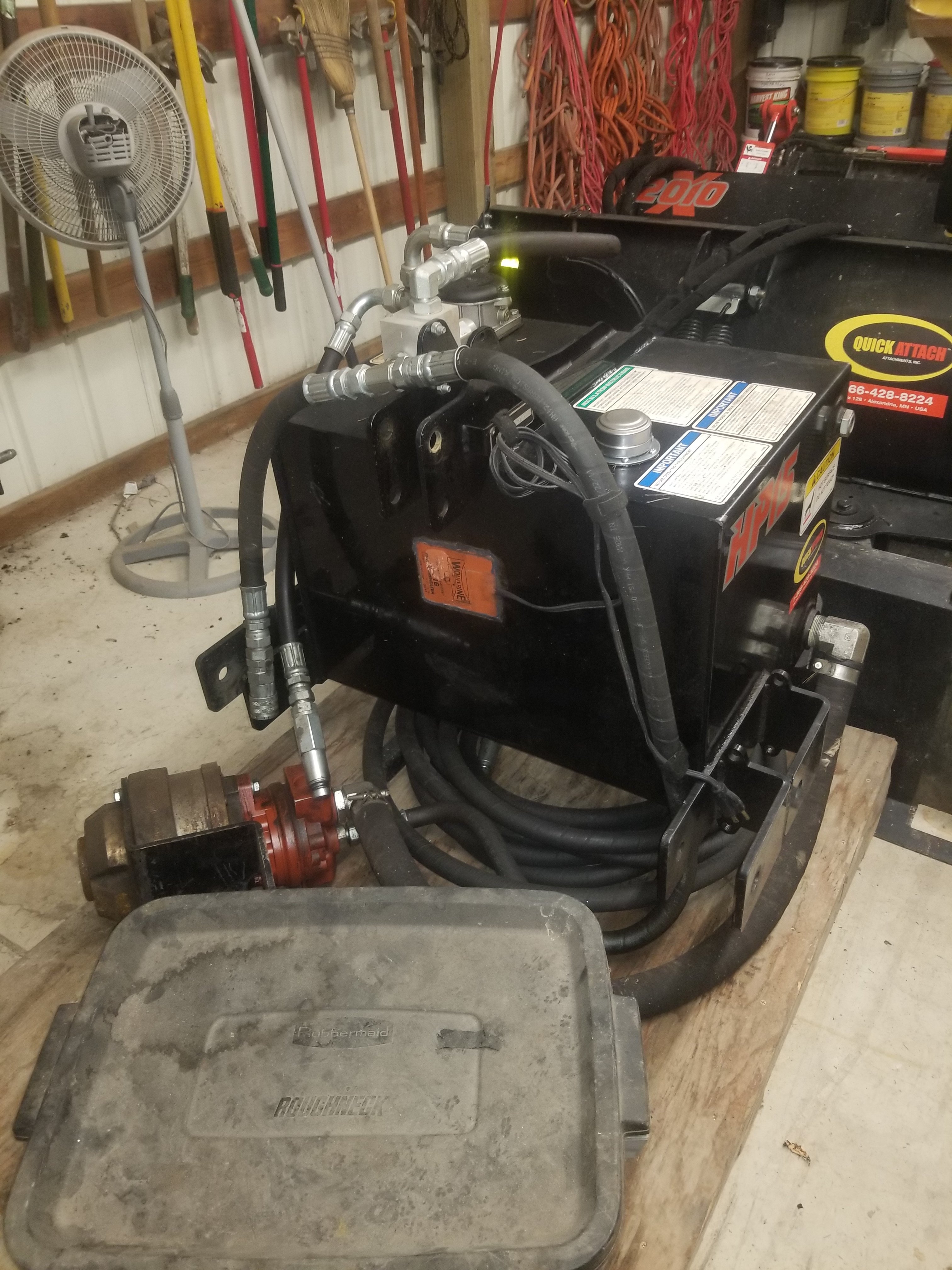

I have a silicone heat pad on the oil pan and one on the transmission. Plus one on my 25 gallon hydraulic 3 point tank.
These hook into a wifi plug that i can control from the phone. I can either turn them. On manually or they can follow a schedule.
Weather turns cold in north idaho….though strangely not this year.
Has never let me down.
But i did replace the glow plugs late last year. Only 1 of the 4 were working when i ohmed them out.

Not really. -25C = -13F. -40F = -40C. Still cold, no matter how you measure it.

Just out of curiosity I wanted to ask, just how well do those little tiny silicone heat pads work? I guess they must be okay since you mentioned/showed/and use them - but it seems like they are so tiny they can't be of much help?
/ Extreme cold #114
Ive been using them since 2010, and the tractor starts alot easier when i use them on very cild days.mi can place my hand on the tank and the heat is obvious.
Okay, Thanks for the positive feedback Grs. Good to know those "tiny" heat pads function as well as they do!!
