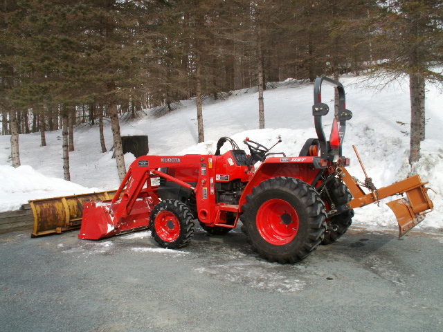

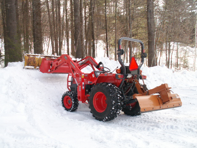

I have that setup and like it a lot :) rear blade pull snow from buildings etc. scrape driveway down to gravel,front blade plow and push snow banks way back.

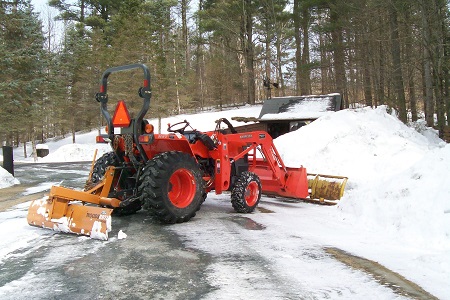

I have a rear blade and use the loader to shove the piles back. In previous winters when I was a lot younger I used a front end loader for snow removal, so I am no stranger to that system.
My snow blower didn't get on this year. My arthritic hands won't allow me to work with cold steel, cold nuts and bolts and cold tools.
I am curious as to how you have the plow blade attached to the bucket? Can it be angled? Looks like a neat set up.

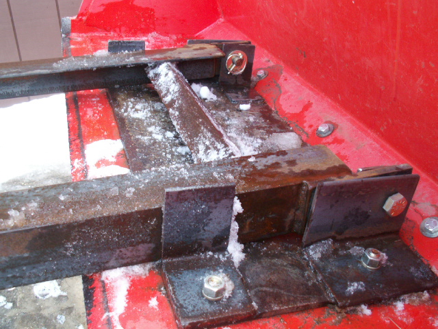

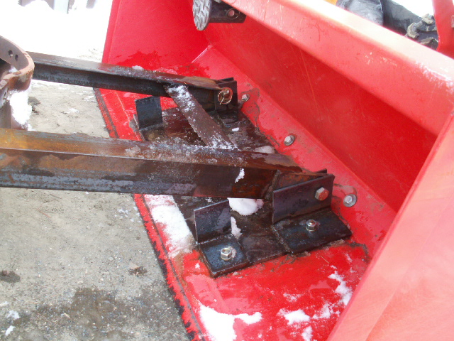

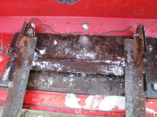

Made with 1/4" steel.
Bottom plate from cutting edge to first curl in bucket,piece 1/4" plate added to bucket back side for strength.
Frame fasten in place with 4- 5/8" grade 8 bolts.
Front of frame weld 1/4" L's for support less stress on frame bucket when pushing.
2- 3/4" grade 8 bolts for pins.
Plow ears/pin holes have 2- 1/4" L's.
Manuel pin swing for blade setting.
Plow $100,Iron etc. $60.
7 years done everything I ask of it and more.
