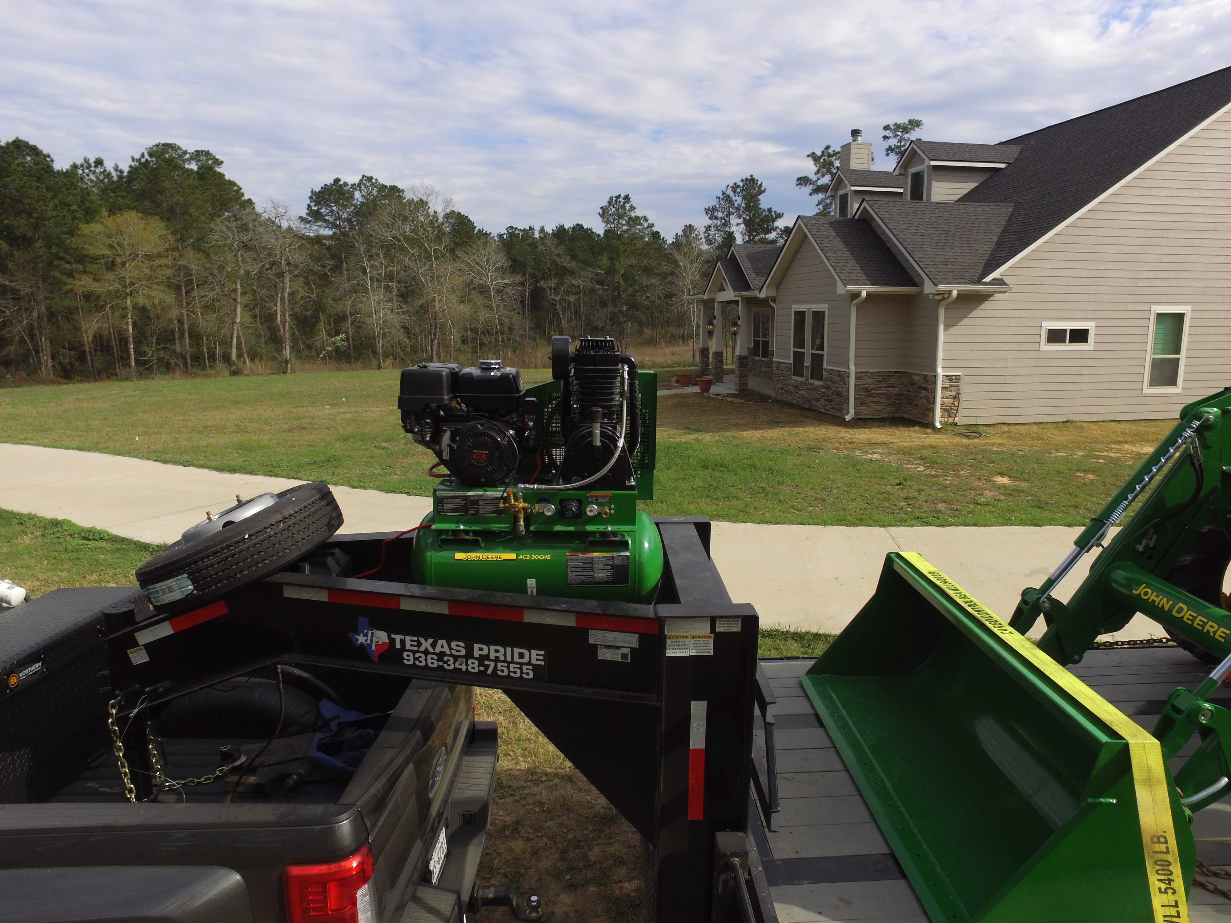

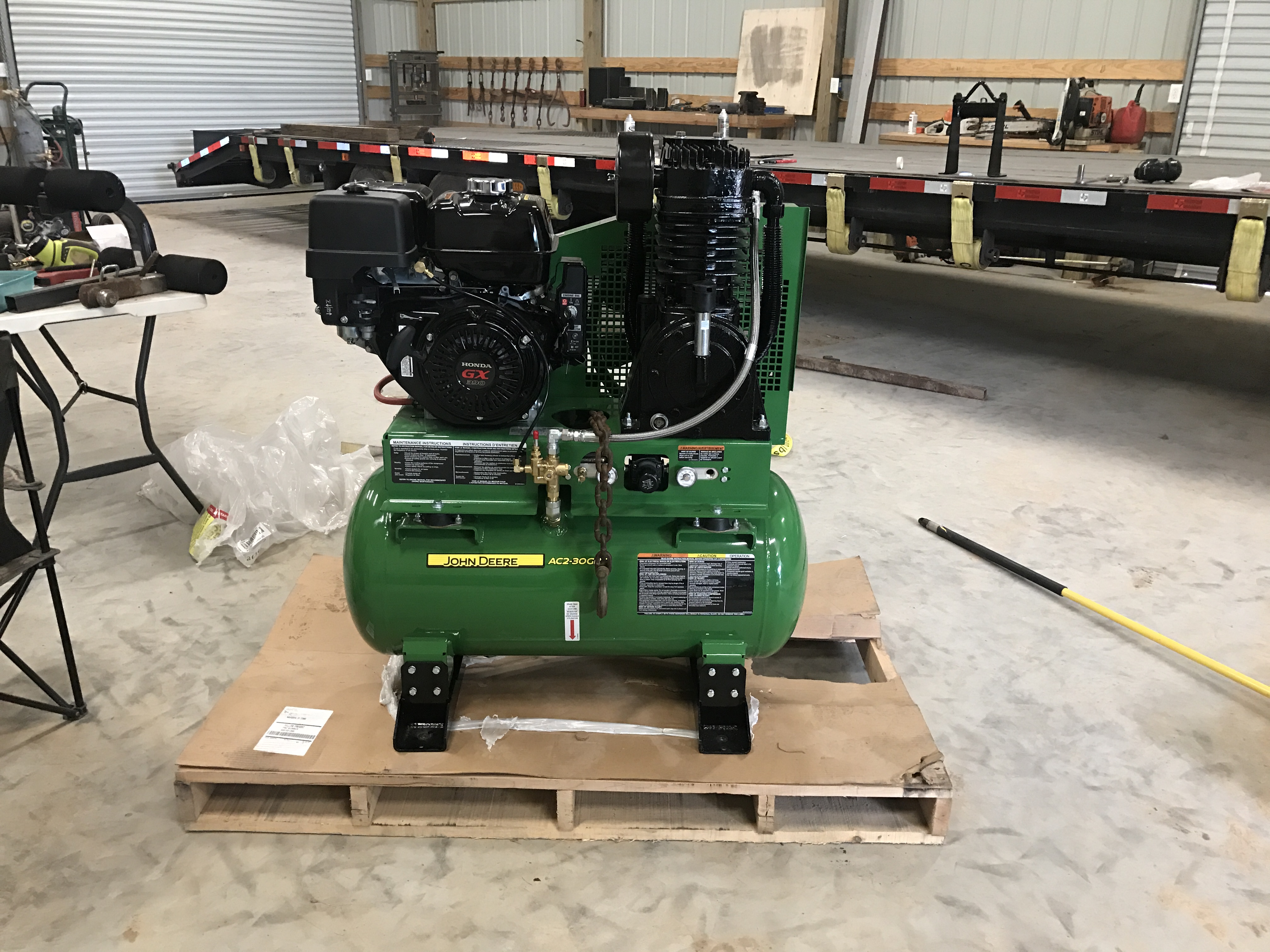

I have a engine drive Deere compressor. Made by mi-t-m. It is 29 cfm at 175psi. Puts out a ton of air. 30 gallon tank. I think it would be more than enough for your needs. Has a great Honda too. Elec start gets it going quick.
Brett

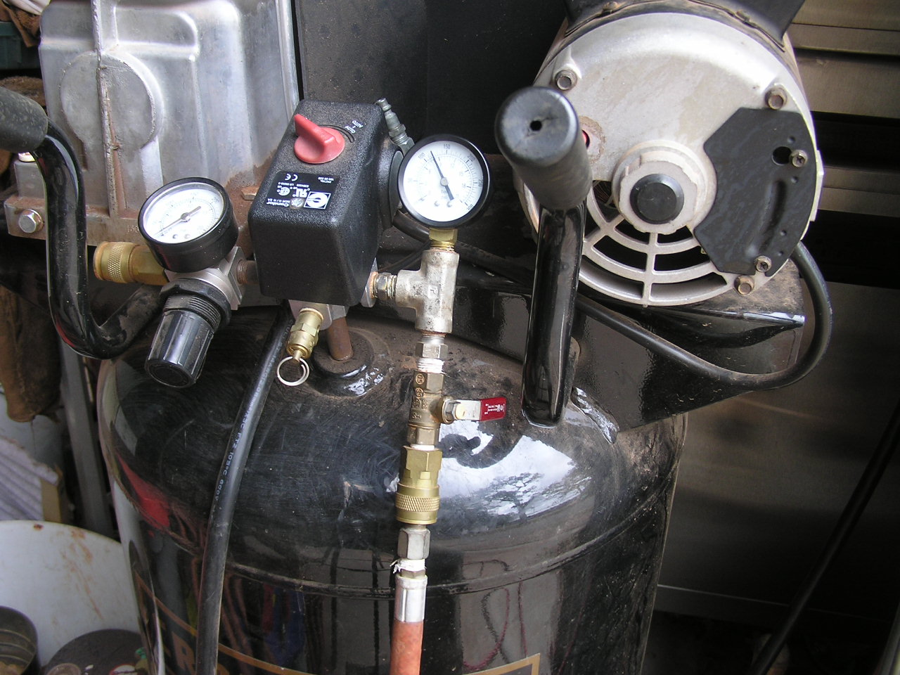

It sure wouldn't take 5 minutes to fill from 20 to 100 psi. You need to set the regulator above 100psi or its going to take minutes for that last 10lbs to fill.
I bypassed the regulator for filling tires. Unscrewed the tank pressure gauge, added a tee, cut off valve and a quick connect:
