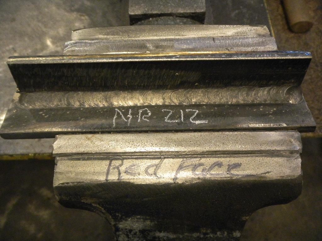

That is very true with dual shield. And a lot of the gas-less fluxcore as well. Here is some NR-212 I ran, all the slag and splatter came right off with a wire wheel on a 4-inch grinder.
