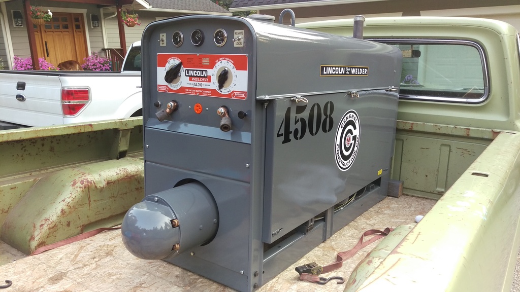

Oh there is nothing like old iron! 1948 Lincoln SA-200 Short hood. :D
Show off !!:)
Keep that up and I'll have to send you my two for "spiffing up" :D
Terry

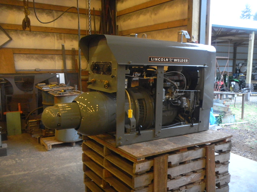

I just did one for a friend of mine. 1963 Lincoln Red face.
