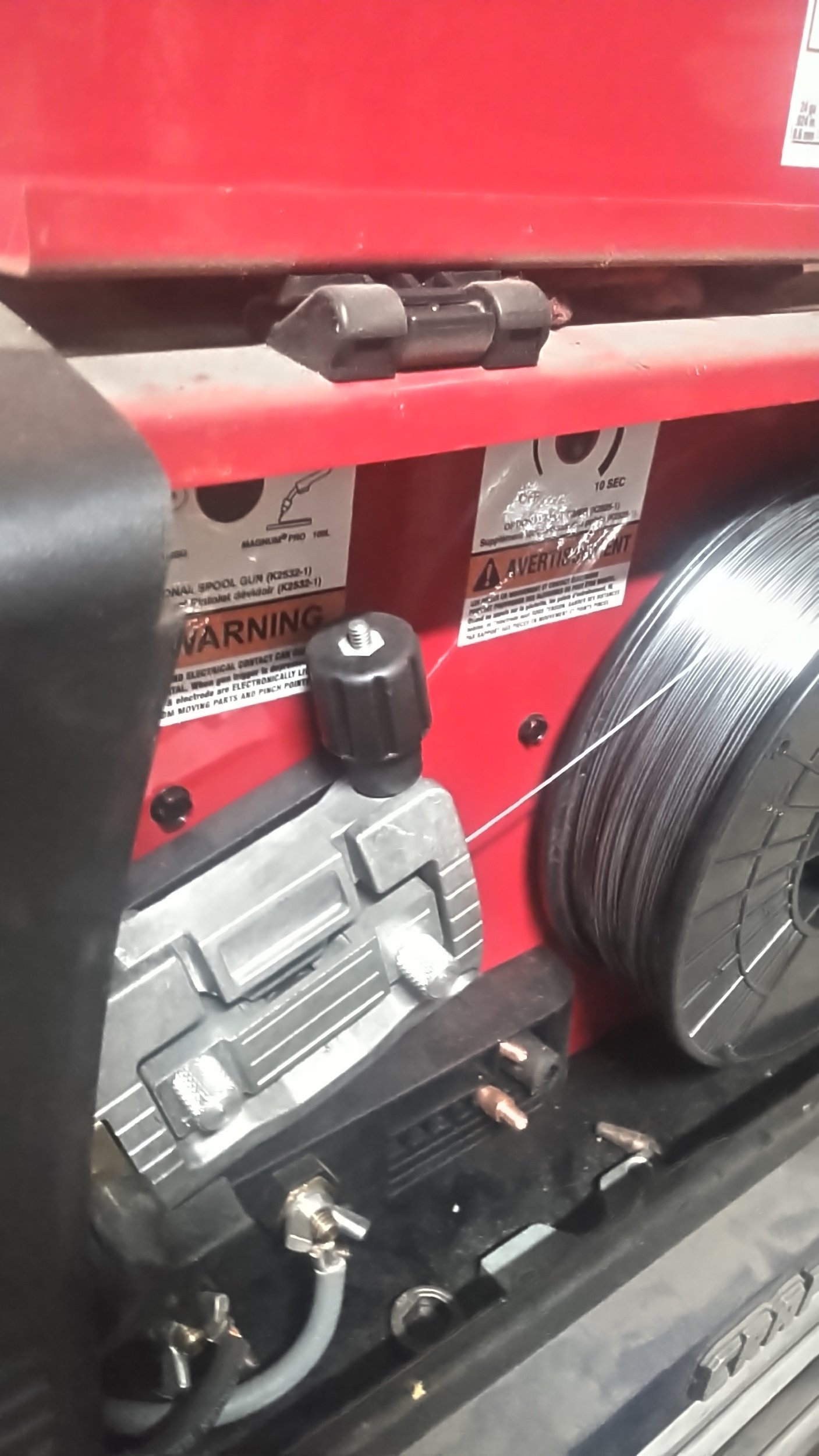

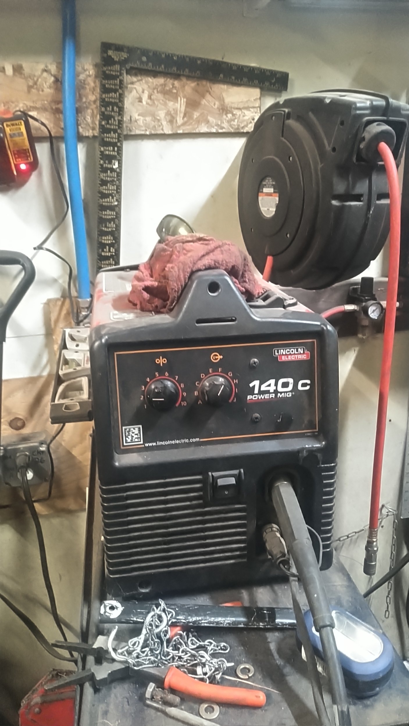

So I have a Lincoln 140 c has infinite amp and wire speed adjustment about 10 yrs old. Never worked correctly like my old Lincoln 100 or 125 amp with infinite settings. Tried big and small rolls of various brands mig/ and flux core wire, currently have .035 flux core in it. Changed out feed rollers multiple times, they are the knurled ones currently, cleaned out liner played with all settings infinite number of times. I'm at a loss. It will produce a decent arc initially than seems like it's cutting out or cuts back almost like I'm trying to weld rusty or non prepped steel. Yeah my old smaller Lincoln ran and worked flawless forever and I'd hit the auto shutoff for duty cycle frequently, unfortunately gave it to a buddy. Suggestions what to test and look at are appreciated at this point I'm all ears.

Try flipping the polarity on it. I had a lincoln once that you had to flip the polarity one way for fluxcore or the other without flux. It is the two connections in the picture under the tensioner

Thanks for the input, tensioner is cast aluminum I believe, liner is steel it's definitely not the lesser caliber of a HF welder. No gas, and polarity is correct. It's a heavier transformer welder with limited use cuz it never worked like im used to unfortunately it was purchased new at a charity auction or would have been returned yrs ago. Finally tired of looking at it and feel the need to do something with it.
So run it like I'm mig welding? Always thought flux core is reverse polarity, which it's set at currently. I did double check after your post including the connections all are tight and corrosion free with no signs of arcing. Darn thing still looks new in there lol. Btw I've tried mig on it with a tank and polarity changed to normal does the same thing.

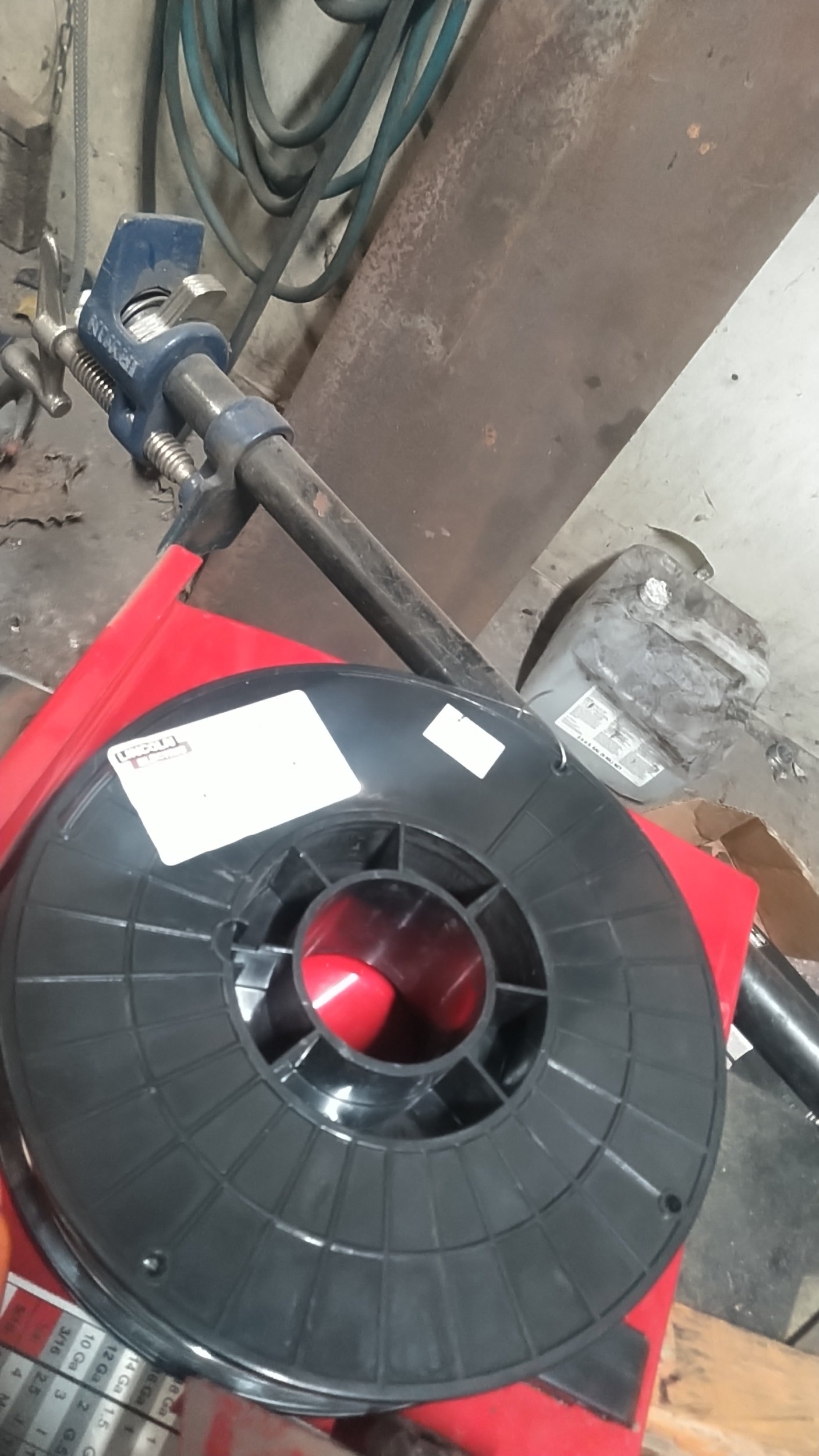

Brief update, visually re inspected capacitor, transformer, and circuit board all visually still look new. However after removing a ten pound spool of FC wire it appears after running welder at various wire feed speeds it visually appears the electric electrode drive motor only operates at one speed unloaded without it pulling wire off the spool. Going off memory on other welders on full wire speed that motor should be rotating much faster and it seems visually to be on one speed. So possibly the circuit board, wire feed rheostat, or maybe the wire drive motor? More testing to follow after I purchase a decent new multimeter.

It may work better with the small spools of wire, the big roll may be to much on the spool motor.
/ Junk Lincoln 140 C ??
#18
Yeah I've tried 2-10 lb spools same thing every time. I now strongly feel there's something wrong with the wire feed mechanism either the rheostat, motor, or the circuit board, it was stuck on the same speed without pulling wire than it started working properly. I'll look into testing some of the wire feed components. Problem is wire feed issue is intermittent as I just recently discovered.
