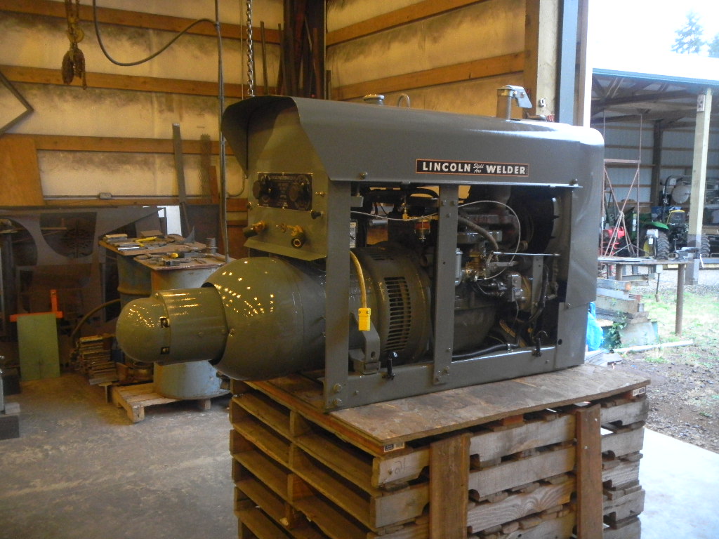

/ First time welder type suggestions. #20
Oh there is nothing like old iron! 1948 Lincoln SA-200 Short hood. :D
