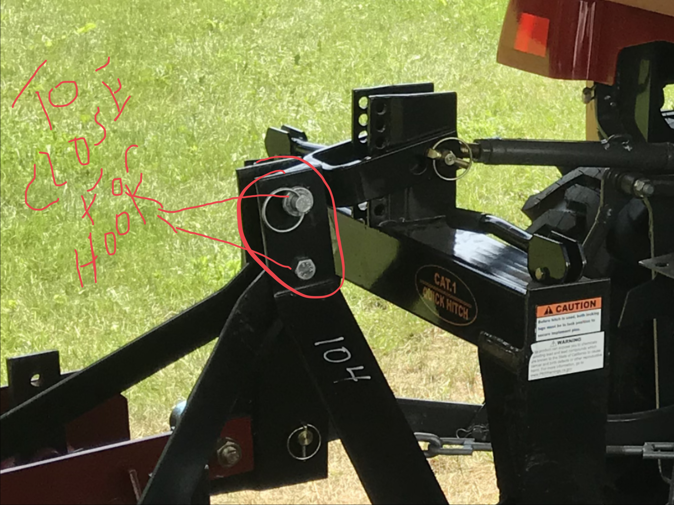

Very nice. Are you not able to use the hook on the quick attach for the upper point or is it a preference not to? I am still on the fence on getting a quick hitch.

The hook does not work with the Walco box or back blade I have, not enough room for the hook to catch the pin, if the bolt holding the 4 straps together under the top pin was a inch lower the hook would work fine. If I had a hydraulic top link I could probably angle the hook enough to grab, the adapter works fine for now.

I really thought of adding about three inches of flat iron to the top of each implement then re drilling the top link hole and then the hook would work fine but was kinda keeping that to myself until I did it, I need to get a friend of mine to do the welding due to my pacemaker, the extended iron would consist of a 3.5 inch piece of flat iron and a 3 inch piece on both sides to make it strong, something like this.

You do realize you would hook the top hook on the bolt, and not the top pin.
