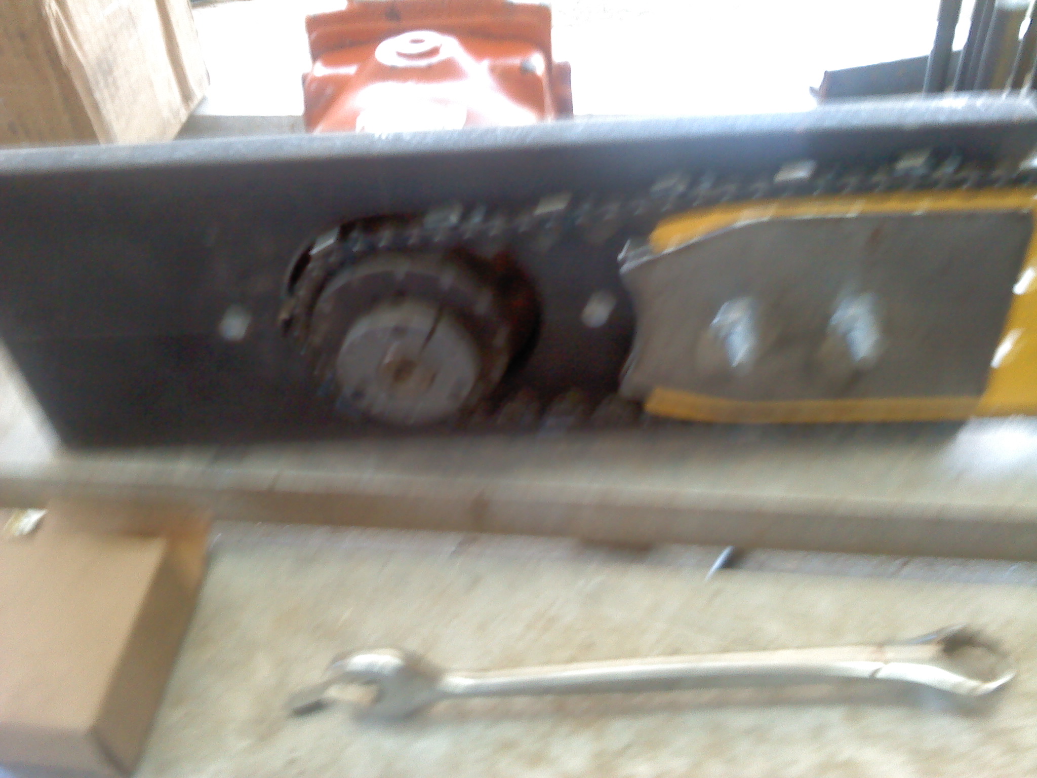

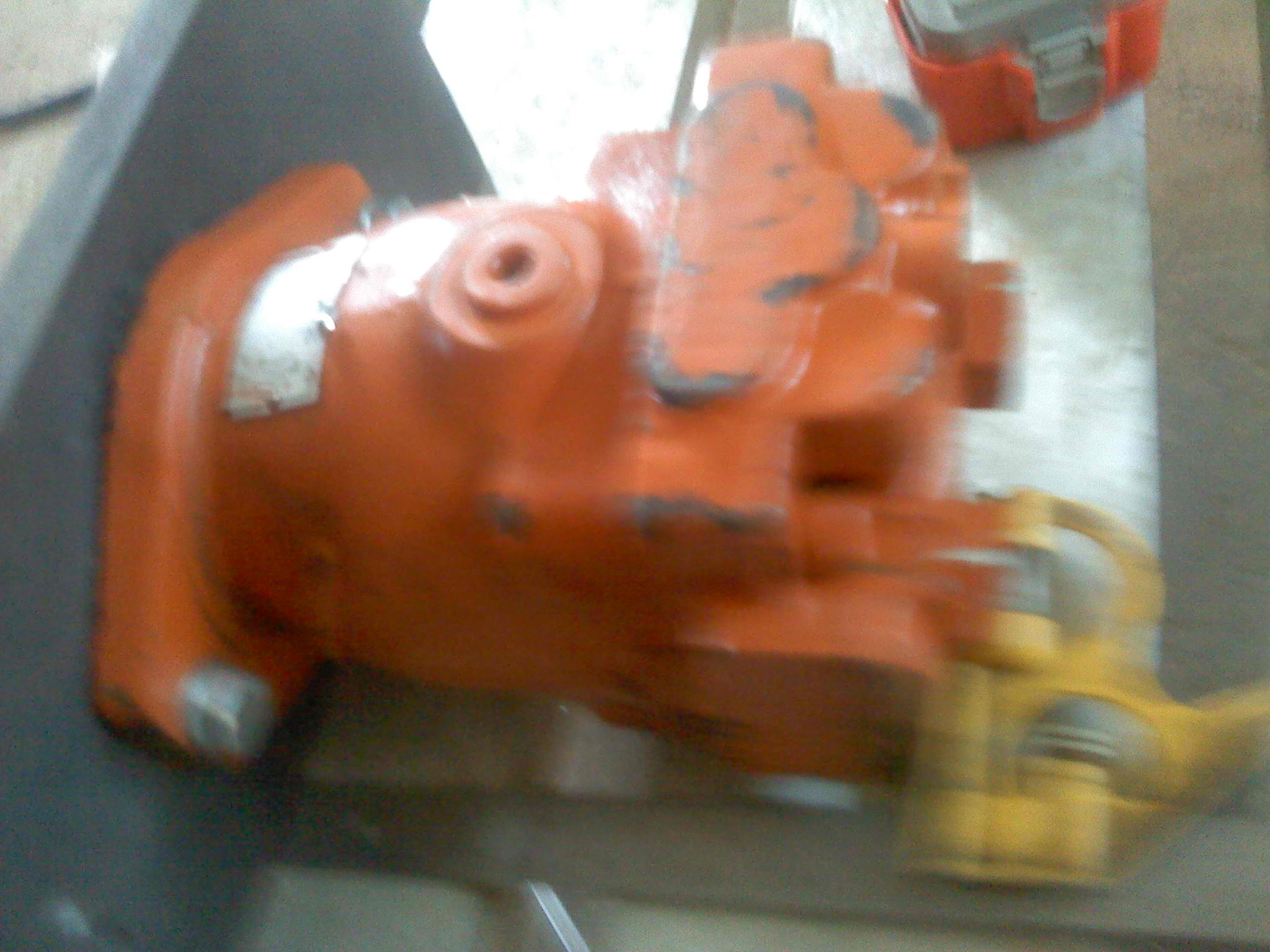

/ Firewood processor help #96
0310131322 (1).jpg My hydraulic saw. Using a 1.3 cuin axial piston motor/ with case drain and bearings on shaft, and 13 tooth sprocket and .404 chain.0315131401.jpg 30gpm@ 5331 rpm (motor rated for 4600rpm) chain speed of 4660ftmin at 17.25ftlbs torque and 17.5hp@1000psi

#98
View attachment 433487 My hydraulic saw. Using a 1.3 cuin axial piston motor/ with case drain and bearings on shaft, and 13 tooth sprocket and .404 chain.View attachment 433491 30gpm@ 5331 rpm (motor rated for 4600rpm) chain speed of 4660ftmin at 17.25ftlbs torque and 17.5hp@1000psi
Don´t you have some video of that configuration working? (in what type of wood, and at what chain deep gauges settings?)
