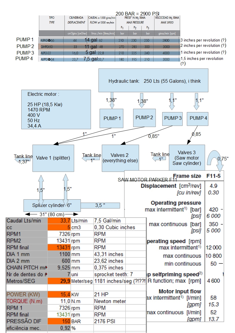

Hi,
"Originally Posted by jonix"
"Sorry to use your post to try to solve my problem , but I'm desperately in need of help. I am in the final phase of a firewood processor ( 3D images ) , and the first tests did not go well. The two 50 lts/min (13.2GPM) and 66 lts/min (17.4 GPM) gear pumps exceed 5000 PSI (!!!!) and still not achieve the 10 cm (3.9" that should develop 30.4 tons @ 5000 PSI) (how do you get this result?!) diameter piston to split eucalyptus with a 400 mm (15.75") diameter into my 8 edges knife ..can anyone help me with this? (a picture of the splitter cylinder and wedge would be helpful) (in the end i post a youtube link to a walk around video, and a jpg with the hydraulic circuit, the only thing i donエt know is the valve types that iエve got there)
And why the F11-005 PARKER (.305 CI / revolution) motor with 34 Lts/min (8.98 GPM) dedicated pump can not get a decent cut at 150 bar (2,175 PSI)? ( a 3/8 pitch chain with a 7 teeth sprocket and a set of pulleys to double speed).. (Saw motor should run at 7200 RPM with the given information developing 100 in/lb of torque and 5.7 HP. Chain should run at 3150 ft/min)
The system has a 18 KW (24 Hp) electric three phase motor with 4 pumps (2 for splitting, 1 for the saw and saw piston, and 1 for log conveyor, log feeder, clamp, log lenght stopper, etc...) what is wrong with this? something has to be wrong... (Need information about how the two pumps are used for splitting)
I can get you much more information and a video of what is happen (all the machine is near to break and still not splitting the wood!!!) if you need/want to see that...
thanks in advance..and i hope anyone helps me, because here in portugal the season is about to begin, and i have no firewood drying..."
I made notes in red. Changed units for those of us not used to metric (thanks, my drawing as already almost converted units). I would say that we really need information about how the two pumps are used to split. We need pictures of the wedge to see how the log will spread out as it is split. Is the wood green or is it dried out? I read that eucalyptus is more difficult to split when dry. (Yes, dry eucaliptus is much more difficult to split, even so i think it should be splitting easly...)
Off hand I would think the splitter would work at 30 tons but (i think i was tell that at 3000 psi it would be working with 40 Tons) it all might depend on the wedge design (yes, the wedge is not totally staggered [thanks SpringHollow], you can see it in the video). Also if there is anything binding (what is binding? canエt find a translated word for portuguese) in the splitter travel (i donエt think so, it is only bending when the logs stop because is not being splitted).
The saw seems a bit slow to me (I made an excel sheet about this calculations, but our results arenエt the same - i can say i trust more in yours :). You have decent torque but I would think you'd want your chain speed to be around 5000 ft/min. It could be as simple as changing to an 11 tooth sprocket if one is available (yes, iエm already waiting for one with 12 tooth).
My previous comments still stand, I would gather additional information and start a new thread for this in the hydraulics or build it yourself section. Feel free to post a link to it here if you wish (thanks again, i would do that).
Youtube video walk around (sorry, i wasnエt able to film the processor at working, i will try to do it soon)
https://www.youtube.com/watch?v=qFU2Qhwh5Ak
thanks again for your help, and hope i could find what is wrong with it..

6 in bore cyl at 3000 psi should have a cyl push force of 84,823 lbs, or 42 tons.
You shoulds have no trouble splitting anything
Install a hyd pressure gauge in the log splitter IN port and tell me the pressure you see when stalling.
Did you ever check or set the log splitter relief?
If you run all pumps at the same time, you would need 91 HP .
25 HP can pump about 12.85 GPM at 3000 psi
With different loads on the pumps, it will be hard to compute the actual HP.
You might get by with running one or two functions at the same time.
You say that your pumps have 7.5 cu in total displacement, and if your motor turns at 1470 rpm it would pump 47.73 GPM's
However to pump 47.73 GPM's, it would need about 91 HP.
Your GPM figures total up to 37.5 GPM, but your pump displacement total up to 7.5 cu in. Which is correct.

You have two pumps driving the splitting cylinder with different maximum pressures and flows? Could be one pump fights the other pump because they have different flow rates and pressures? If you really have two pumps feeding the splitter, I would just run it with one initially. That would only affect the cycle time.
Ken
/ Firewood processor help #6
Ken
Yes, I agree with this. If those two pumps doesn't have check valves, then it might be the problem.

The two 50 lts/min (13.2GPM) and 66 lts/min (17.4 GPM) gear pumps exceed 5000 PSI (!!!!) and still not achieve the 10 cm diameter piston (3.9" that should develop 30.4 tons @ 5000 PSI) (how do you get this result?!)
Jonix, I was under the impression that the splitter piston diameter was 10 CM which would be 3.94" It appears to be much larger than that from the video. So you may be achieving 40 tons at 3000 PSI
My calculations here were flat out wrong. I must have forgotten to change a parameter in my spreadsheet or my google spreadsheet did not update calculations after I made changes. Sorry.
5cc (.305 ci) displacement at 34 Lts/min (8.98 GPM) should yield 6800 RPM at the motor. So with 150 bar (2175 PSI) at the motor you would give you 11.9 N/m (105 in/lb) of torque and 11.4 HP
You say you have a set of pulleys to double the speed of the motor. That would give you 13600 RPM but cut the torque and power in half. Disregard the sprocket recommendations. I obviously should have waited to reply when I was more awake...
At 13600 RPM with a 7 tooth sprocket with 3/8" chain would travel 5950 ft/min which is reasonable.
The data you have in your attached document matches up pretty well to this. Differences due to rounding.
One other question about your two pumps. Did the person that specked out the pumps intend on having one higher pressure, lower flow pump to extend the cylinder and then another higher volume lower pressure pump to retract the cylinder quickly?

Your F-11 saw needs about 15 GPM minimum to run and if it can develop 6000 psi, you need about 29 HP just to run the saw.
If the log splitter valve is limited to about 3000 psi, due to the relief valve, then you only need about 15 HP
The saw will run at any GPM, but the speed of the saw motor is relative to the GPM.
You can increase the speed of the saw, but the torque will decrease.
Apparently, you are not using a standard log splitting valve with auto return.
I see all solenoid valves, but where is the relief valve?
Early on you said you did not know what that was, but it is of great importance as it will protect the pump from excessive pressure.
Every hyd system should have a relief valve, and each circuit should have one. .
Your two p mps at 24.2 GPM and 3000 psi, would require about 47HP.
I think someone messed up on total HP required.
Your cyl and valves have a psi rating, what is it?
The cyl will take what ever GPM is fed into it and develop the pressure based on the load.
Motor stalling will be based on the total load on the pump, which is driven by the electric motor.

Plug in some numbers and there you go.
Whatever you put together, if the hyd are not working under a load, you do not need much HP.
You will have max flow based on the pumps max rpm.
As soon as the hyd sees a load, pressure develops.
The HP required to support that load, pressure, etv, will be met and things work OK to a point.
If you add more load than the system has HP, you are at your max, and after that, you may stall the system.
Did that engineer do all the math for you or is that your doings, and did you just ordered the parts based on his recommendation.
I say again, you can use some of what you have, but can not use all pumps to full advantage at the same time.
What you try to do in a hyd system is to design for min operation, and then add some extra for true operation. Design for maximum potential. .
If you run out of HP, the system will slow down, quit or burn up the motor.
It would be analogous to you pushing a bolder on level ground and then you try and push same bolder up a hill. Need more power.
Had you put your design on TBN before, someone could have saved you a lot of headaches.
However one has to know the true details, such as HP, cu in, size, etc.

I think i understand now..as the system develops pressure, at the design flow rate (25GPM), it will be needed much more HP..since i only have 25HP, the electric motor wants to shut down.. i should have, for example, a 20GPM pump with low pressure, and a switch for a 5GPM pump rated with high pressure, to do get the job done..think this is the 2 stage logsplitter pump that ptsg talk about..:thumbsup:
..all the math was done by the engineer..we only said the purpose of each machine moving part, and if it will be moved by a hyd motor or a cylinder..
..well..i think i solve my problem by getting one of those 2 stage pumps..but they already doing a bigger cylinder for the splitting part..at the shop there is not much patience to wait and do things well..

here are some formula based on the metric system.
For reference:
The saw pump of 34 lpm @ 150 Bar requires 10 kW power at 85% efficient
Splitter pumps:
50 lpm @ 250 Bar requires 24.5 kW power at 85% efficient (I used 250 bar since a lot of gear pumps are rated to 250 Bar)
this does not take into consideration any other loads on the motor of which there will be.

This is the largest 2 stage pump that Surplus sells, at 28 GPM. Min of 16 HP engine
28 GPM DYNAMIC 2-STAGE PUMP
You need 13.6 HP to pump 7 GPM at 3000 psi
------------------------------28 GPM at 800 psi
How are you going to power a two stage pump with pumps piggybacked to each other?
You can adjust the crossover psi between 400 and 900 psi/
/ Firewood processor help #20
So you are saying that with two independent pumps, one with high GPM and low pressure and other with low GPM and high pressure, with the proper valve to swap between pumps, can´t do the same as a 2 stage pump? Because it is probably what jonix has in his processor.
The problem that jonix is experiencing must be the relief valves and unloading pressure not set right, it probably cause the system to produce excessive pressure when it shouldn't.
For what I can see, this processor is made to work automatic, that's why they use solenoid valves and not a log splitter valve.
