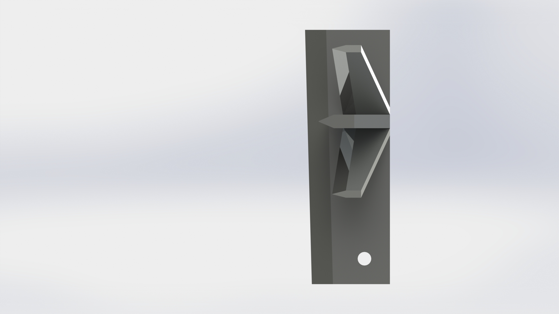

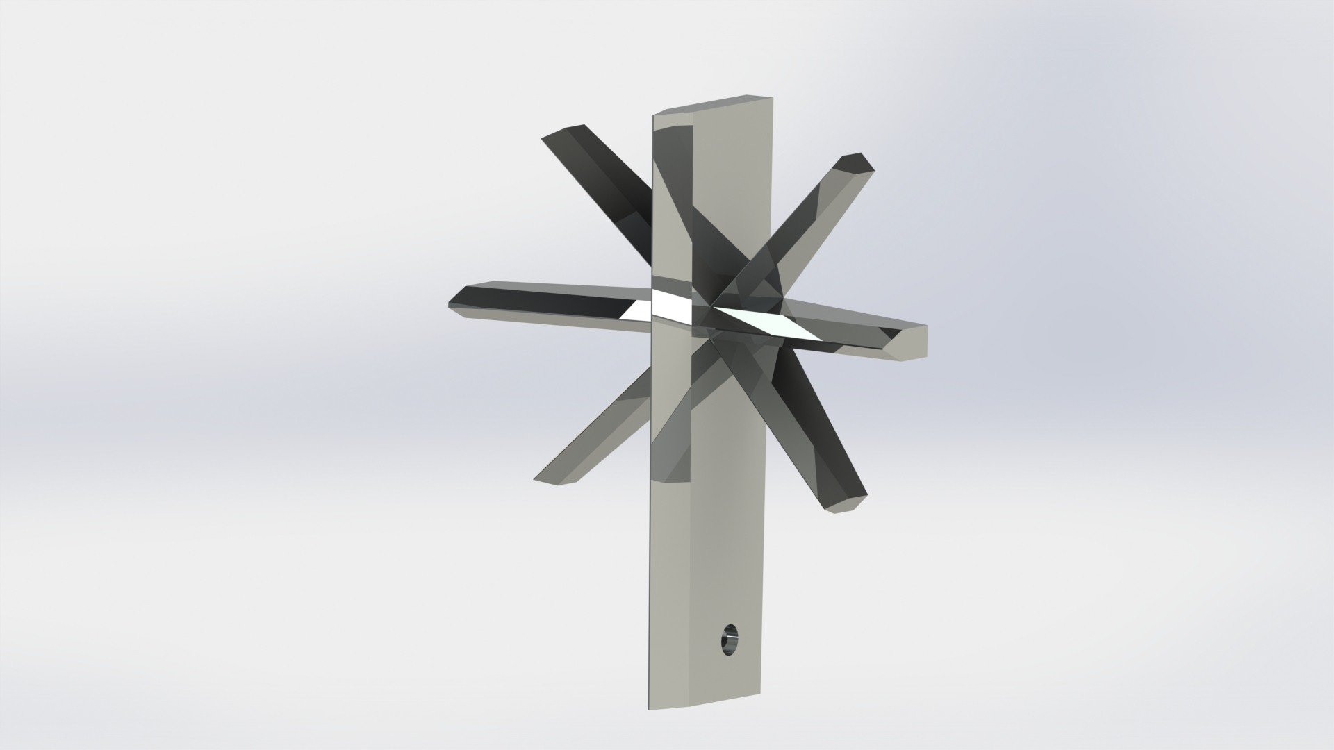

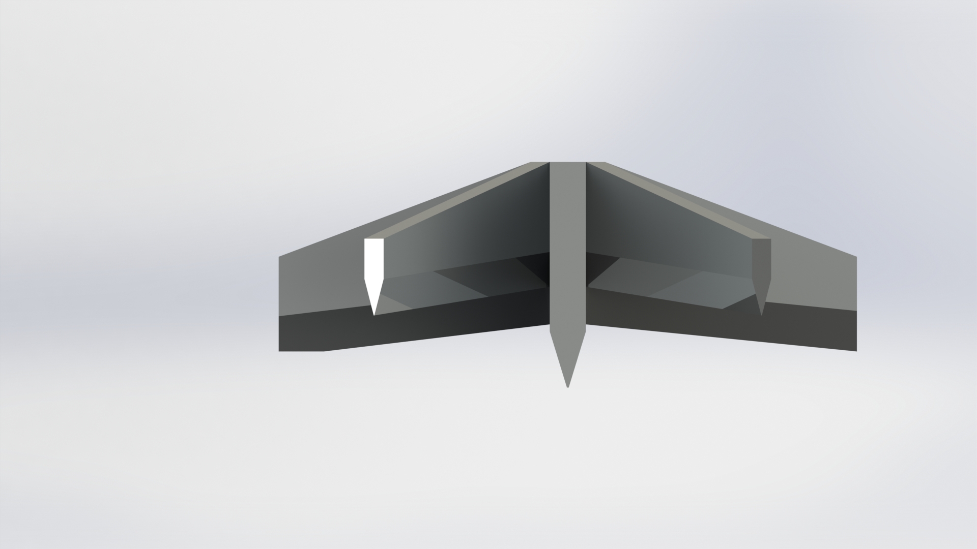

The max psi of the cylinder is unknown..it is shop made! :) think they know what they are doing..
There are two screws to set the relief pressure, in the valve..since my hydraulic gauge is for all the valve, and not for one pump at the time, i have to figure out how i´m going to check the pump pressures, individually..may i have to use one of those gauges that you have shown..

Do you think this is a good wedge design? View attachment 432242View attachment 432243View attachment 432244
There are two screws to set the relief pressure, in the valve..since my hydraulic gauge is for all the valve, and not for one pump at the time, i have to figure out how iエm going to check the pump pressures, individually..may i have to use one of those gauges that you have shown..

Your wedge design looks OK.
You definitely need a relief valve in the circuit going to the cyl.
