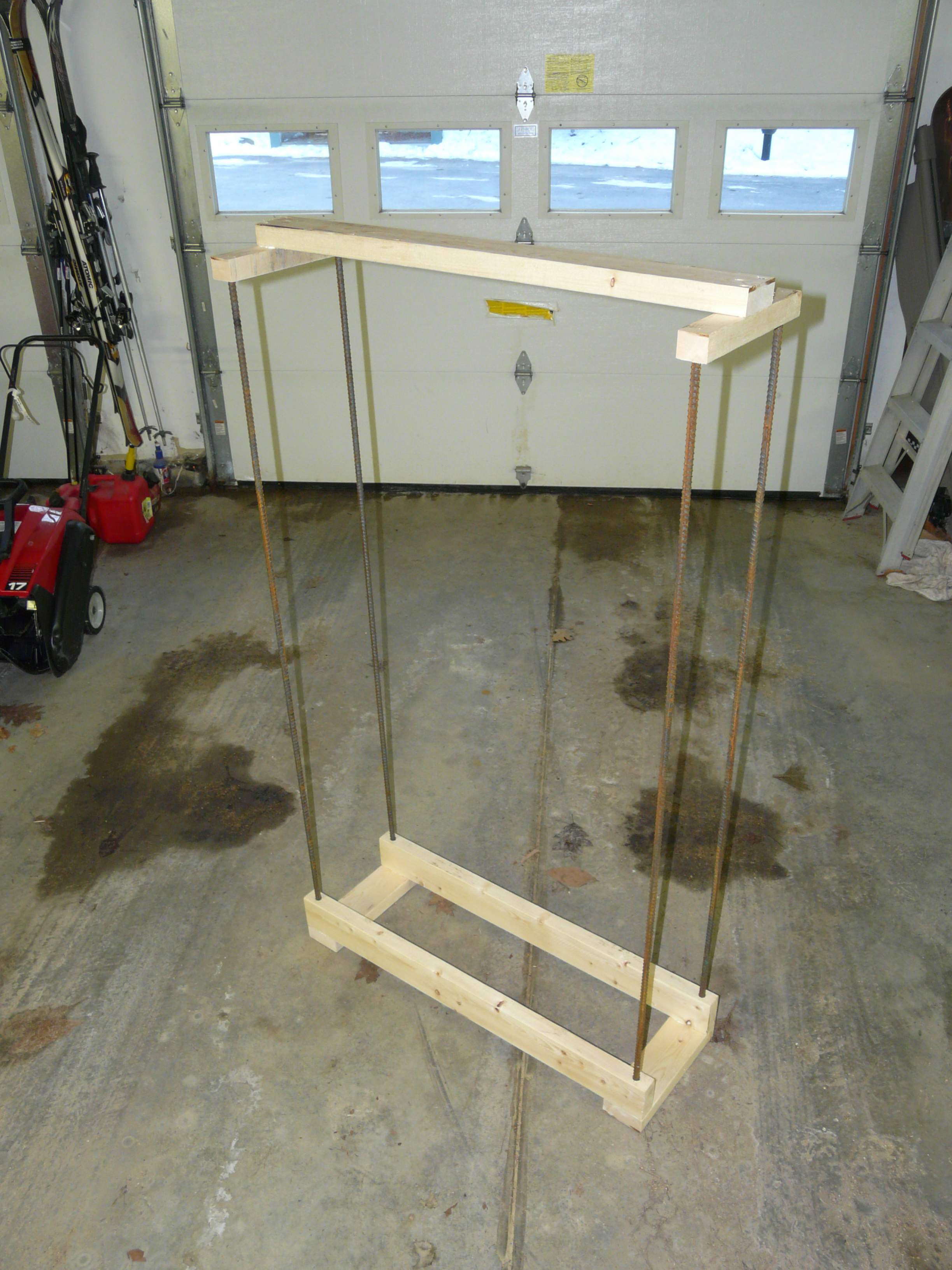

I used the fork lift log carrier again today and am amazed how much it holds. I would guess about 4 times as much as the 4 in 1 bucket or the bare forklift. Maybe still not a lot, but when I restocked the wood on my car port it took less that one load to finish. The same size load lasted 4 days in my garage

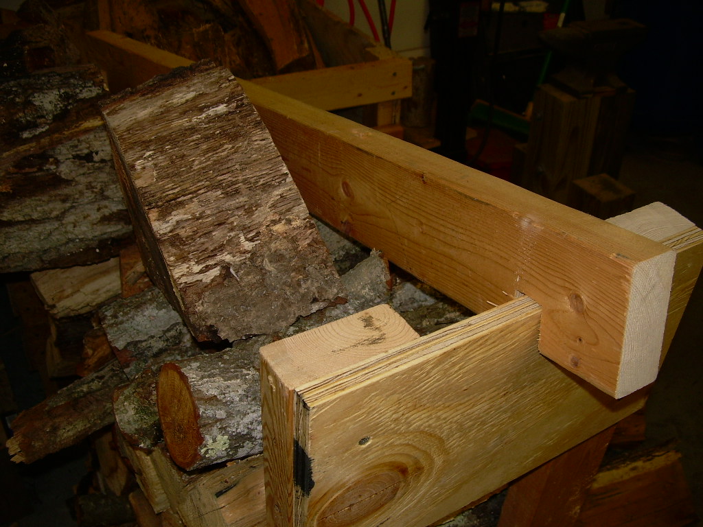

Anyway I took some pictures of an add on. I cut a 2 x 4 to go across the top to tie the front and back together. This just slips on and off. After doing this I wish I had made the thing taller. Another couple of feet would still be strong enough and would obviously hold a lot more wood. I may screw some add on when I get a chance.
This is one of those things that I feel strongly will make my wood handling a lot easier. It goes on and off the forks easily, simple to build, cheap, stores in a small area and now I can disconnect the forks from the PT without unloading it. Being narrow it will maneuver easily through the woods.
Very practical, Bob. Nice job! :) We don't have an attached garage or I'd be tempted to copy your design.

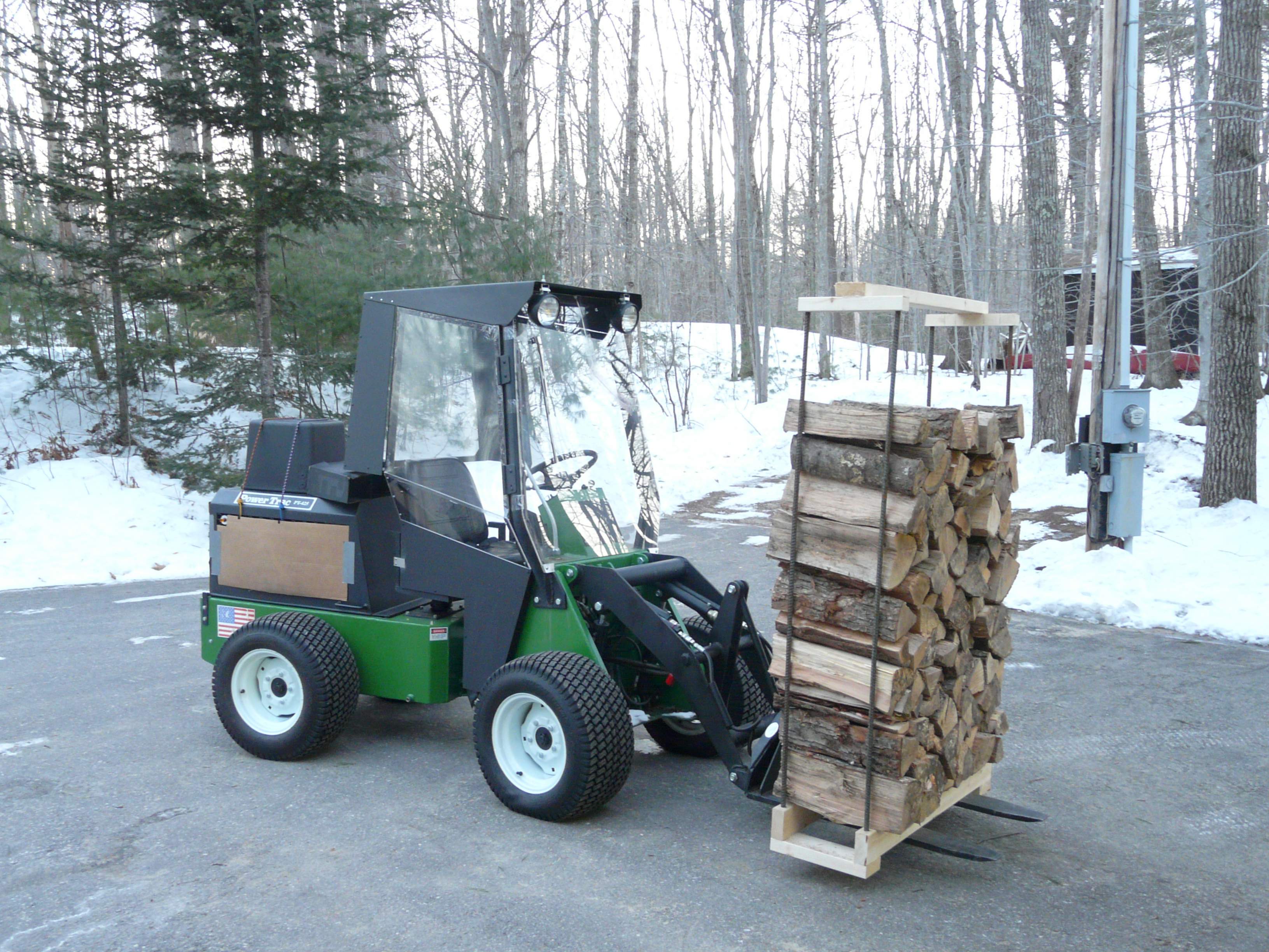

After seeing what Bob did, it gave me an idea for the stand alone wood rack pictured below. I have included the drawing as well. I felt I handled the firewood too many times. Now I can load the rack were the wood is stacked outside and move it directly into the garage with the forks, eliminating an extra handling. I paid for all the materials on this 1st rack - $15, but have enough 2x4s round to make 3 more racks and only have to spend another $15 on rebar. Thanks for the inspiration Bob!
