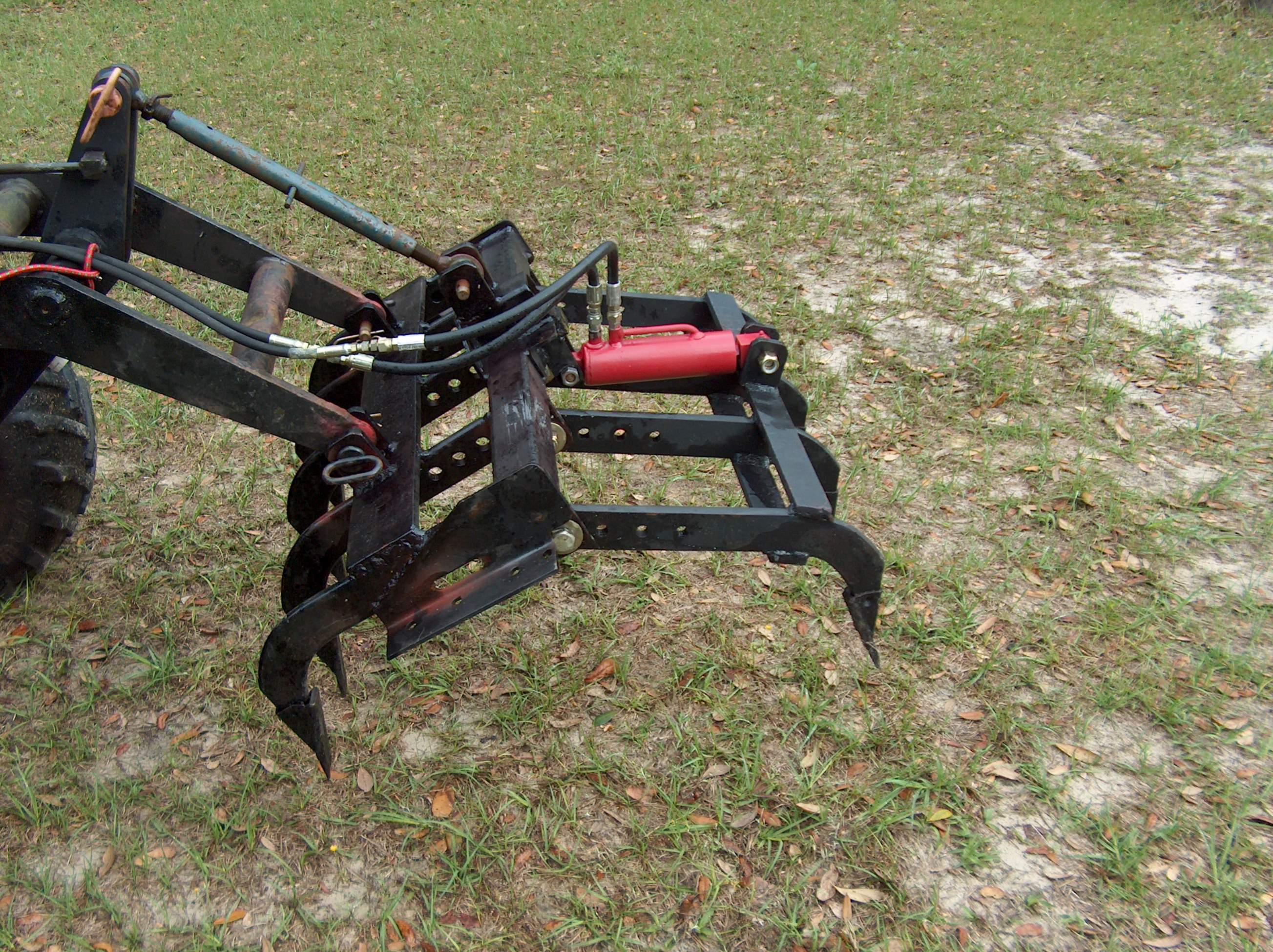

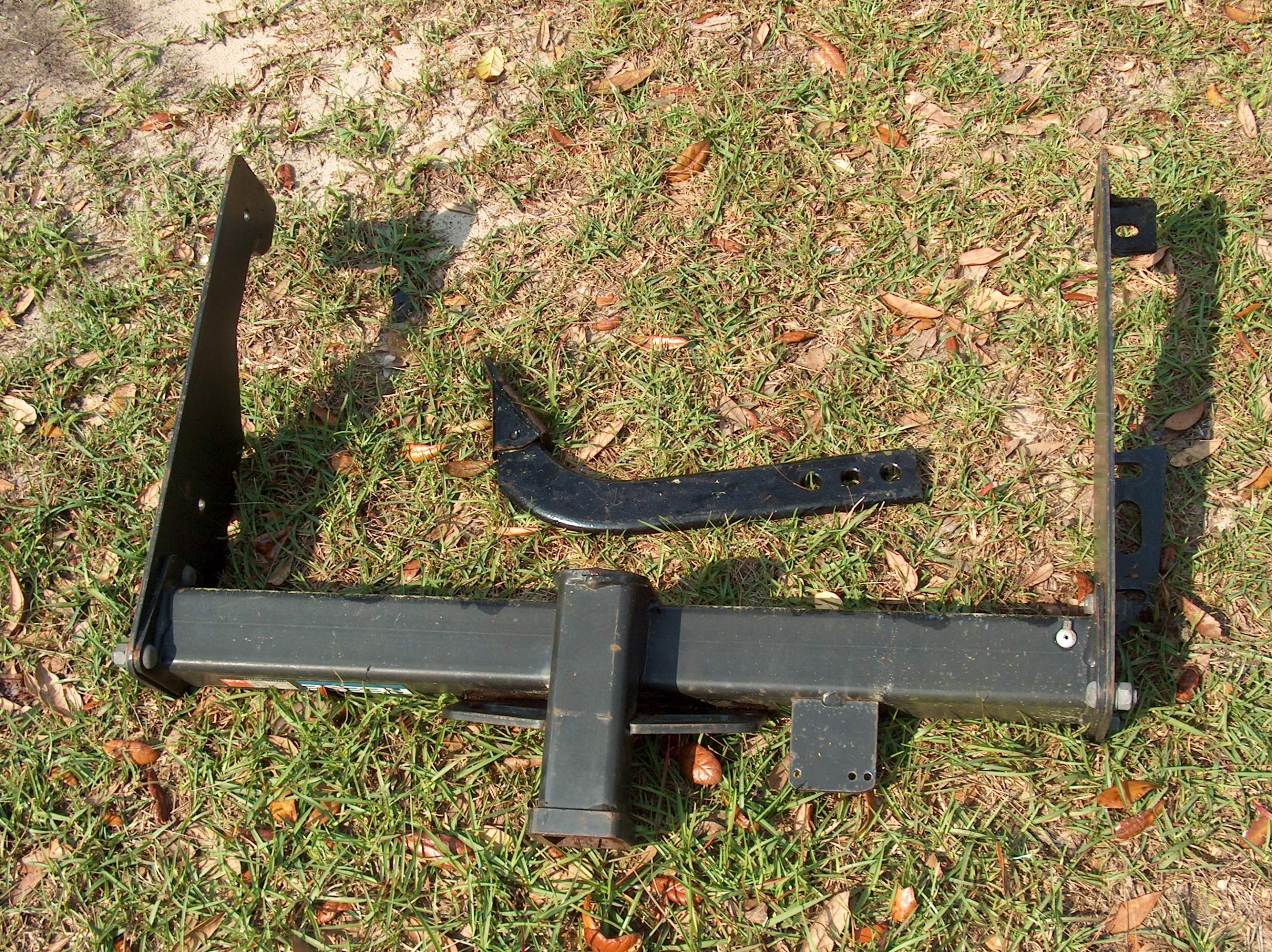

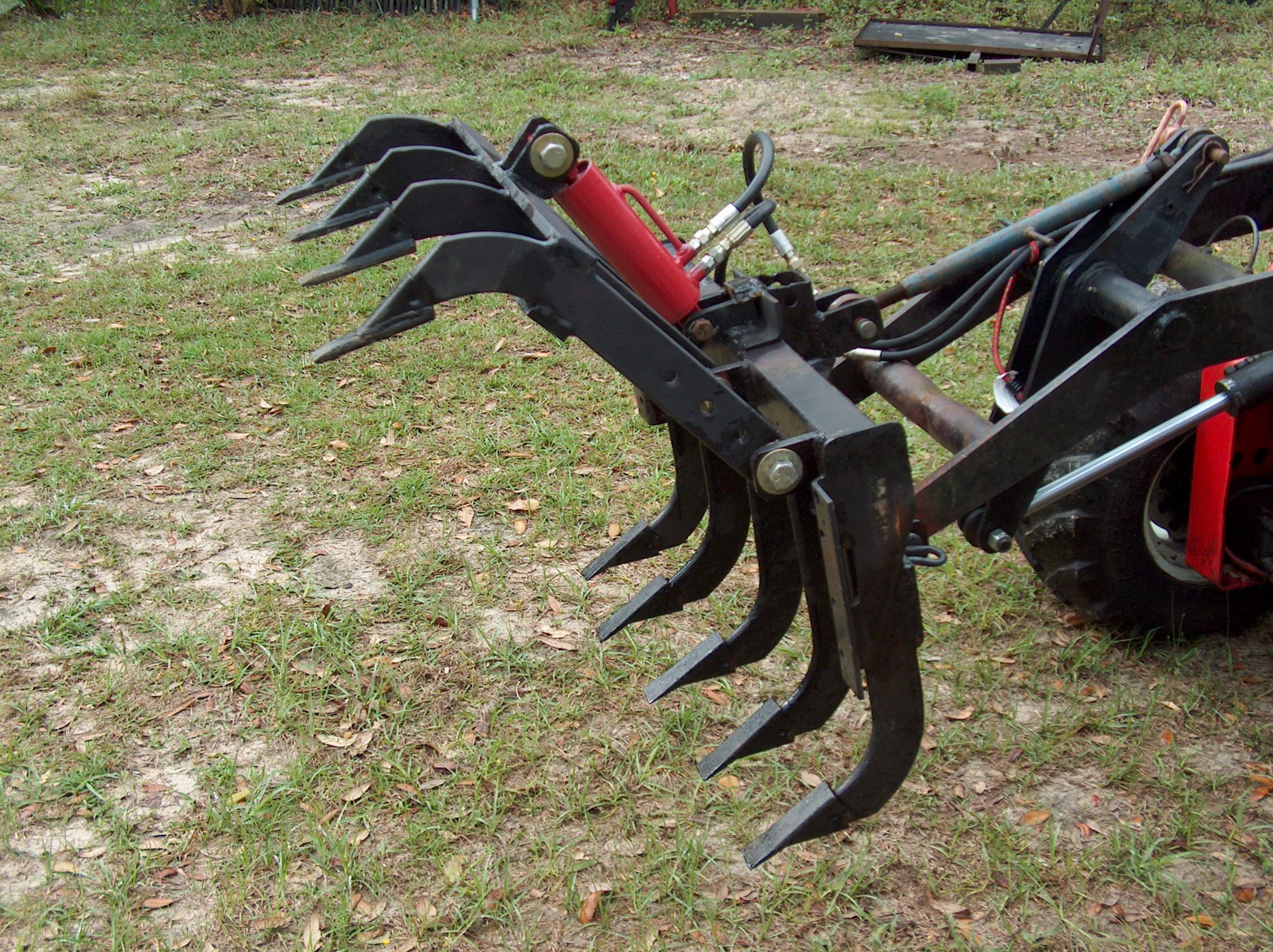

Why not just make one out of box bld ripper shanks. They already have holes ready to bolt up to some brackets, and a hyd cylinder, plus hoses. If you have a welder, you could build this in a week end. Below is the root/rake grapple I built. The last picture is what I started with, a truck hitch.

I wish I had welding knowledge/tools and it would be a priority!! Would love to be able to maneuver logs around like that!
   / Firewood Gathering With A Power Trac #78

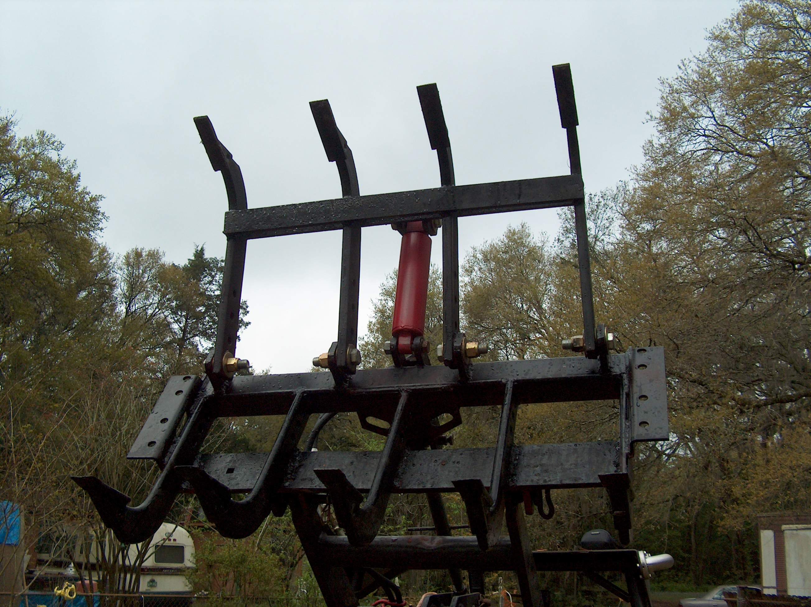

very nice J_J!
I was wondering if you thought about mounting it at a different angle? I looks like you can easily open up over top of a pile or what have you.
   / Firewood Gathering With A Power Trac #79
You mean like this.
   / Firewood Gathering With A Power Trac #80
That is so cool. I also wish I could weld, I can tack weld with my cheap Harbor freight welder. But of all things you made it out of a hitch. What an imagination. I may have to try something like that. I wonder if a scrap yard would sell me a cheap hitch. Good job.
